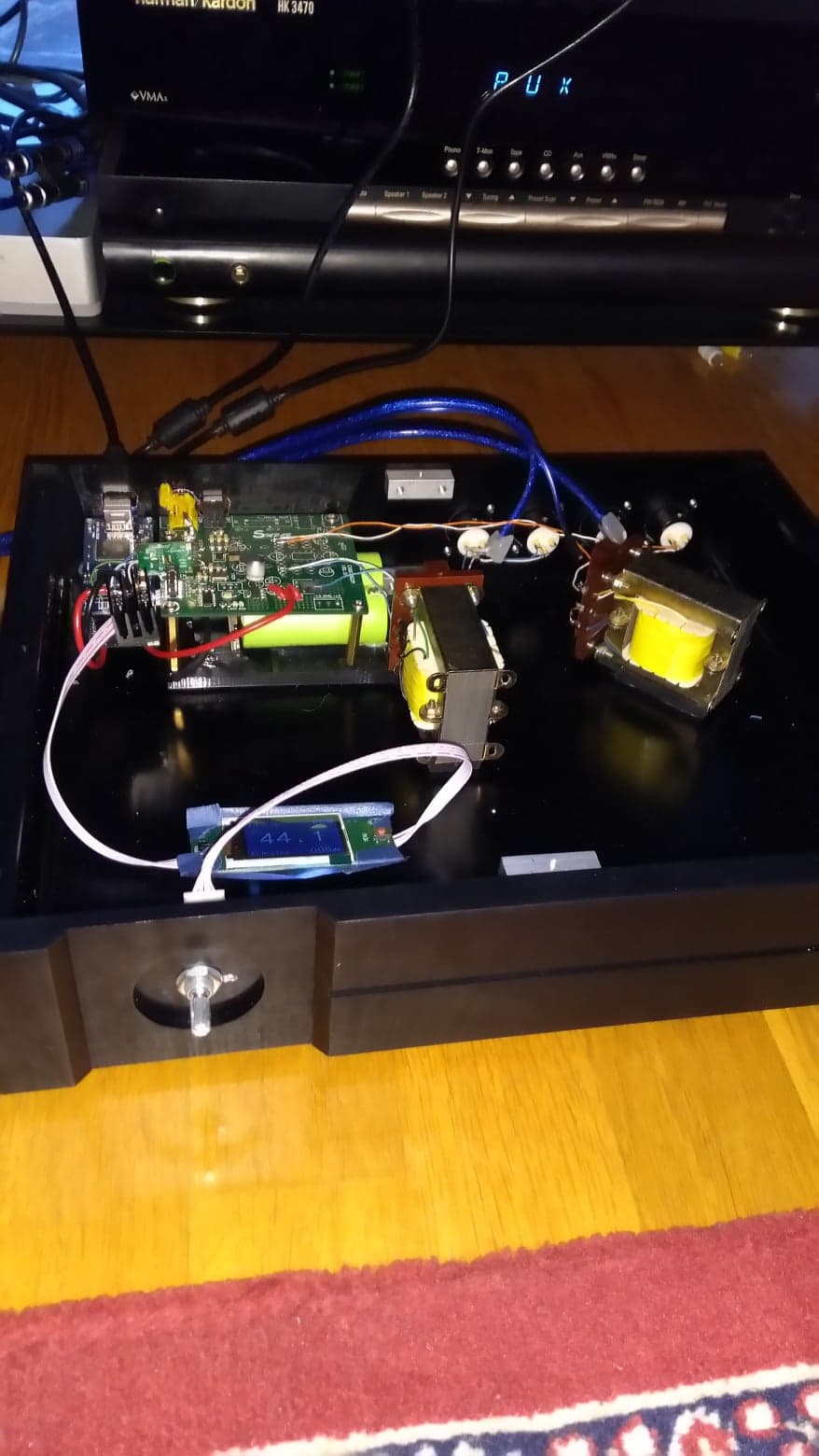

In the attached picture you can see the AVCC driven with LiFe batteries. One LT3042 is trickle charging a low impedance LiFe battery capable of 35A.. So a dual mono psu, and stereo separation is really good. At the moment there is a 9 ohm resistor between the regulator and the battery, and the battery is connected directly with a few mm of copper to the pcb. Avcc is bypassed by the smd film capacitor very close to the chip(the two flat silver caps.) The dac plays well at this point but the test output transformers is not linear, and its too much undertones. Its very musical but not high end.

As you see in the attached picture...
What picture are we talking about?
Doh, I forgot to the attach the picture. I edited the post now. Too bad the picture quality got lost somewhere. Which filter do you think sounds best when using the upsampler? The filter L_slow sounds the most natural on decaying cymbals through the transformers at the moment.
Best to crop and reduce JPG quality yourself to keep attached pictures a little below 1MB in size. That way the forum software won't do it for you in a way you can't control.

Also, hard to tell what you are doing with some of the wiring and components shown in the picture. Do you have a schematic or maybe a block diagram to help make sense of it? Hand drawn would be fine, if legible

The AVCC right is driven with a battery and regulator in parallel. The Regulator has a resistor to limit the charging current if the battery becomes very discharged. Excact same for AVCC left. This was quickly put together so it might have some unforseen drawbacks, but it seems good enough for going further to the IV stage. Thanks for the audio filter info, there is a treble problem but I think is has to do with the transformers. Does the filter change the phase at the top end? I'm thinking the additive phase change from the transformers + filter might cause phase change in the signal.
