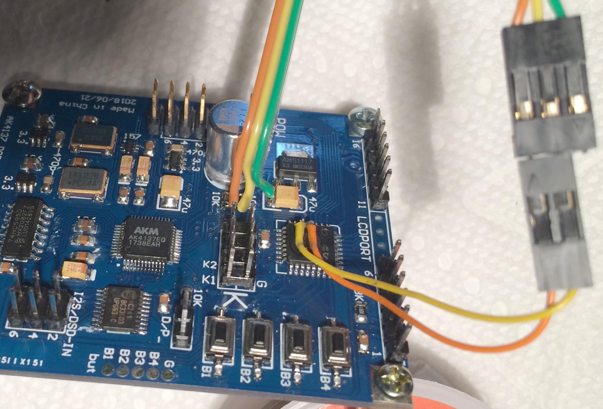

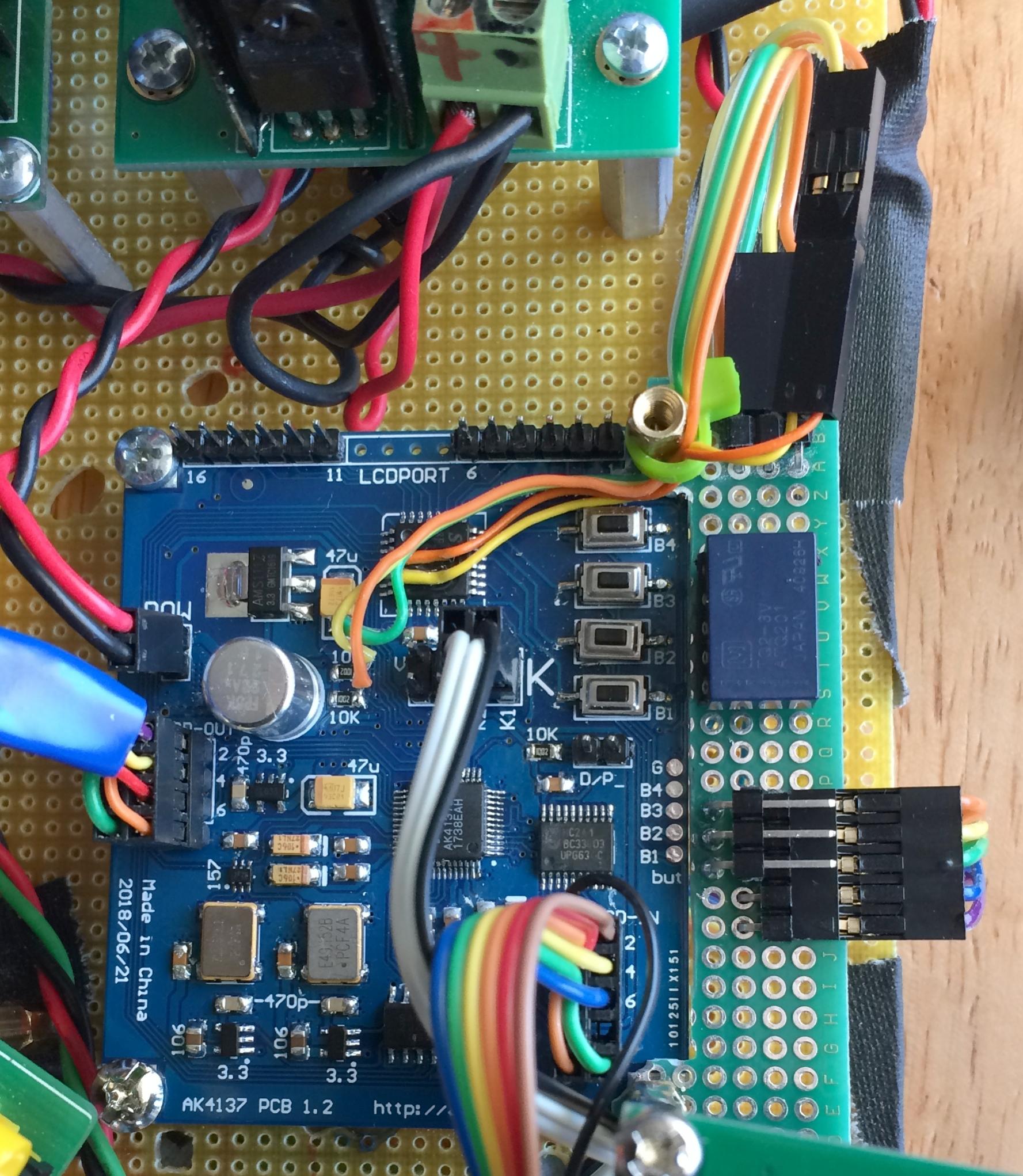

Hi Mark,
I've got the blue SMP with the smaller OLED display.
Now that makes sense, I'm getting all PCM frequencies being recognised but no DSD, I was reading the I2SoverUSB manual and using the datasheet for the AK4137 noticed that F0-F3 (F1 & F2 hold the DSD 64/128/256 bits) 'sort of match' the A0-A3.
Time to solder on the H1 header and connect some more wires.
Thanks again Mark!
The SMP AK4137 boards use the Amanero pinout pattern for I2S input. The pinout is described in the document at: https://www.amanero.com/drivers/combo384-D.pdf

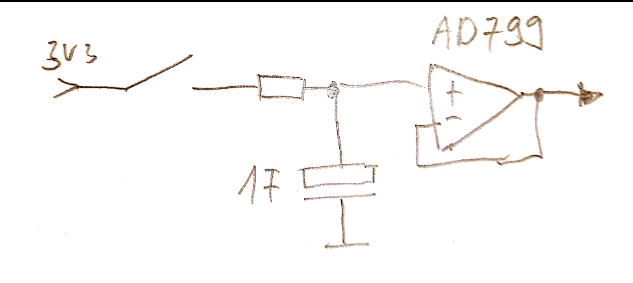

What do you guys think of a supercap as reference for an ad797 AVCC supply.
let's say 1F, charged at startup to 3v3 via a small resistor and the having the supply switched off after a few seconds by a relay. Shouldn't this be the most quiet voltage reference for the input of the ad797?
...Shouldn't this be the most quiet voltage reference for the input of the ad797?
I wouldn't imagine so, since most super caps have ESR and ESL as frequency goes up. They may need bypassing at some audio frequencies. Besides, LT3042 or LT6655 are way quiet enough. If you want you could put a super cap on their input power supply, but they may regulate better with more than 5v input. 7v or 8v input to the reference might be better.
These dacs are hard enough to get working their best, and they seem to perform best with separate regulators for things that need it, with each regulator tailored to best serve the needs of the load. Layout matters a lot too. Ground planes and short connections for sensitive signals are good in most cases. A lot of care should be put into those types of things.
The only sensitive signals that are especially tricky are the dac output connections to the I/V inputs and the ground plane continuity between dac chip and I/V opamps. Reason dac outputs are tricky is that they have some low level RF/HF and tend to cause small but unpleasant distortion in the I/V opamps. I used twisted wires running against the ground plane for a few inches for each dac channel's +- outputs before going into the I/V opamps (which was described earlier in this thread). Other people are continuing to make progress in that area but their solutions are proprietary so far as I know.
Anyway, the point is that super caps are not needed to get the best out of the dac chip, but they seem to help in the case of some implementations. There are many other things that always matter, so I would suggest to go for those first and after the dac is running the best it can using established methods, then that might be an appropriate time to experiment around with super caps if they can improve sound quality. Unfortunately, many people confuse different for better when listening. Listen comparisons should be performed with/without mods several times and over different days to make sure a change is really a change for the better. If the experimenter knows other people that are skilled at listening to very small details for better sound quality, it can be helpful in some cases to get their opinions where listening is done first before they know anything about what the mod involves (don't want them to be biased by excitement over some mod they think is good before listening).

I think you might have misunderstood what I mean, so here's a pic to hopefully clarify things...
Regarding ESL and ESR in my depicted use case, would these really matter as the supercap only supplies dc to the very high impedance positive input of the opamp?
Nevertheless you're probably right that the LT3042 is low noise enough, this was just a thought experiment. Still it was interesting enough to make me ask here
And I'm still interested in your opinion... Btw. If used in a real circuit I'd probably add a yeat another 10k/100n RC lowpass between the supercap and the ad797 with the 100n cap very close to the ad797...

I've been playing and I still can't get a DSD lock. I get a momentary flash (sometimes 0.5 sec) and a slight burst of music then the lock drops.
I'm using the mute and dsd pins on the H1 and have been trying to force DSD64 (using A2 connected to F1).
Any thoughts?
Depending on the value of the super and the value of the resistor it could take a long time for the cap to charge up. An estimate could be make by multiplying the values (in units of ohms and farads) to get the RC time constant. Time to charge up would around 3 - 5 times that.
In addition, due to unspecified levels of ESR/ESL/Dielectric-Absorption verses frequency, a super cap may be ineffective at filtering high frequencies that could adversely affect the sound of your audio. You could try to put a film cap or something in parallel with the supercap. The risk RF/HF on your 3.3v input voltage would depend on things like if it is a dedicated reference or a 3.3v bus shared by other devices. Layout of wiring could also affect RF/HF noise pickup.
On the other hand, putting a supercap there probably wouldn't hurt anything, and there is always some chance it could do some good. You could put a jumper or switch to disconnect the super cap and or to switch to a conventional 10k-ohm/10uf electrolytic filter as recommended by ESS, so as to allow a way to perform listening comparison tests.
As far as what works well from a schematic point of view, the opamp AVCC circuit recommended in post #3003 of this thread works well.
Maybe I should say that it is possible to use supercaps to improve measurements, but the resulting sound quality is not always better, although it can be.
If you want to make design choices you have to decide how to evaluate what choice you think is best. Just doing some mod and not checking to see if measurements or careful listening tests change in the desired direction tends to lead to a mismash of good and band changes, often mostly bad the more that standard proven methods are deviated from.
Many people add super caps to circuits and say they find it takes a few days to a few weeks for sound quality to burn in. Until then they often say the sound is worse. Only way to tell if the cap is burning in or if the listener's ears/brain-processing is burning in is to wait for the burn in time to elapse, the perform A/B tests with/without the mod to make sure of what really happened.
Any thoughts?
The DSD_ON from the USB board is what tells the AK4137 board MCU to configure the board for DSD input.
Standard DSD64 uses an approximately 2.8MHz clock frequency, roughly the same as the bit-clock frequency for 44.1kHz PCM. I2SoverUSB sets all A1-A3 to zero for that sample rate (see table at bottom of page 11 in the USB board manual). In addition, there an un-isolated signal on H1 called DSD_PCM. There is also an isolated version of that signal on H3 called DSD_PCM_iso. Both of those are the same signal as DSD_ON.
Moving along to the AK4137 board, it looks like Amanero sets F0 to 1 for 44.1kHz. Presumably, it would the same for DSD64. Not sure what the standard for XMOS USB boards is, but may be more like what I2SoverUSB uses. One possibility would be to see if the AK4137 board you have is expecting Amanero or XMOS format signals. If you hold down the selection button on the AK4137 board as it is powered on, it will enter a special configuration mode. In that mode you may set it to Amanero or XMOS. It may be that one or the other setting works better with your hardware combination.
Hopefully some of the above will be helpful. If not, digging deeper into the problem is possible
Moving along to the AK4137 board, it looks like Amanero sets F0 to 1 for 44.1kHz. Presumably, it would the same for DSD64. Not sure what the standard for XMOS USB boards is, but may be more like what I2SoverUSB uses. One possibility would be to see if the AK4137 board you have is expecting Amanero or XMOS format signals. If you hold down the selection button on the AK4137 as it is powered on, it will enter a special configuration mode. In that mode you may set it to Amanero or XMOS. It may be that one or the other setting works better with your hardware combination.

Mark, I'm using this version the I2SoverUSB http://jlsounds.com/uploads/I2SoverUSB v.III.pdf
Definitely agree with you on the DSD source material, just needed to ensure I could use (prove) DSD if needed. 99.99999% of my source material is PCM so I'm not too concerned that if the worst comes to the worst and I can't use DSD. Having Roon just makes it very easy, perhaps far too easy to upsample to anything!!!!
Did you find any option to bypass SRC on DSD, I've read elsewhere that AK4137 to AK DAC connectivity have that feature, although these boards don't have it easily accessible (or at all).
I've set the board to XMOS, definitely worth checking if Amanero changes anything.....I'll let you know when I have a further play.
