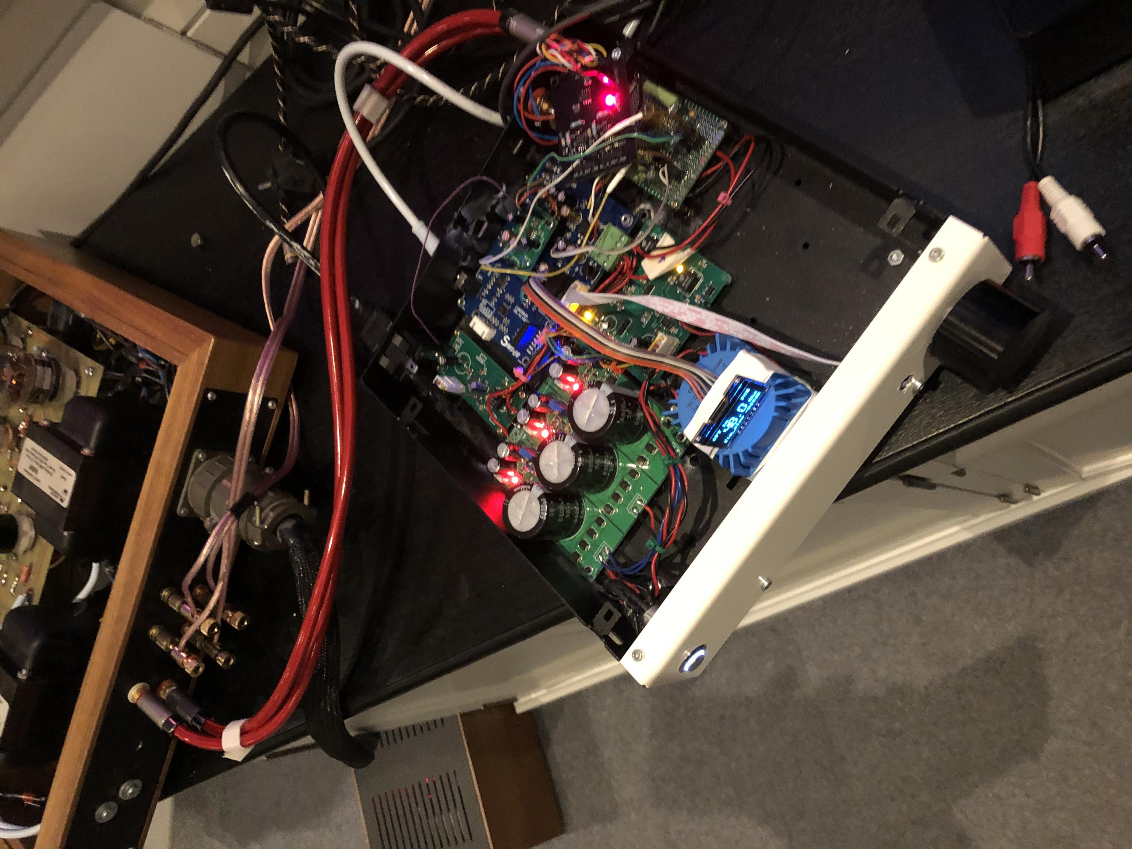

Another question, i have asked this before but try again.
I have changed ny dac board with another es9038q2m board.
Old one was a bit messy from soldering.
Anyway, new board have the same problem locking 48khz pcm from
Samsung tv with optical input.
Every other optical inputs work fine that i have try, but its 44.1 kHz.
Anyone have tried optical inputs at 48khz from tv?

Given that you are having the same problem with the old board and the new board with respect to decoding optical SPDIF (also known as TOSLINK) from the Samsung TV, it suggests to me that maybe either the dac board is using a poor quality optical receiver module or that the TV configuration menu might not be set for "decrypted stereo" output mode.
If you were to do the I2C mod on the dac board so that you can take over the dac registers, you could see what the dac chip SPDIF receiver thinks the TV is sending. SPDIF format allows for non-audio formats to be sent and or for some embedded non-audio information to be sent along with normal audio. That information should be readable from a SPDIF status register in the dac chip. Its been awhile since I programmed a SPDIF receiver, but there may be some setting in the dac chip's receiver settings that is rejecting the TV audio when it shouldn't be.
In addition, if you did the I2C mod you would also have control of "DPLL Bandwidth" for potentially significantly improved sound quality in all modes.

Thanks Mark,
I did try another optical reciver, no improvment.
Also tried a dir9001, optical in and i2s out. Same lock problem from Samsung tv.
In tv menu it is set to stereo out. Can’t change kHz or anything else.
Is it somewhere in this thread a guide how to access the dac register over i2c?

Yes, there is some info on accessing I2C registers. However some of the soldering can be small, and to some people intimidating. There are some links on the subject listed in post #3308 of this thread.
Probably also worth mentioning is that in the very worst case if someone accidently damaged the MCU while trying to fiddle with its I2C pins, its quite possible to run the dac with an Arduino as the MCU.
EDIT: Accessing and using the dac I2C registers also requires understanding some things about the I2C registers and how they are normally configured. That has not been discussed in detail in this thread due to ESS restrictions. Beyond that, PM okay if needed.

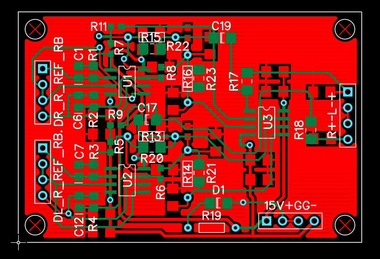

Hello,
Here is the Gerber file for the PCB i use in my dac.
It's from the schematic in post #3003, except that it doesn't have the unbalanced output.
Works for me but can't say for sure that's a correct PCB. And layout are for sure not optimized.
But a nice improvment over the voltage mode OP that are on the orginal dac pcb...
Reason for R13-R16 is throug hole (i put a SMD 1206 in parallel) is that i couldn't find smd parts.
So if anyone want to build this pcb choose either R13-R16 or R20-R23.
D1 and R19 is also an option, i use it to see that dac was on.

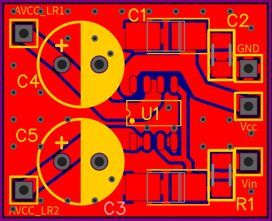

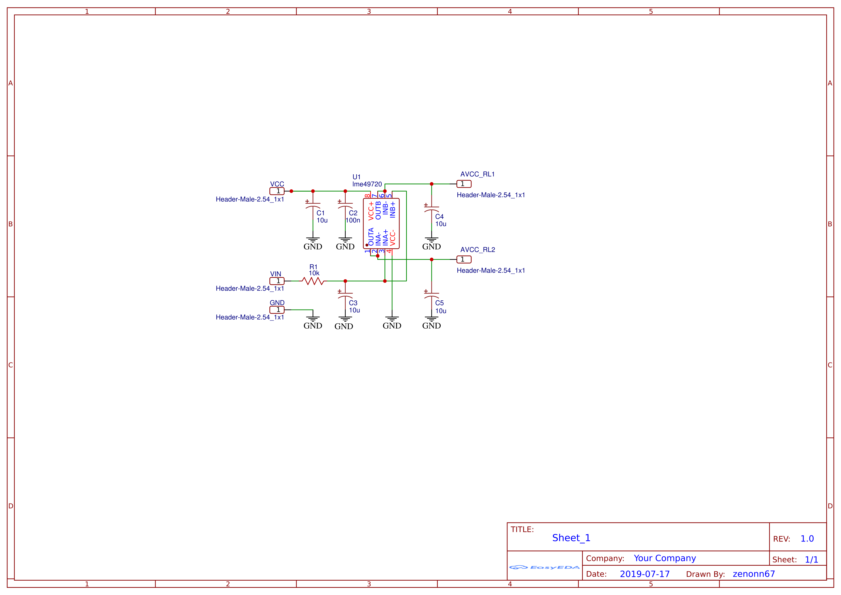

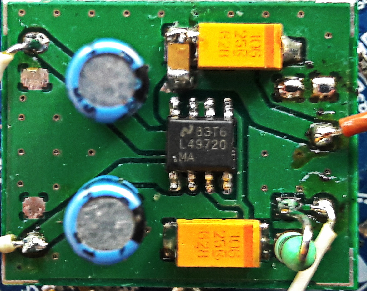

AVCC_LR power supply
(PCB & Schematics, Gerber, Project files)

Thank you for posting Gerbers and source files for output stage and AVCC circuits. I don't have time to take a look at those right now since I am in the middle of something else, but others who know about PCB layout should be invited to take a look.

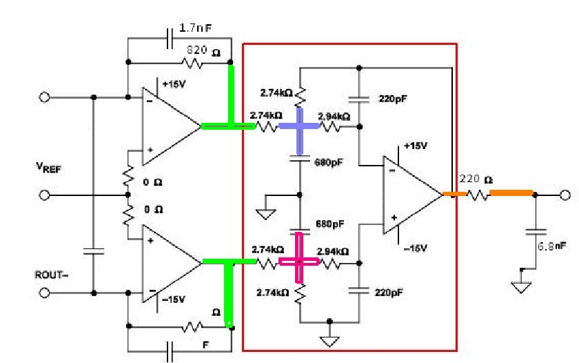

I would probably be inclined to try to layout the output stage more in the way suggested in the attached diagram (bypass caps not shown but should be included). I think all the components could probably be mounted on the top of PCB if the opamps are oriented correctly with respect to signal flow. If so, then most of the bottom side of the board and a good amount of the top could be used for ground pours so as to make a high quality grounding design for the output stage. That output stage ground should be a continuation of the dac board ground plane to whatever extent possible.
The only thing I might change about the output stage schematic might be to add another pole of passive filtering before the differential summing stage. I think that could probably be done fairly easily.
