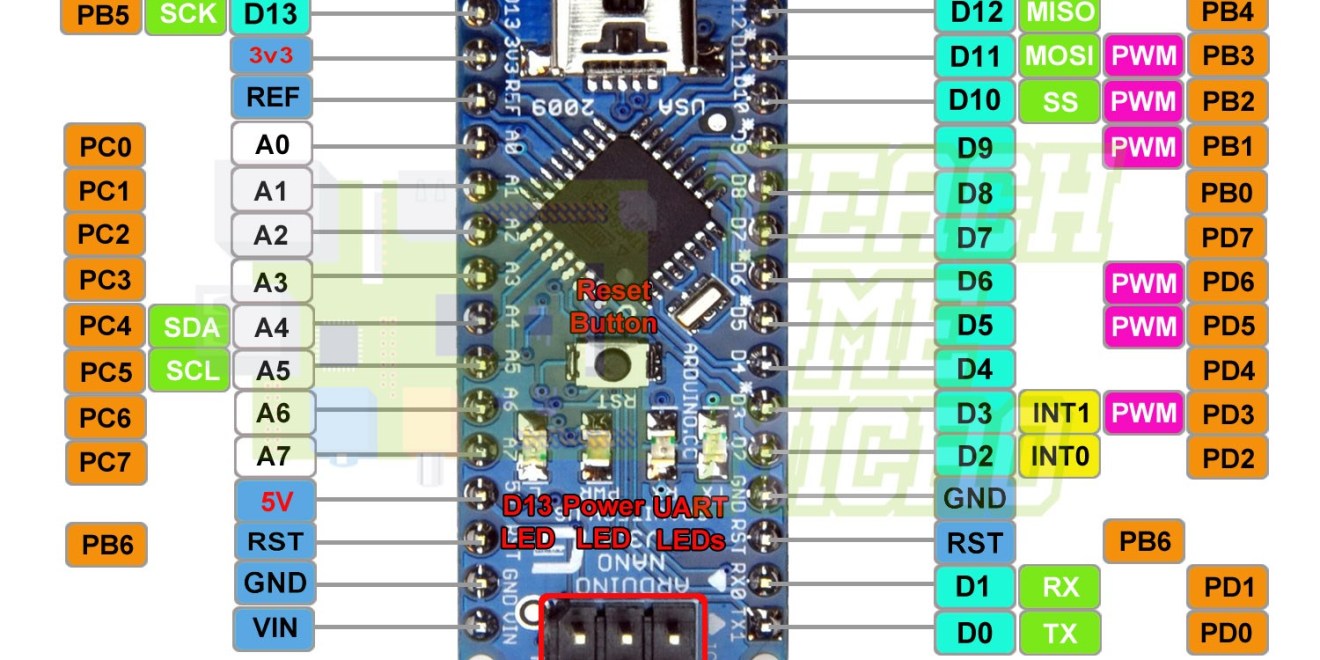

So far as I know, any Arduino should be able to work. Just google the pinout diagram for the model of Arduino you have. For example the pinout for Arduino Nano is attached below.
Looks for the pins labeled SCL and SDA. Those or the I2C bus pins for that model of Arduino. Google found some more info about using Nano (and others) for I2C: Can’t Get I2C to Work on an Arduino Nano? (Pinout Diagrams) | Big Dan the Blogging Man

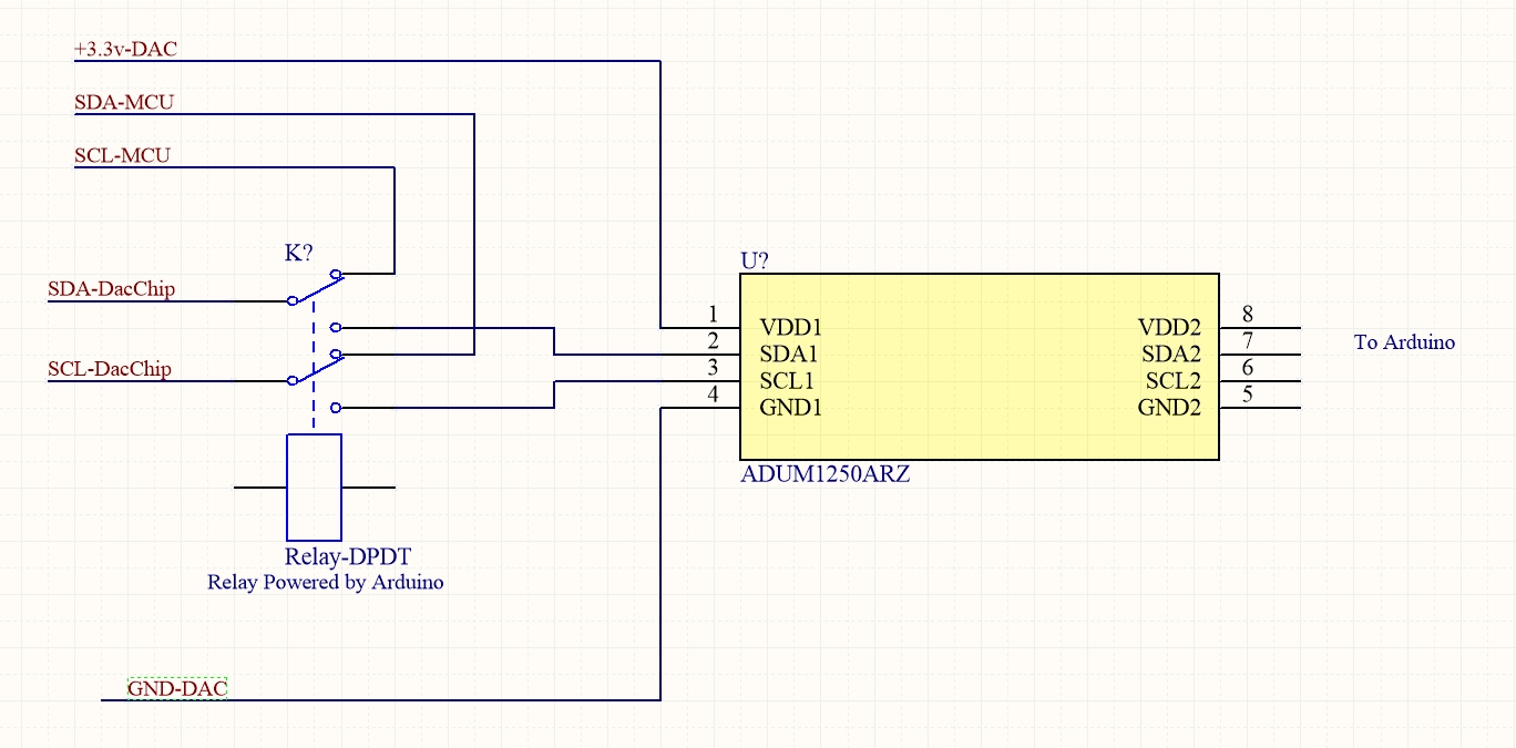

Mark, what (SDA+SCL or Vcc/Vdd) do you switch with the mini DPDT relay, and how many contacts(1 or 2 morse) it have?
Can you draw a schematic about the application of the ADUM1250 and the relay?
Thank you! Dee

The dac chip runs on 3.3v, however its I2C pins are 5v tolerant when the dac chip is powered on. Also, Arduino pins can be damaged if non-power pins exceed Vdd. In both cases the devices could probably be protected by using Schottky diodes to clamp interface pins so they can't go higher than Vdd (even when Vdd=0v which happens with the device is powered off). However, some Schottky diodes have enough reverse leakage to damage device pins during turn on transients when a device is just powered on. A diode I have found to be safe is: SR100-TP
Any other means you can think of should be fine too. The point is to make sure that neither the dac chip nor the Arduino can be accidently damaged by the other, even during transient conditions. Another possible way to consider might be to disable the relay coil when both devices are not already powered on.
One more thing probably worth explaining is what DPDT means. The letters stand for Double-Pole, Double-Throw. A 'Pole' in this case can be thought of as a common terminal on a multi-position switch or on a relay. A 'Throw' can be thought of as one of the terminals that a common terminal can be switched to.
So, a DPDT relay has two common terminals, and each common terminal can be connected to two different switch-position (or relay-position) dependent terminals.
In the diagram I posted, the common terminals of the relay go to the dac chip's SDA and SCL pins. The position-dependent terminals (N.O. and N.C.) go to the MCU and to the isolator chip. (N.C. stands for 'normally closed' where the 'normal' condition is when the relay is de-energized.)
The terminology 'DPDT' may be more commonly used by electricians, but its something electronics guys should be familiar with too. Other similar terms include SPST, SPDT, DPST. Also, electricians have some things called a 3-way switch and 4-way switch. Google may be helpful for those, they have possibly interesting internal construction.
