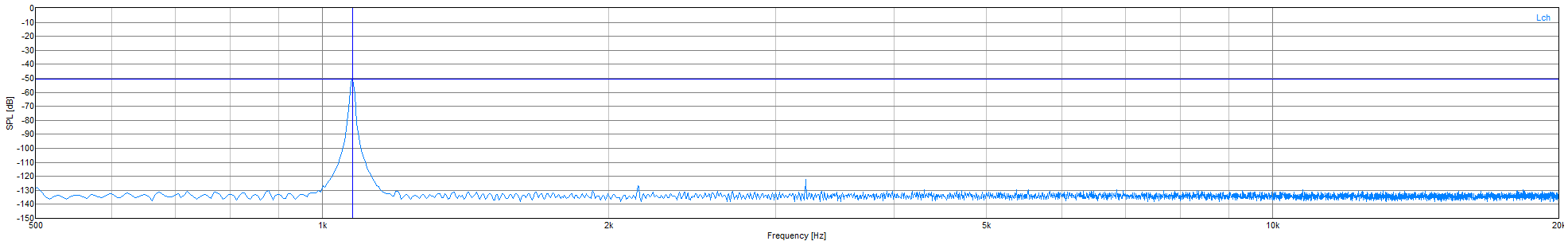

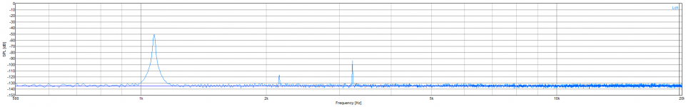

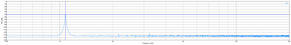

I was not able to hear any defects, didn't compare side by side with a “reference” DAC yet.
(but an AudioGD 9038Pro I have shows higher harmonics )
So FFT at 1075 Hz (it’s my homemade notch filter frequency) before any changes made - before.png
After soldering 4 wires (2 wires per channel) and adding 2 resistors (1 per channel) to add amplification, I have - after.png

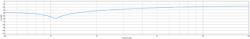

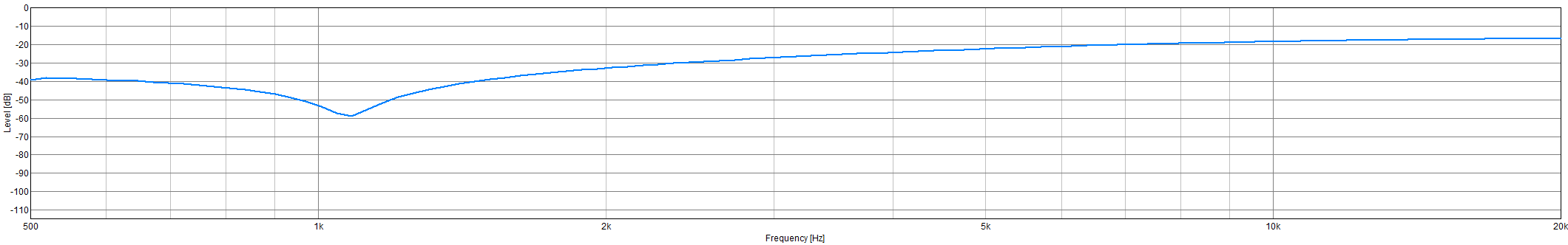

I would say it’s a good result of the repairs.
