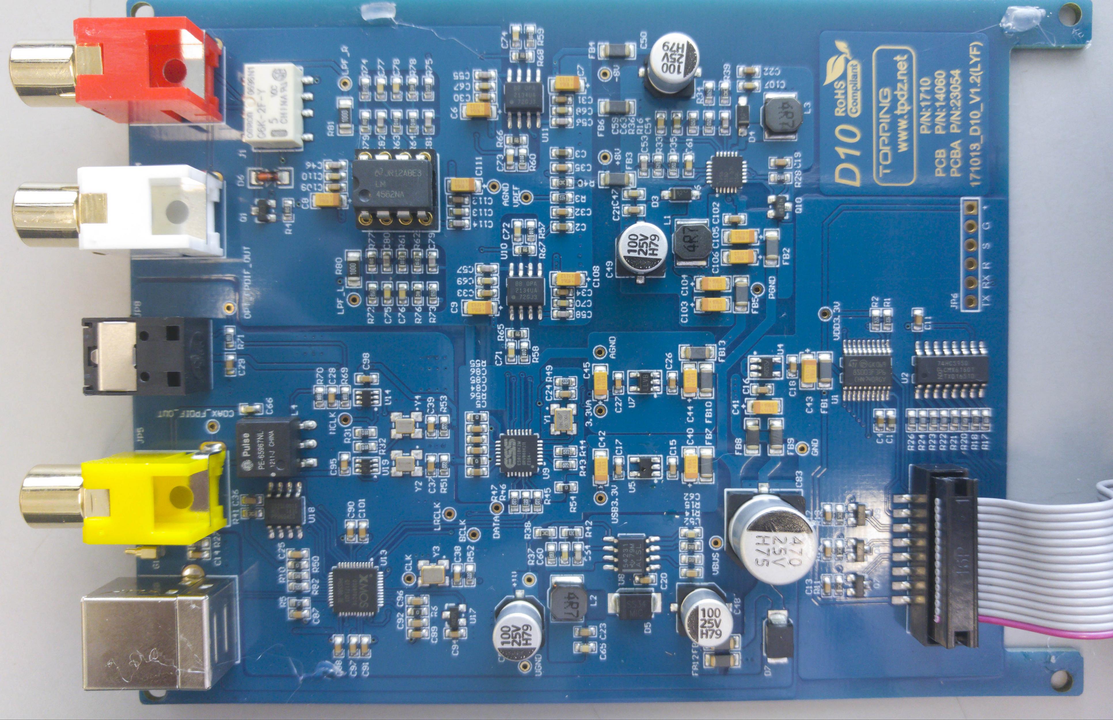

Es9038q2m have a great mute function already do you know why they use relay just before outputs. It is usual aplication for ak dac but not for ess.
All comments are welcome.
After DAC chip usually there is I/V and/or LPF, output buffer, etc. Mostly with OP.
During the transients, like power on/power off, when the VCC/VEE are below some value, OP is are not controllable, and there is a glitch at the output.
It not depends of a DAC chip.
Relay with the dedicated control (power supervisor) at the output can solve this problem.
