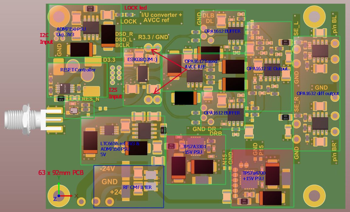

Hi, if anyone interested, I can provide gerber data / schematics / BOM for an IV stage based on the experience gathered in this group. It can be used as an IV addon for the usual ES9038Q2M boards, and it contains also a few low noise LDOs for every auxiliary functions. As I designed it, I realized, that the only thing I need from the original board is the ES9038Q2M chip itself... So finally I also placed the footprint of this chip as well on this PCB...
Only drawback of this design, that it's not DIY friendly: only for experienced guys with good soldering experience. (SMD only).
It's a small PCB, with 4 layers, 63x92mm, so, quite cheap to produce at JLCPCB (I paid 7$ + postage for 5 pieces).
I have produced one piece for myself, transferred the ES9038Q2M from the original board to this one, sounds quite good, however I cannot measure it without proper equipment. I just run it on DSD signals (AK4137), cannot evaluate PCM.

I created it for myself, and soldered it myself. I don't sell it. If you want to implement it, it's up to you, how you want to realize it. As far as I know, there are some services online, where you can order the PCB together with SMD assembly. I did not use such services yet.
It is possible to do partial assembly, therefore you can leave out the DAC and all the regulators, and just use the I/V stage part. Hereby I attach the manufacturing files (the zip containter), what I've sent to JLCPCB for production, use it as you like, choose a suitable PCB production factory.
View attachment ivstage_Fabrication.zip
Note: I designed the PCB for impedance controlled 4-layer PCB, see the layer stackup (strucure of the PCB) drawing inside the fabrication zip file.
Bill of Material Circuit diagram :
View attachment ivstage_BOMcircuitdiagram.zip
Assembly instructions / placement of components / automatic placement file / paste-mask files can be found in the assembly zip file.
View attachment ivstage_assembly.zip

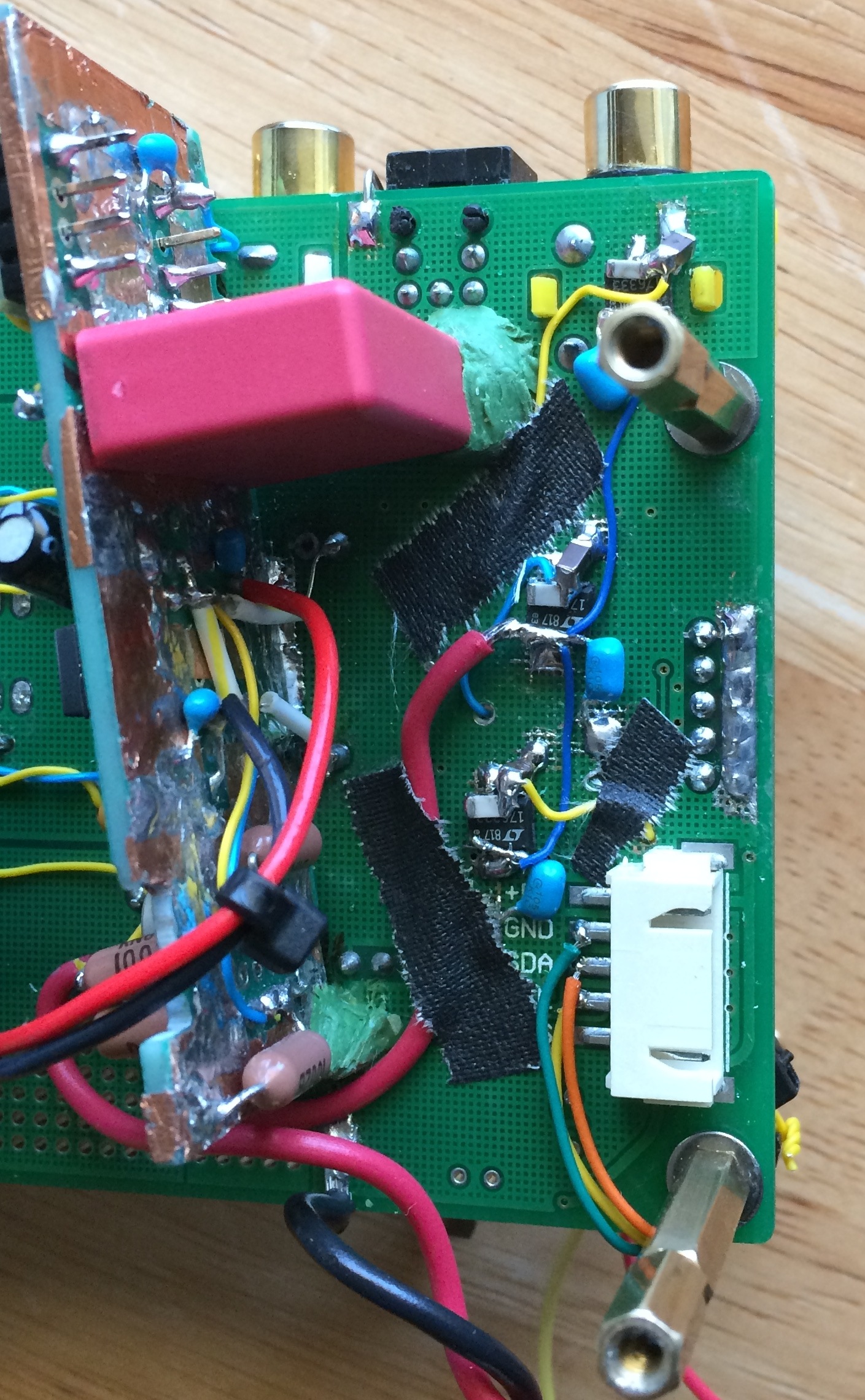

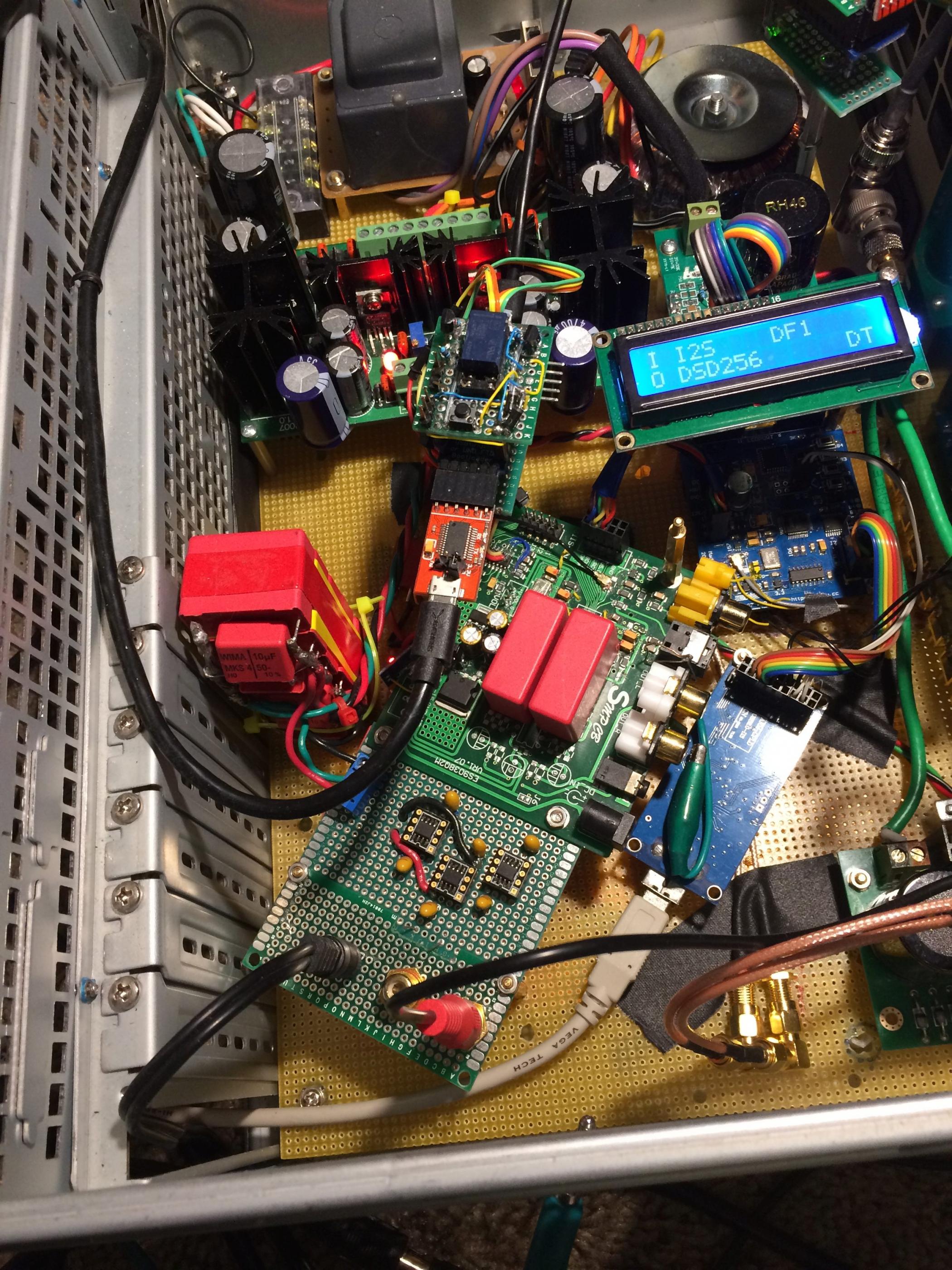

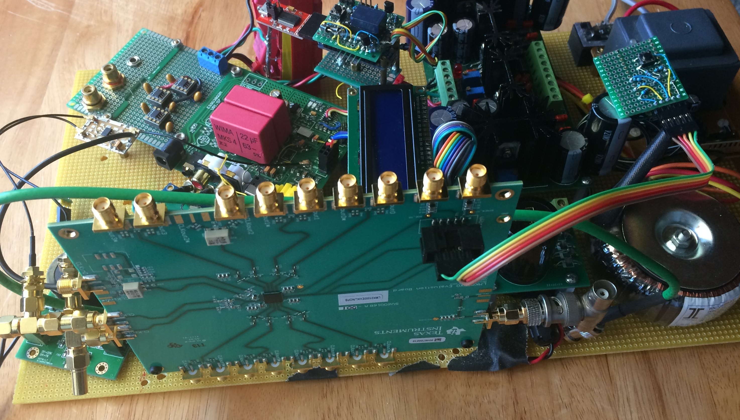

It was a very long and involved. I can show you a few pics that are near the final version, but not quite. It was enjoyable to listen to, good enough to sell commercially a high-end professional audio designer friend told me. I said it was way too complicated and would be too much work to reduce down to a sellable form.
EDIT: Just noticed the pic in the middle looks closer to the final version. The LVCMOS to LVDS converter hanging in air in the first pic was moved to a corner of the bottom of the dac board and soldered to the ground plane. It was also given a dedicated voltage regulator.
