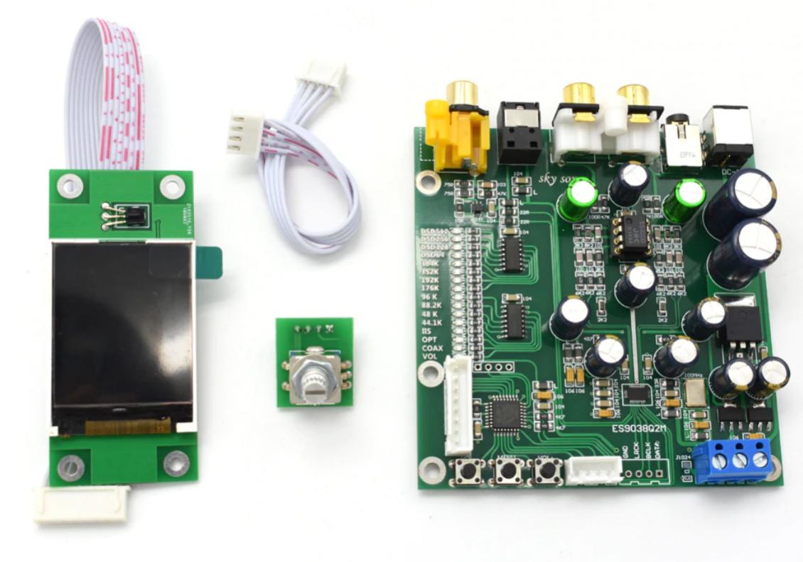

My understanding is the only offer that comes with remote + display, while being still acceptable (little deviation from the recommended board), seems to be:
ES9038 ES9038Q2M Mini DAC SPDIF I2S DSD Decoder DAC Headphone Out,LCD Display | eBay

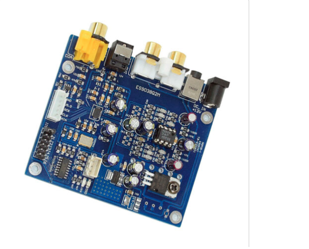

There is though a blue board (from the same company?), a tad less expensive, that seems different from the other blue boards (that are not prefered), with perhaps different PS options ... not sure that one is acceptable but Mark can comment perhaps?
DSD DAC Decoder Board Support IIS DSD 384KHz Coaxial Optical Fiber DOP TFT sztop | eBay
Other than these all seem to be pale copies from the recommended one... or worst. Mainly blue boards etc.
I have attached a picture of what appears to be an updated version of that board. Am I correct? Is this an updated version? It is offered with and without the display.

The second board you linked to does appear to be made by the same company as the green one. The second board also appears to have a MCU with more pins, display, remote, etc., all included. Another feature is that there is an I2S selector chip allowing two I2S sources to be used without having replug connectors. The downside of the second one may be that the MCU generates more noise, and that the I2S selector chip may introduce more jitter coming into the dac chip. Those potential issues could be corrected, but maybe more modding work in terms of keeping different loads on different dedicated regulators. Up to the person doing the modding, whatever they would like to do.

My understanding is the only offer that comes with remote + display, while being still only a little deviation from the recommended board, seems to be:
There is though a blue board from the same company, a tad less expensive, that seems different from the other blue boards (that are not prefered here!)
To quote Mark on this second option:
