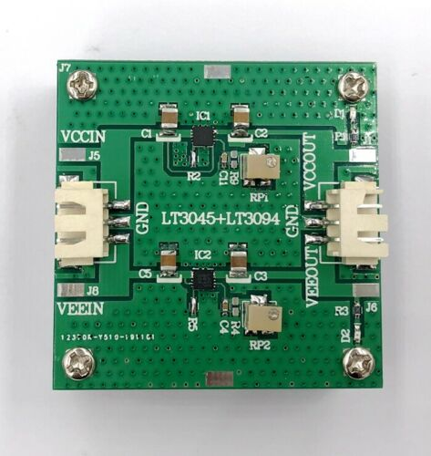

I wold vote for LT3045/LT3094. But is is kind of overkill for op amp PS, IMHO

There is a similar LT3045 LT3094 module. (Pictured.) I don't like the low absolute maximum input voltages but I could power it from my LM317/LM337 supply set to something like +/- 20V to supply the ES9038Q2M board at +/- 15V.
It might be overkill but I suppose with a couple LT3045 I could be done with it and not question the DAC supply.

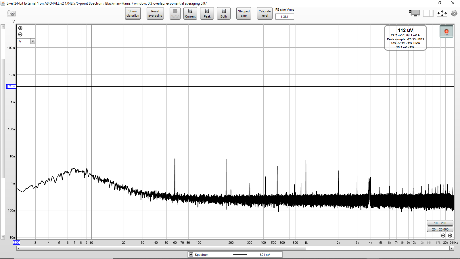

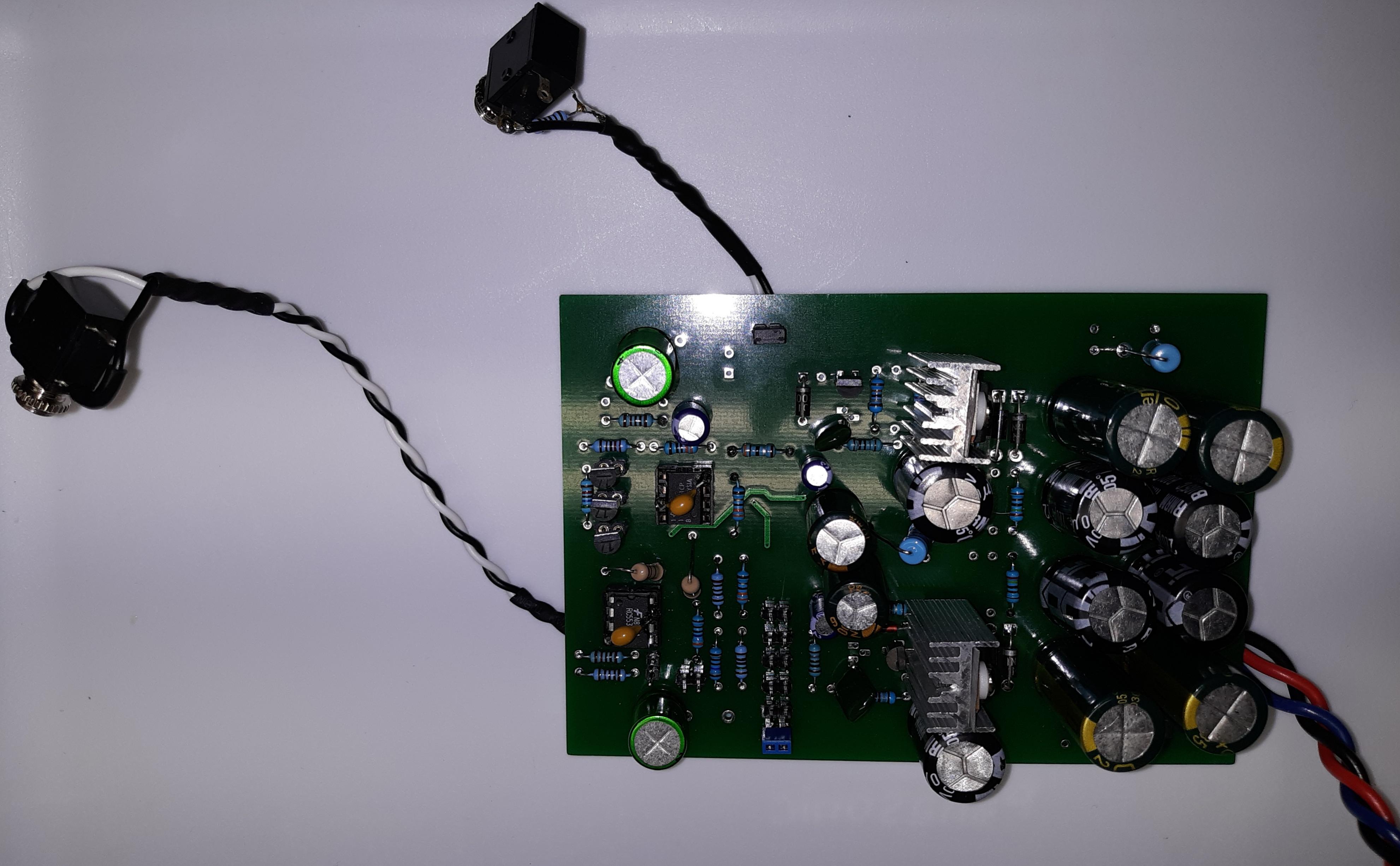

Perhaps you can offer some advice that will help with my ES9038Q2M as well as my AK4396 and noise measurements. I have been working on a Douglas Self type MC LNA (60 dB) so that I can make noise measurements on my DAC boards as I modify them. (Both the AK4396 and later the ES9038Q2M which is on order.)

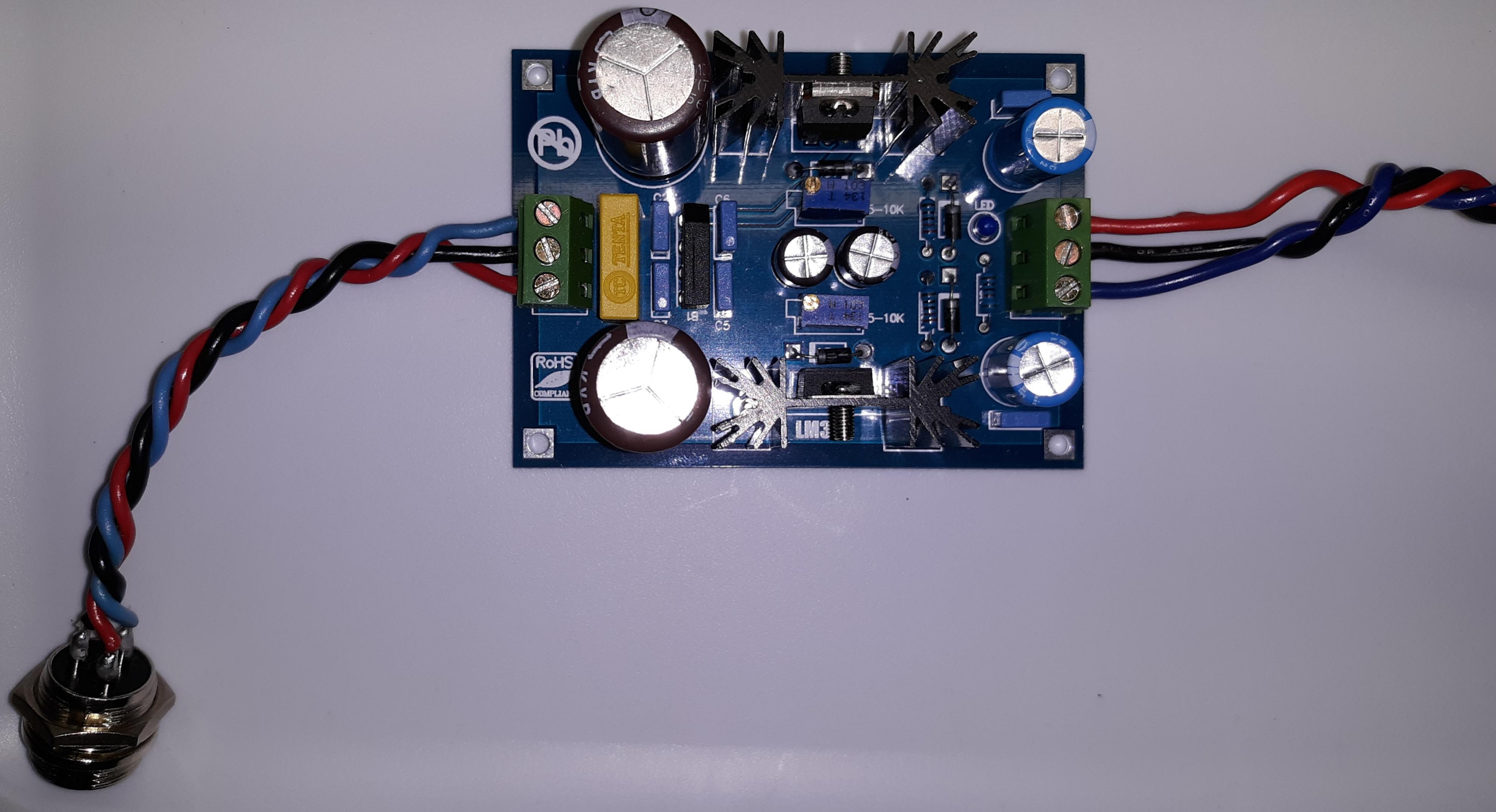

The LNA has LM317/LM337 onboard with the denoiser (BC337/BC327) and in addition I use another LM317/LM337 supply externally to preregulate +/- 20V to supply the LNA board.

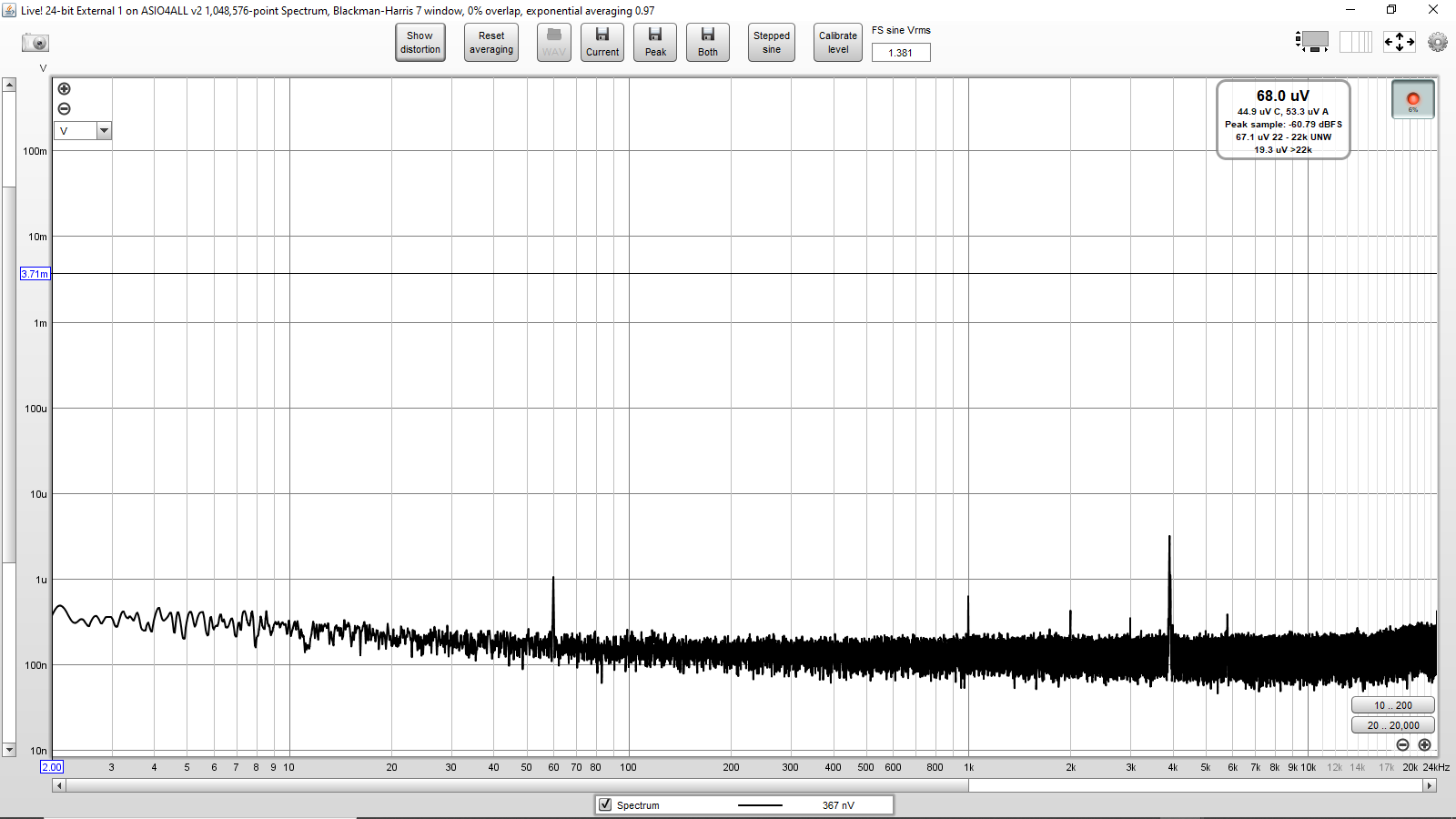

Unfortunately I have a stubborn 8nV 60 Hz peak (8uV an the output of the LNA on the 60 dB gain setting) that I have not been able to get rid of yet. I have attached pictures of the LNA, the LM317/LM337 pre-regulator as well as the noise measurements with the LNA input shorted (60 dB gain setting) and with the LNA powered off (to see what is not coming from the LNA).
The spectrum show what is at the output of the LNA. So divide the voltages by 1000 for the level at the input of the LNA.
Any suggestions on how to find and eradicate this 60 Hz (and 180 Hz) peak? I have unplugged all other equipment in the area and the laptop is running on battery with the WiFi disabled.
LNA 60 dB Gain Self Noise Check With Input Shorted All Other 60Hz Sources Unplugged.png79.7 KB · Views: 272
Personally, I haven't found that I need LT3045/LT3094 to get excellent audio sound quality. The recommended circuits attached to post #3003 are pretty good as far as schematics go. Everyone I know of who tried LT3042/LT3045 for AVCC eventually found an opamp based regulator of some type sounded much better to them. Why? I don't know. Don't have time to study it.
The ebay voltage regulator boards I have recommended are more than good enough for a quite/exceptionally good, few-thousand dollar dac (although one of them does use LT4042, its better than needed). Specialized regulation beyond that is only needed for AVCC, at least for these ES9038Q2M dacs. The rest of getting it to work well is all in the implementation details.
Regarding the power line frequency spurs, how are you powering what you are measuring? Is the circuitry in a shielded metal box? How much care are you taking with interconnection wiring? With grounding? Layout?
In other words, it might help if we had more info and pics of exactly what the setup is where you are doing the measuring.
Learn to make noise measurements. Your representation in V-f coordinates for noise measurement makes no sense, since the frequency bin size is not considered, you need to represent noise measurements in V/rtHz or V^2/Hz (in dB) vs. frequency (log scale), all PC based software have somewhere the option to correctly represent noise.
60Hz and harmonics cannot be completely avoided, unless you shield the LNA in 1/2 inch of aluminum or a 1/8 steel enclosure. Double shielding in thin steel cans can work too.

Right now I am just measuring the 60 dB LNA with the LNA input shorted. (Not measuring the DAC yet.) So I am still debugging and verifying the LNA.
The LNA is in a recycled steel DVD chassis. I have tried various grounding with the best seemingly with the ground of the power supply section (LM317/LM337 on the LNA board) connected to the steel DVD chassis. But the results are similar to connecting the steel DVD chassis to the ground side of the LNA input.
The LNA has LM317/LM337 onboard with denoiser. That LNA board is being powered by the separate external LM317/LM337 preregulator. The preregulator supplies +/- 20VDC to the LNA that is inside the DVD chassis via twisted pair.
I can get additional photos later. Right now it is just the LNA inside the steel DVD chassis with the twisted pair feeding the +/- 20VDC from external.
See https://www.diyaudio.com/forums/ana...ra-low-noise-mc-head-amp-172.html#post5977292
Yes, I do have other options in REW. I will do that. However I was checking the LNA gain by feeding in known peak to peak input voltages and left the RTA display as V so that it matched what my test equipment was reading directly. (Just an easy double check.) I was generating known peak to peak voltages, feeding them to a 60 dB attenuator and then into the 60 dB LNA.
I just built the LNA so I am doing various tests on it.
Perhaps I can try some sort of double enclosure. Perhaps I can put the LNA first into an aluminum project case (die cast?) then then put that die cast case into a larger steel chassis.
