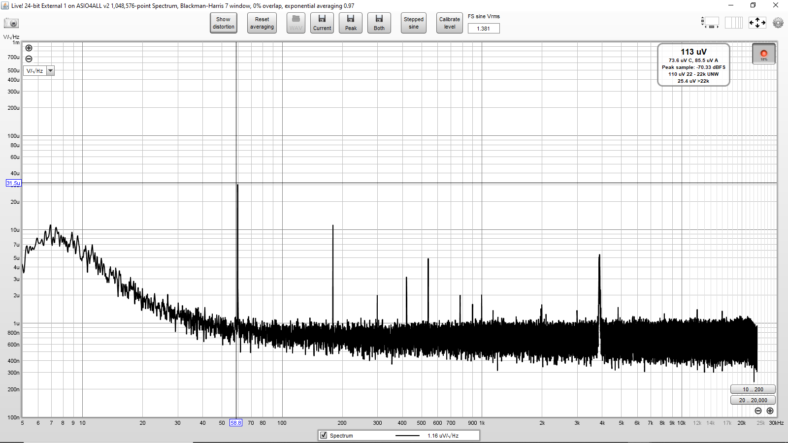

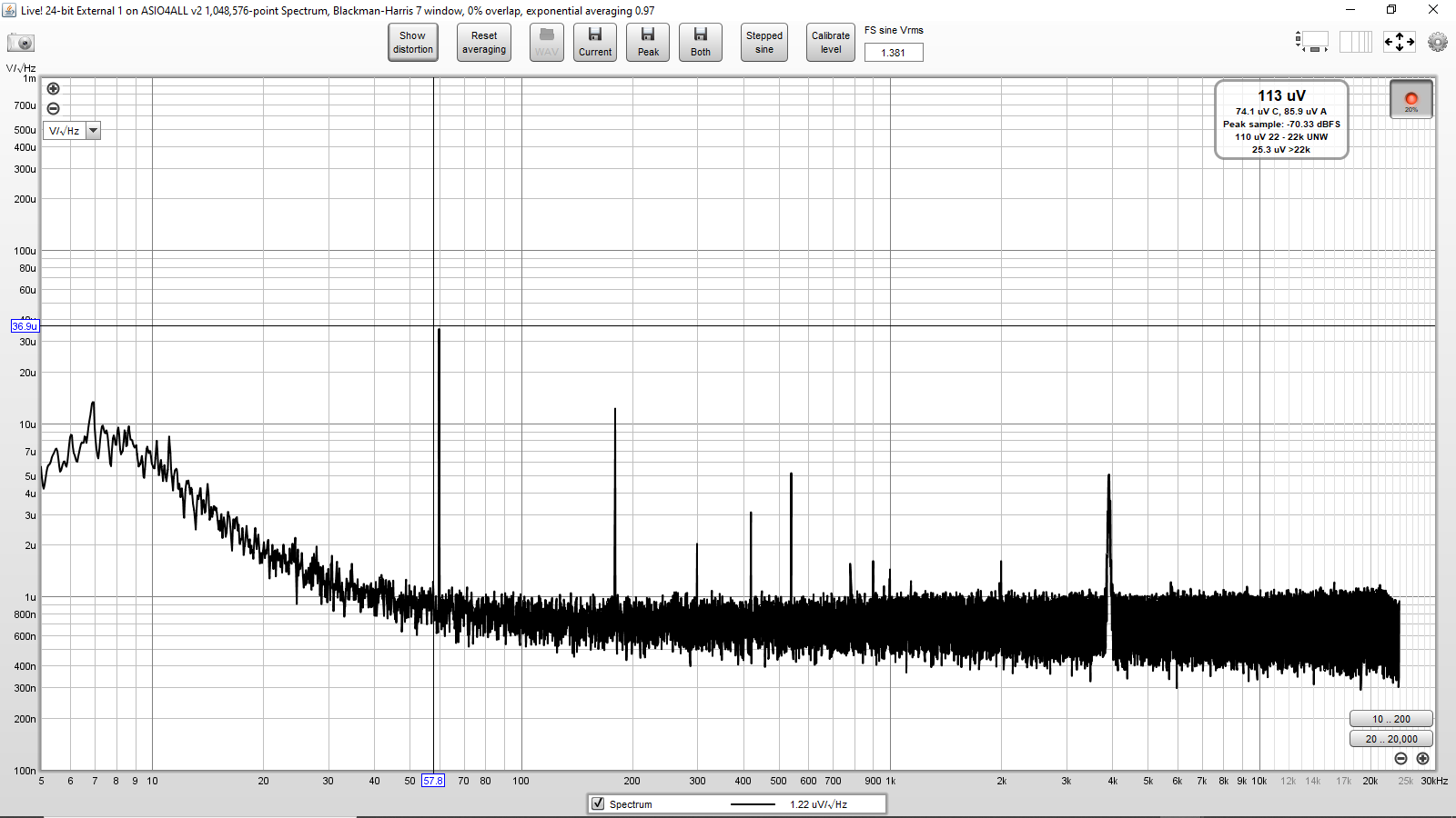

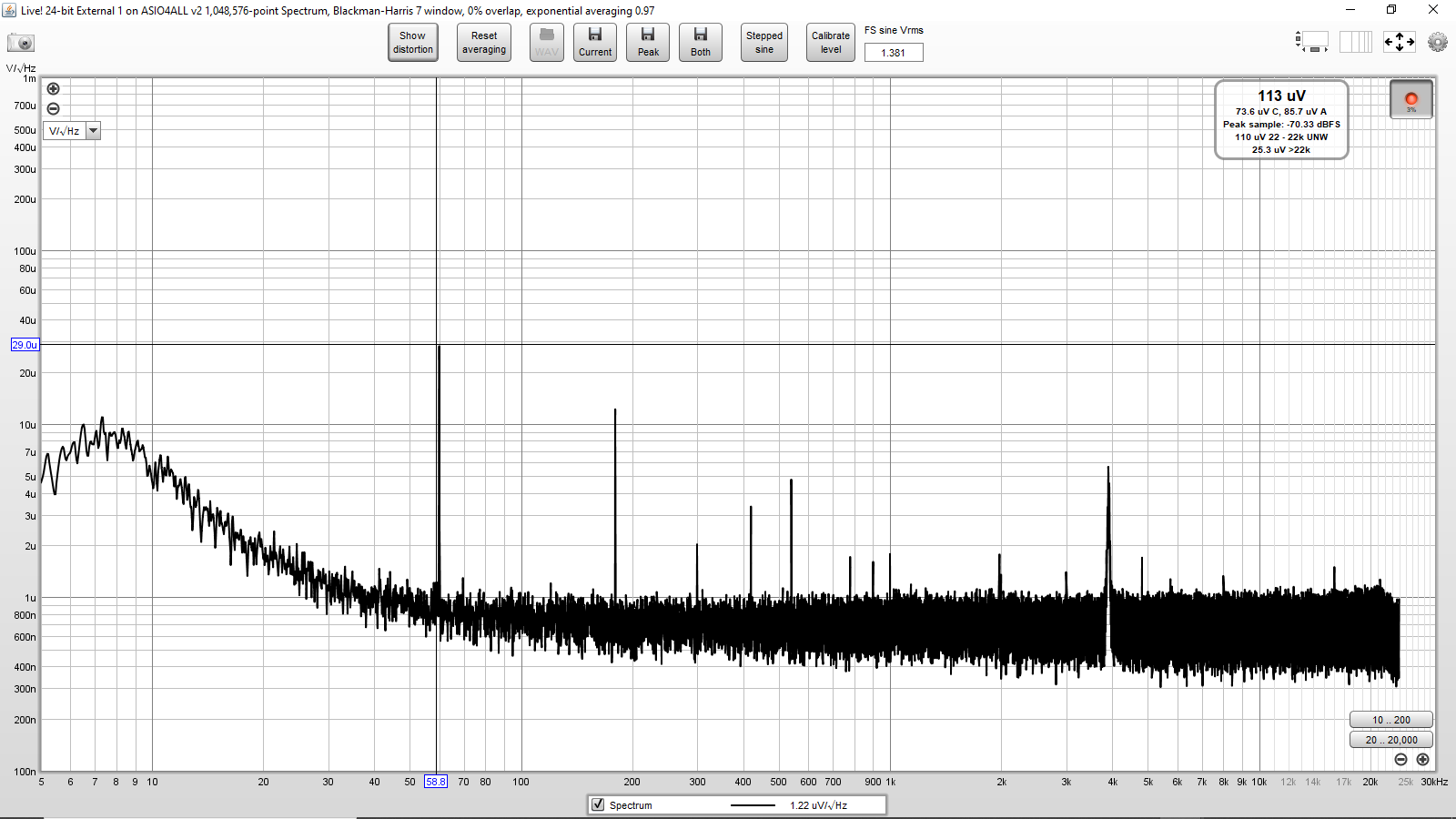

Ok. I did the following:
- Placed the LNA in a first (internal) steel box but make no electrical connections to this first steel box. [Royal Dansk Cookie Tin 😀]
- Placed the first steel box inside a second larger box. [Heavy Stainless Cooking Pot]
- Connected the larger (outside) steel box to ground.
- Connected the LNA ground to the larger (outside) steel box.

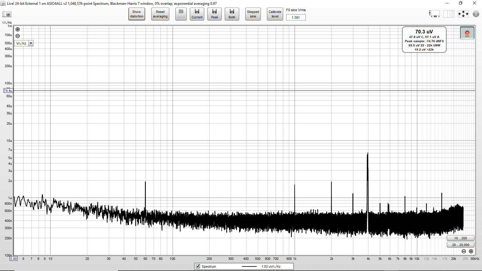

During the measurements I unplugged everything in the area including the overhead workshop light. The laptop was running on batteries.
Since it is 60 Hz (and 180 Hz) is it correct to conclude this is not from the power supply? There is no 120 Hz. (No sign of 120 Hz at all, so this is likely a clue.) I am not sure what to look for next.
The shielding experiment seemingly yielded nothing. Prior to the shielding experiment I greatly increased critical power supply caps 10x in size and ultra low ESR (should be totally unnecessary) and the 60/180 Hz did not move. (I already assumed it was not the power supply but I wanted to be 100% sure.)
Again the LNA has LM317/LM337 onboard with denoiser, plus CRC filter before those and then the rejection of the NE5534. (TL071 used as DC offset servo.) Again it is a Douglas Self MC type LNA.
Before the LNA board and external to the shielding is a second LM317/LM337 board that preregulates to +/- 20VDC. That board has nice large low ESR capacitors on input and Vadj.
Not sure what to try next. I might try swapping for high rejection ratio operational amplifiers. (I have some OPA228 and OPA277.)
Or maybe I try a different interface. Could the 60 Hz and 180 Hz possibly come from the LNA output connection to the 24 bit USB Sound Blaster Live? I would think not since the loopback is cleaner, the connection is shielded and the laptop is running on batteries.
It would be a pain but maybe I should try to run on batteries for a last test to totally rule out the input power to the LNA. Maybe I use two stacks of three 9V for a quick test.
Or perhaps I should try using a different audio interface?
Or maybe these levels are as good as it is going to get for now? The screen shots show the noise on the output of the LNA on the 60 dB gain setting. So input levels are 1000x lower.
LNA 60 dB Gain Inside Cookie Tin Inside Heavy Stainless Pot LNA Ground To Pot.png98.7 KB · Views: 259
LNA 60 dB Gain Inside Cookie Tin Inside Heavy Stainless Pot LNA Ground To Cookie Tin.png98.7 KB · Views: 251
LNA 60 dB Gain Inside Cookie Tin Inside Heavy Stainless Pot.png98.7 KB · Views: 241
LNA Off Inside Cookie Tin Inside Heavy Stainless Pot.png134.2 KB · Views: 248
For noise measurements you probably should use a sound interface that has balanced inputs/outputs. Most modern sound interfaces have them (e.g. Focusrite, Motu, Steinberg).
I would also try batteries as power source to the LNA.
Anyhow the rising noise density below 100Hz does not look good. That is probably due to the LNA design.
