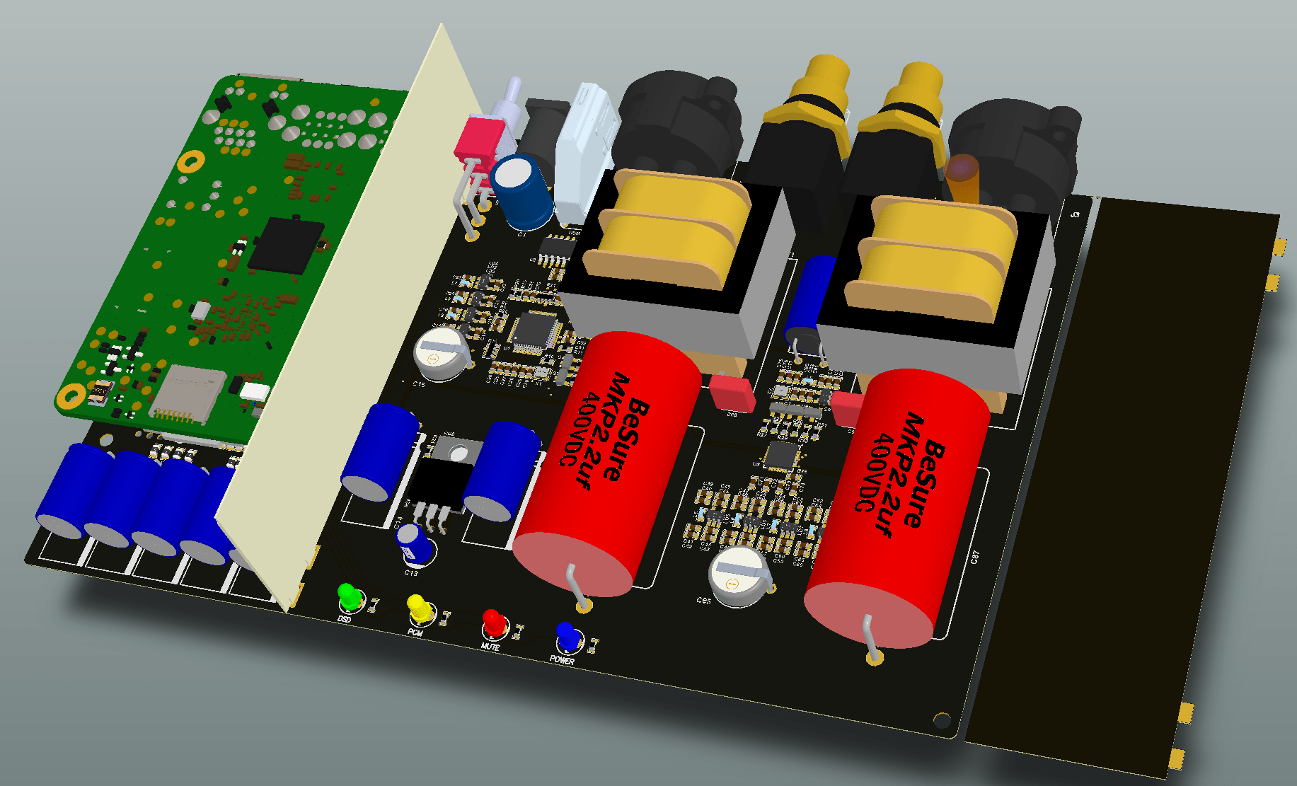

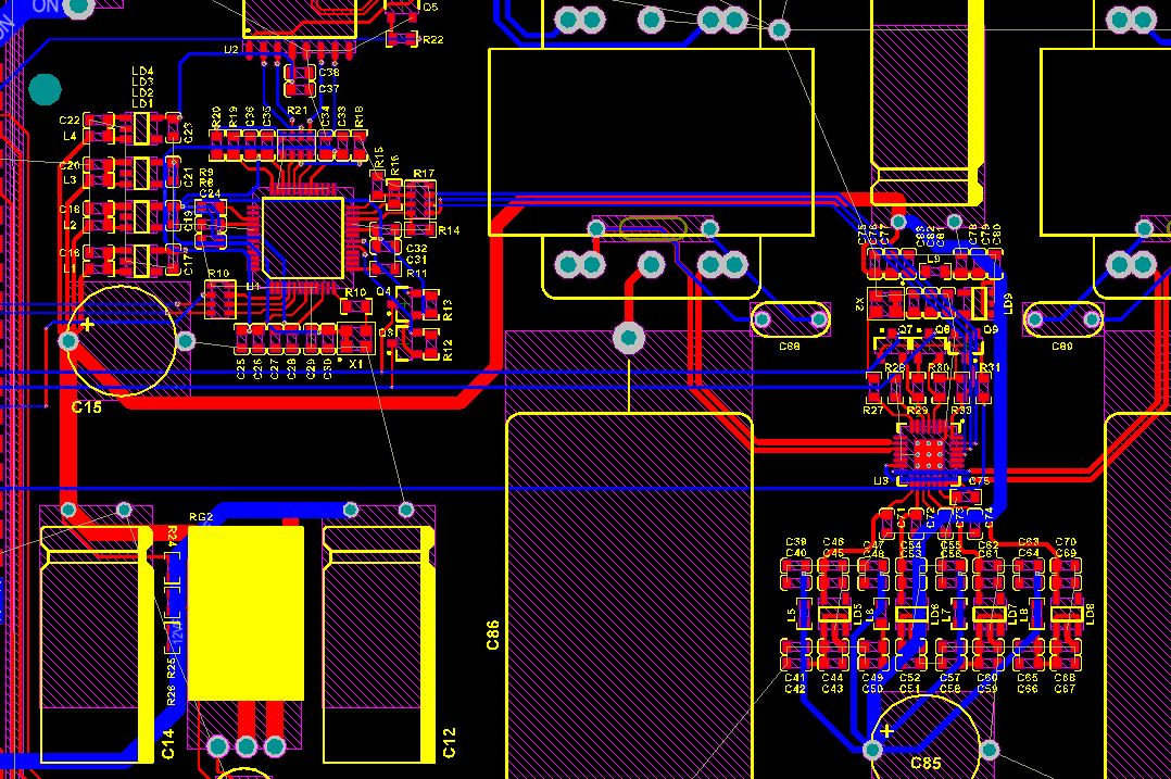

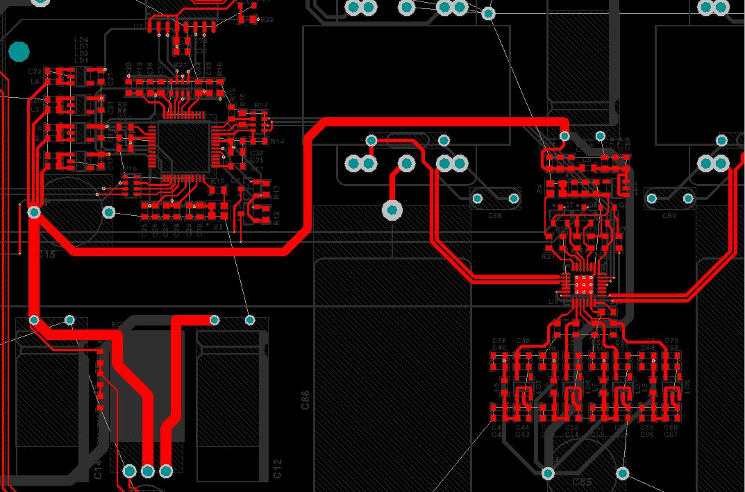

ES9038Q2M Board
Ask for everyone's opinion on this layout
A little better. There is also conducted EMI/RFI on ground and signal lines. The vertical shield might help some though. However, if you put the board in a metal case then reflection of radiated EMI/RFI off the inside of the top of the case might make the vertical shield wall less effective.
I use a solid CNC aluminum case that fits the board, so the shielding effect is more effective
