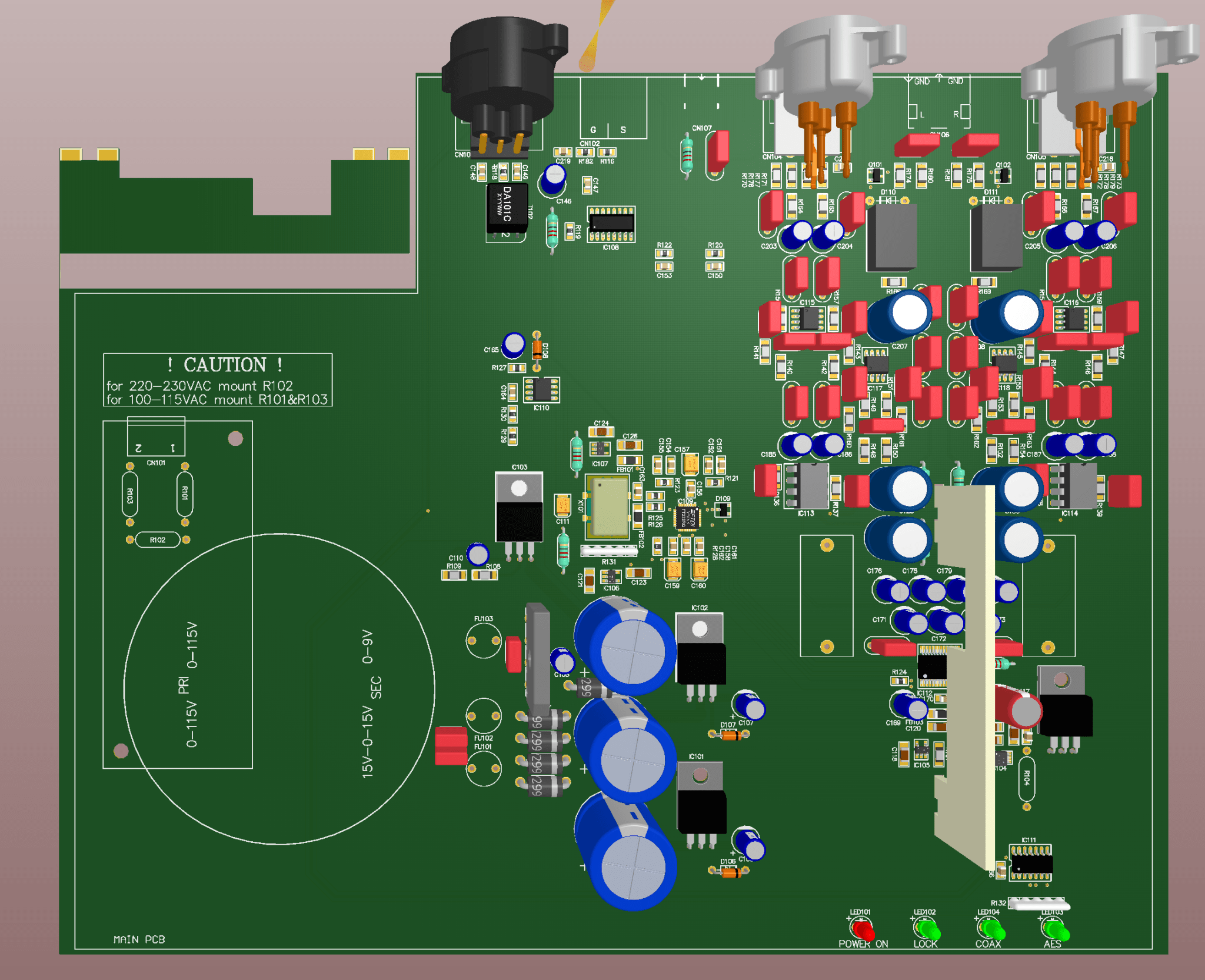

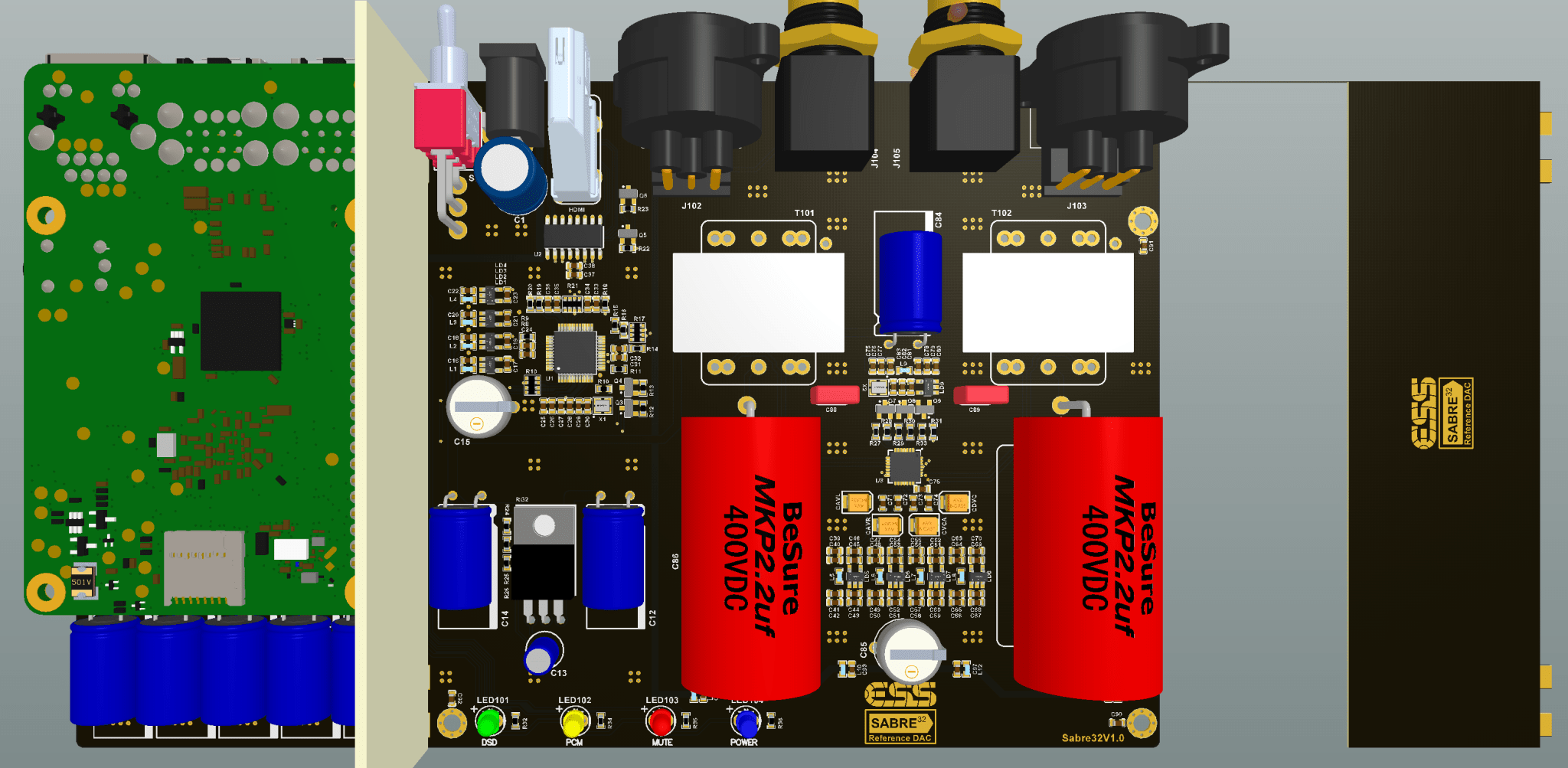

i will publish 20 pcs next month, using custom Linux ARCH supporting Roon ready , Spotify connect , Tital connect , Quboz , Amazon music HD, DLNA rendener, HighresAUDIO, Airplay2, internet Radio, NAS, USB.
It also supports fast switching USB DAC with DAC inside without rebooting
- Digital Line Level
- ES9038Q2M Board
