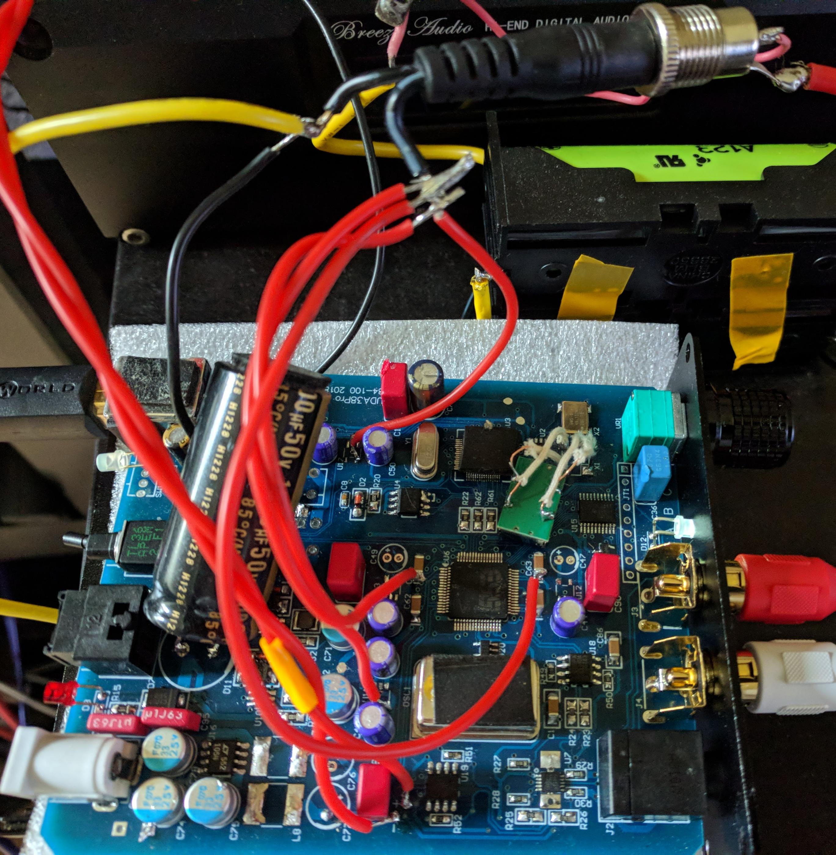

I've snipped off the OSCONs and put all the PS wiring as close as the board allows. Doing that brought out further refinement. Aside from the clock and messing with output stage I don't think I can take this much further right now. But wow, music sounds so good. Power supply, man, so important.
Well I powered up my daughter board holding the power supply and AVCC regs and IV.
It powered up fine intially without the op amps and I measured voltages. Perfect so far.
Then I popped in a couple dual TL072 op amps and then measured voltages. This was with the board not connected to the dac. I got voltages at the output. Hmm I even got AVCC output when there was no feed to the input filter for AVCC.
Then I changed the op amps and used some NE5532s. The voltages changed. Double and triple checked the circuits. Then I put in an LME49720 for the AVCC reg and the voltage changed again. Then I checked the input voltage before the filter and it was around 1v.
Ok, I am not an expert at op amp connections but it appears that the op amp was charging the filter cap on the input of the AVCC reg.
So I connected a battery pack that was generating 4.6 V to the input of the AVCC filter and the reg put out exactly the same voltage. So the regulator does work. At this point my only test for instability is temp. All the op amps were running cool and so was the voltage reg. I am scared that I will have to catch my woofers across the room.
I imagine that the open inputs is causing some offsets. I hope so.
Next few days the connection to the DAC.

You could check by putting resistors in series with your opamp outputs and running that into some headphones or earphones. It will load down the opamps and increase distortion if the resistors are too small, or make the headphones quiet and maybe flabby if too large, but at least you could get some idea of what is coming out before hooking it up to a full-sized stereo.
Also, some opamps have input protection diodes that may conduct if you allow the inputs to get too far apart or float. No inputs should be fully floating, some kind of resistor to ground or an intermediate reference voltage would probably be okay for initial testing. Input bias currents need somewhere to flow to or from.

@wushuliu, What kind of DAC is that in the picture? Don't recognize it myself.
It's the Hifimediy UAD38Pro.
It looks like the same Chinese company that makes the ES9038Q2M DAC boards is now also making their own SRC board.
It is cheaper from Ali Express than ebay, or so it appears:

I don't understand what you mean about using a 3042 to make the reference voltage for the IV stages. It makes no sense to me unless you are using the same 3042 to power AVCC.
Please see the diagrams below. The point marked "offset" is another name for "reference voltage." That is the correct way to make the reference voltage.
I'm not sure driving an opamp directly into a capacitor for AVCC is a particularly
good idea. You are probably better off using a small series resistor at opamp
output and then closing loop after that resistor. Refer to typical ADC IP circuit
for driving large caps required at ADC input.

Looks like you might be able to get the big clock off if you have a helper and two soldering irons. You could pry a little under one end with a jewelers screwdriver and heat the two end pins at once, assuming it has four pins of course. Work up one end a little then the other. Once it gets up high enough it might be possible to get under it and cut the pins.
Some people might try putting metal tape and or Mylar tape around everything but the clock then heat the clock can from the top with hot air (heat gun) or a radiant heater while using chip quik de-soldering alloy on the bottom.
The most certain way to get it off and avoid damaging anything else would probably be to cut open the top of the can and start disassembling it from the top. Don't know how many things I cut open with my trusty, old electronics diagonal cutters over the years. Finally moved up to a Dremel tool, which can make it easier, but still doable without, IMHO.
So far as I know those gold-color large-ish clocks go for about $10 on ebay: 1pc 80MHz TCXO 0.1ppm Ultra precision Golden Oscillator for USB DAC audio | eBay
but they are not ultra low-jitter down at 10Hz or 1Hz so probably not really worth $10 for audio. Temperature compensated clocking is not critical for our purposes.

Actually, it is a very good idea in this case. It has been tested and recommended by ESS if you read the application note carefully. Of course, one should use the opamp and cap they recommend. Otherwise it may not work.

AVCC has zero PSRR that I know of and they want minimal series resistance. I doubt they would have gone to a circuit that looks like it should oscillate unless more standard approaches, such as with a series resistor as you mentioned were tried first and didn't perform up to what was needed.
They say if you do it their way you can get -120dB THD, and measurements at Richard Marsh's showed that's what I got. It sounds good too, not too far from the DAC-3 but obviously not as good. There is still the matter of external interpolation filter DSP but that is beyond what I am up for in this project.

Yeah. I think I may take a chance and replace with a Connor Winfield VBLD861-Series. Looks pretty new, specs seem good.
