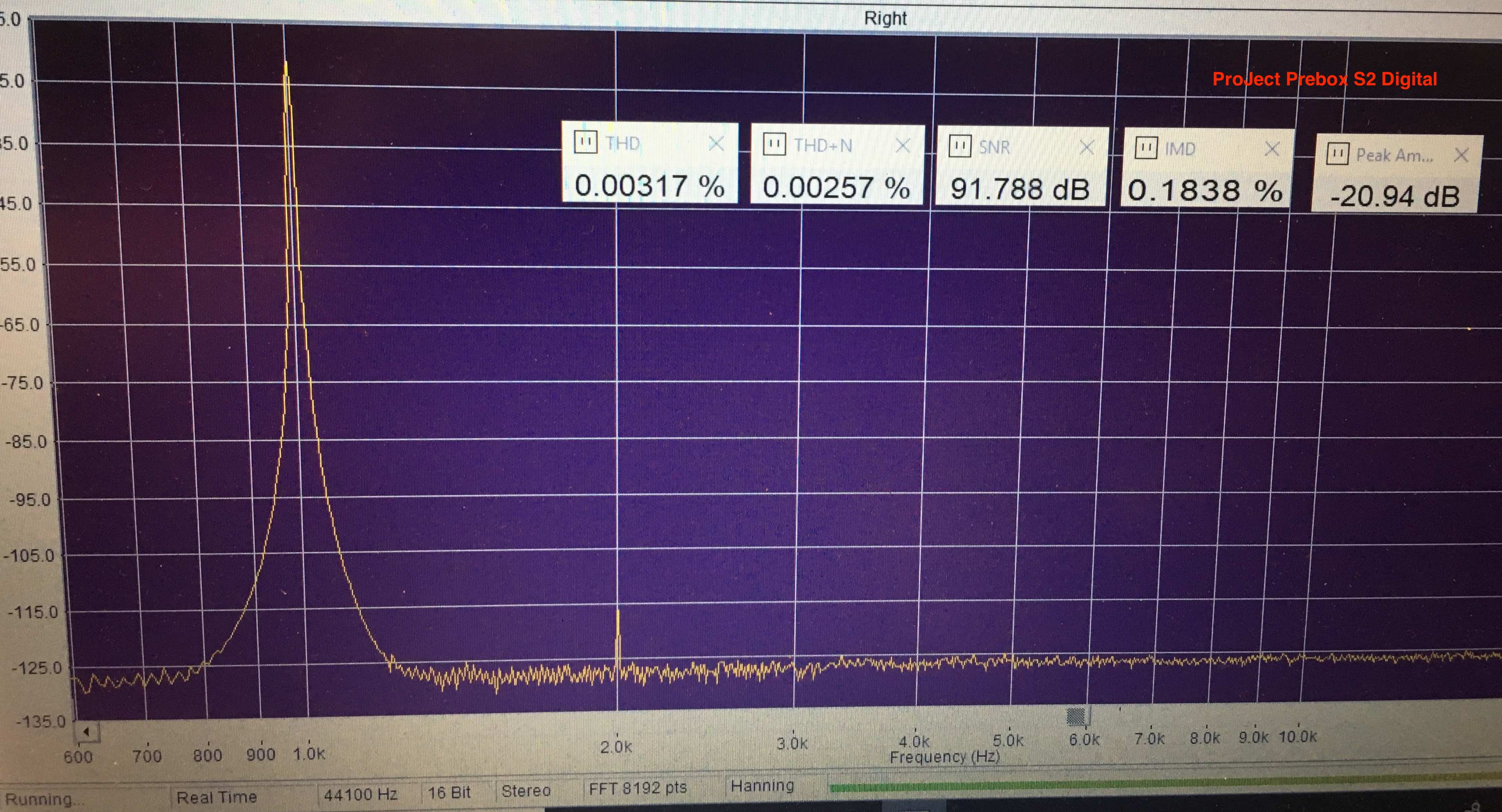

yes, that second harmonic is present even more also in ProJect S2 digital, which I remeasured now. would it be an artifact of the measurement setup, but I doubt it.

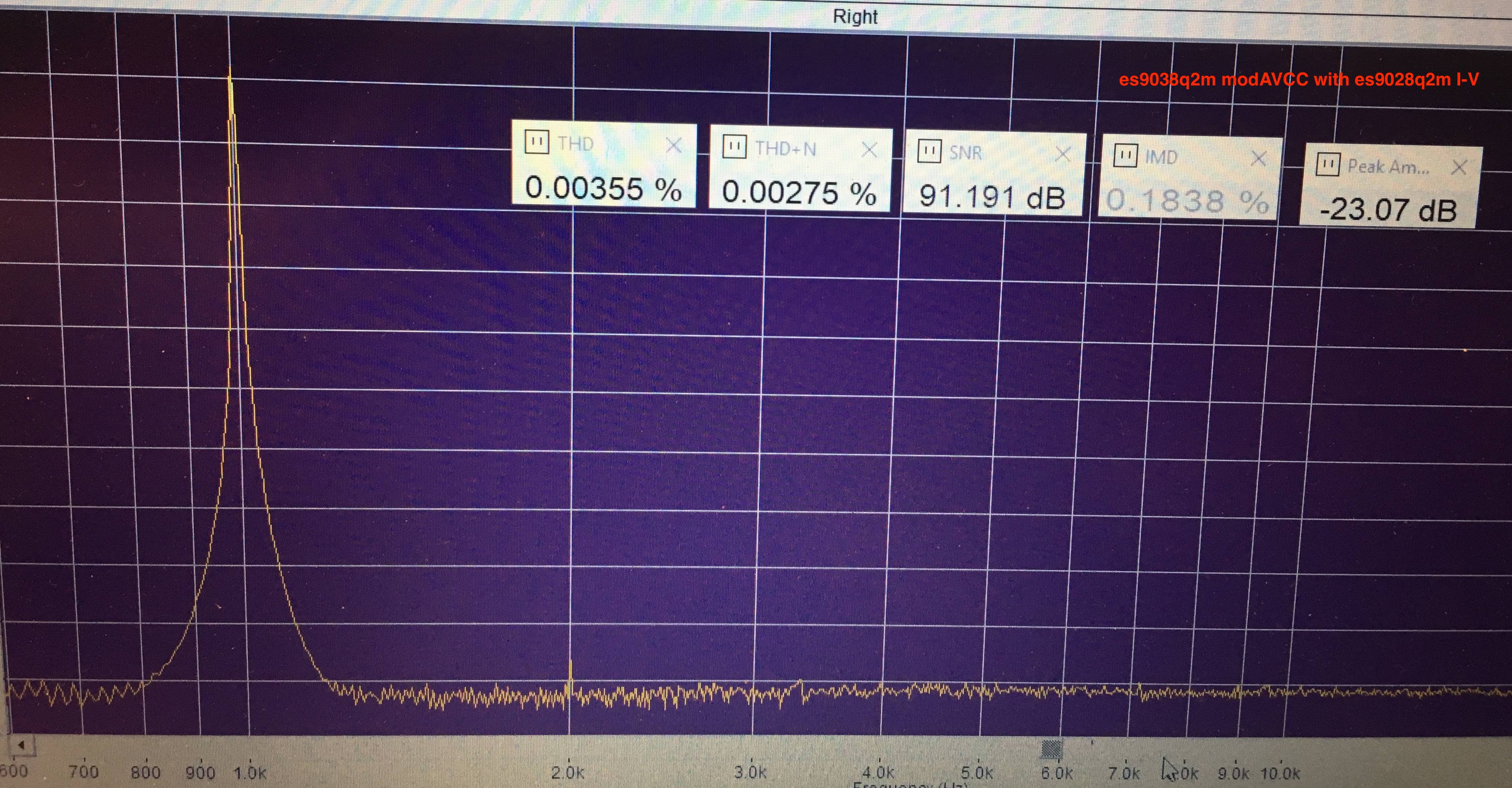

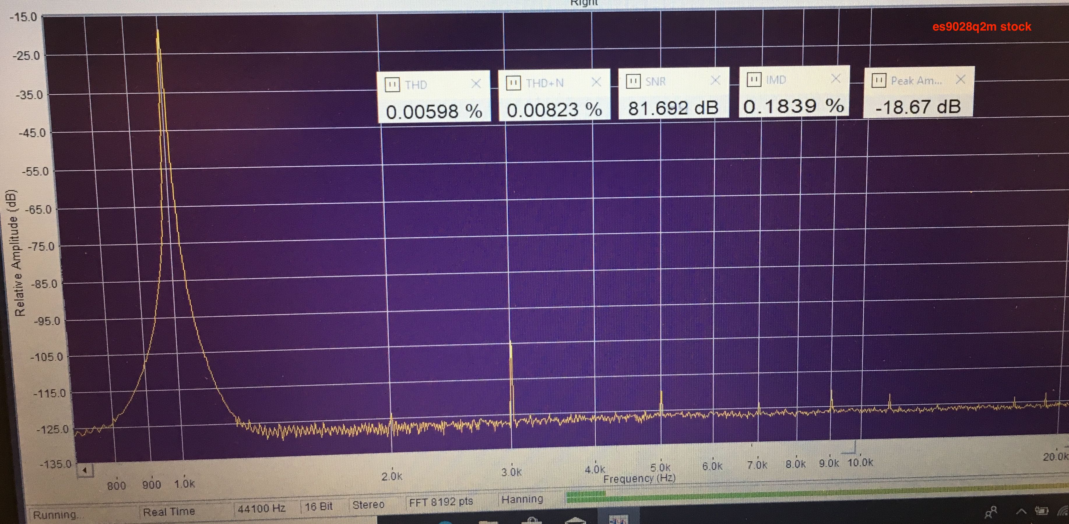

anyway decided to go for the second approach with a different I/V. i have an ES9028q2m board which runs current mode and actually measures better than our es9038 board in stock. still a lot of 3rd and higher harmonics.

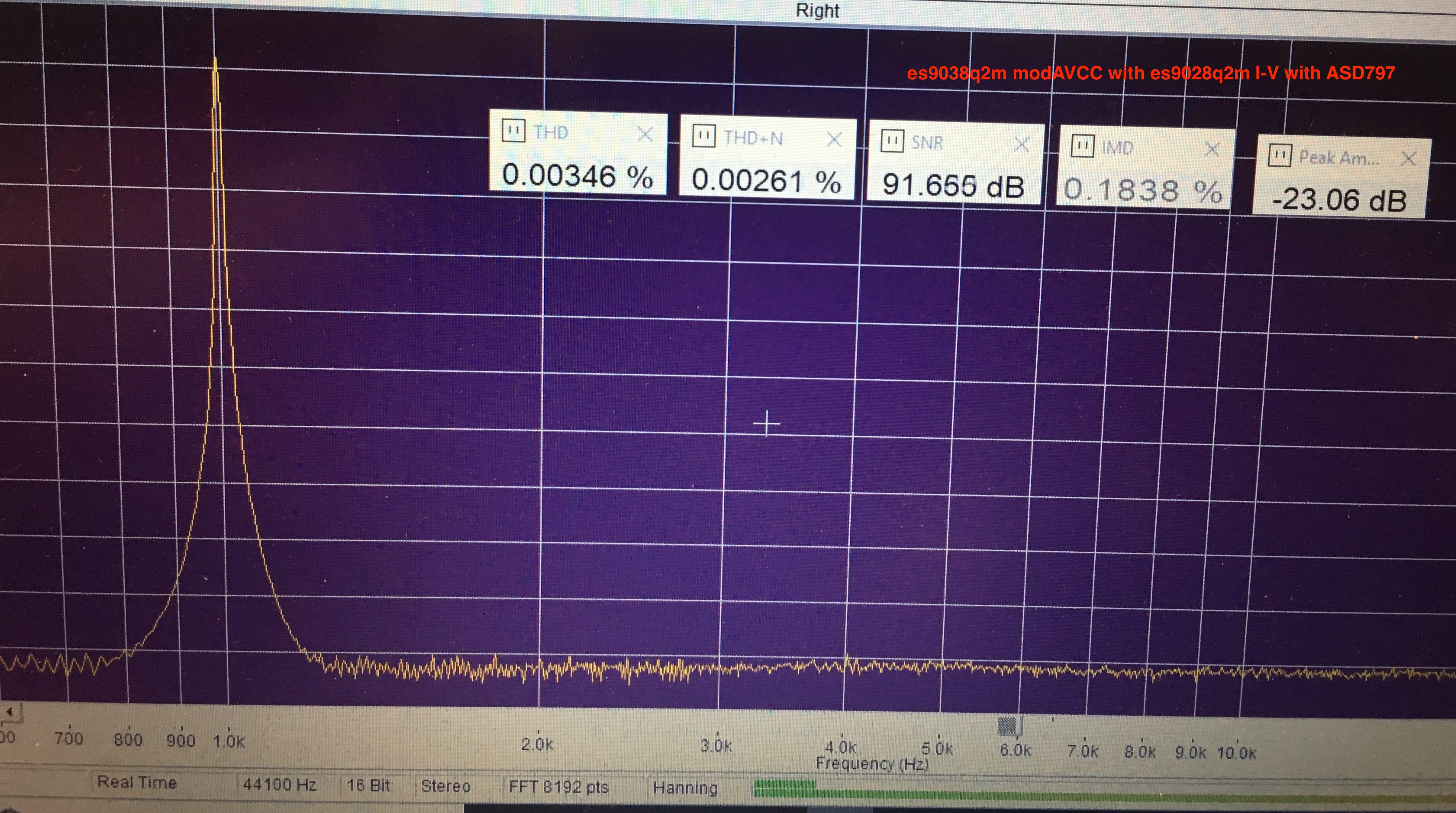

so I connected the DAC output of AVCC mod ES9038 board to the I/V stage on ES9028 board. the 2nd harmonic was still there, but a bit down. it disappears with AD797 op amp in the output filter. so perhaps resistor values are not optimal in this version of I/V. anyway sound is very good now.

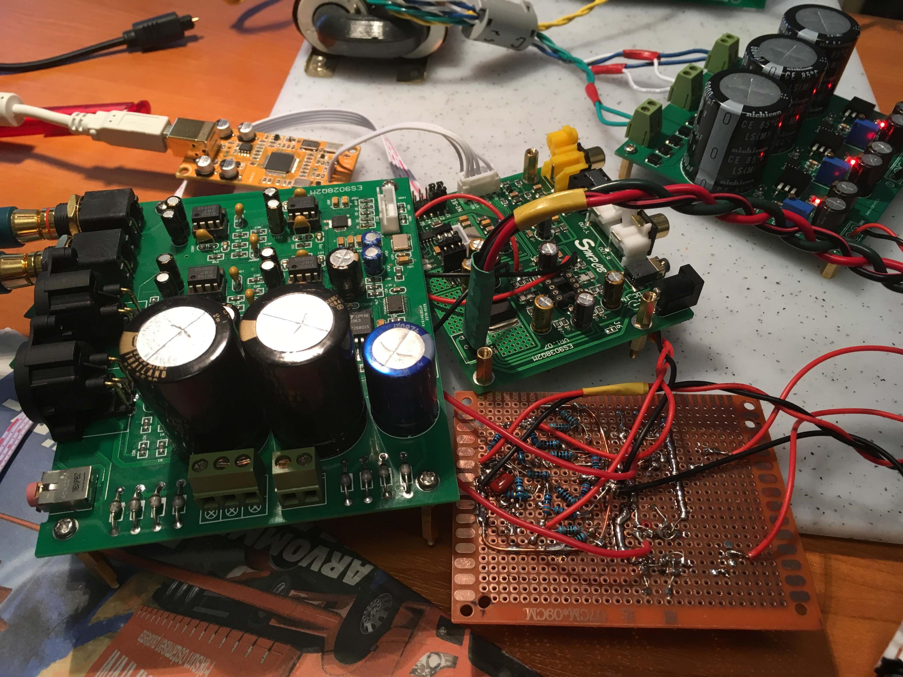

Thanks, Mark! the last iteration conceptionally seems to be similar to yours minus oscillator improvement and I am using I2S (the DAC will get the stream from RPI3). of course TH instead of SMD, different op amps and at the moment all this is just a quick prototype to see how the things work. anyway I can not measure more than about -100dB, so that perhaps is the limit for this case and I am not aiming to match a real HIFI leaving this for 2 other projects in parallel: es9028pro and AK4497.
to me the biggest difference appears how we get appropriate AVCC. yours use an integral LDO reg and an op amp buffer according to ESS design. I trust in simple series regs. they have low impedance over wide frequency range and importantly are good for loads with quickly changing current draw. I believe this technical diversity might be for common benefit.

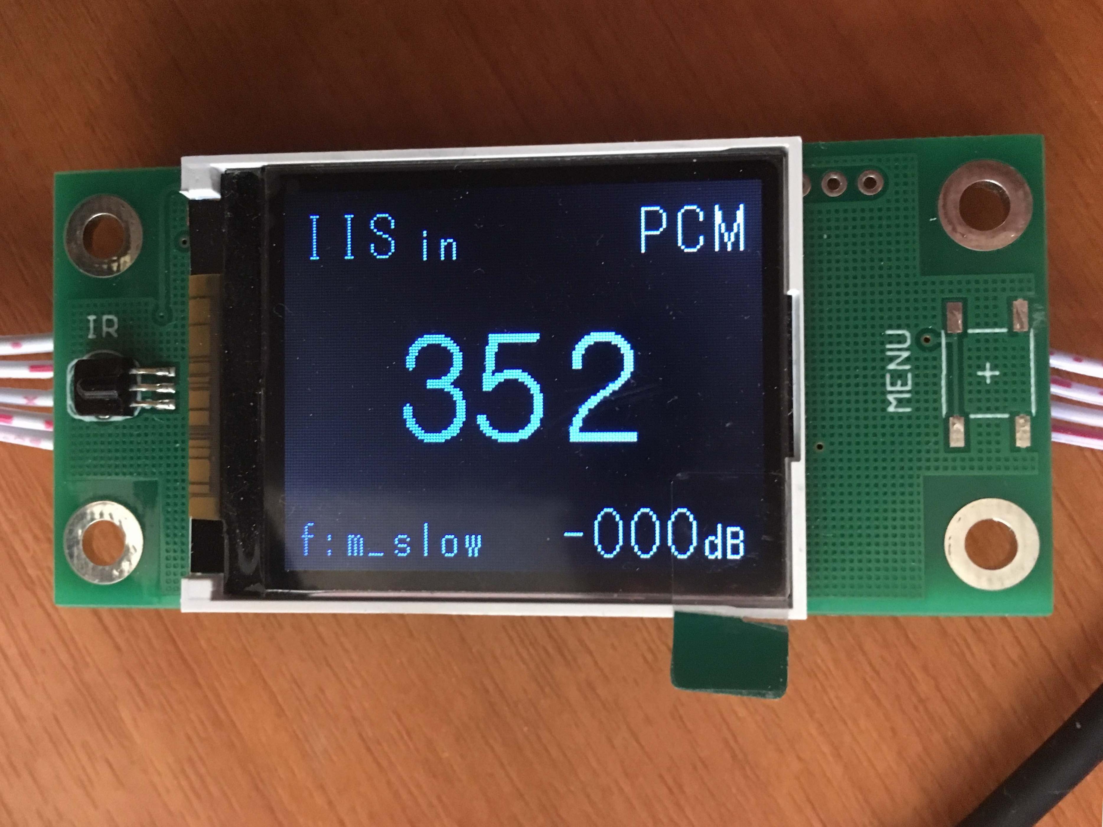

So the current separate AVCC supply is fine for me in this case. for other consumers an integral reg(s) should be good enough. have to decide still which I/V version to use and what about the oscillator. next I have a temptation for a custom FIR filter. that would need an arduino hookup and finding out how to upload coefficients. at the moment I am not even sure that is possible on a mobile chip. but that most likely deserves another thread to discuss.
Custom coefficients are possible with mobile. However, I suspect it would do the most good if using SRC in which case a large transition band could be leveraged to minimize group delay and ripple in the audio band. Doubt anything could be done to prevent filter clipping though, probably need external DSP with more headroom to fix that. Also, if using internal filters only a couple of topologies to choose from, although maybe good enough in that respect. Otherwise, I doubt they didn't do what they could to optimize filter choices for use cases not changing the frequency landscape in ways such as can be done with pre-DAC upsampling.
