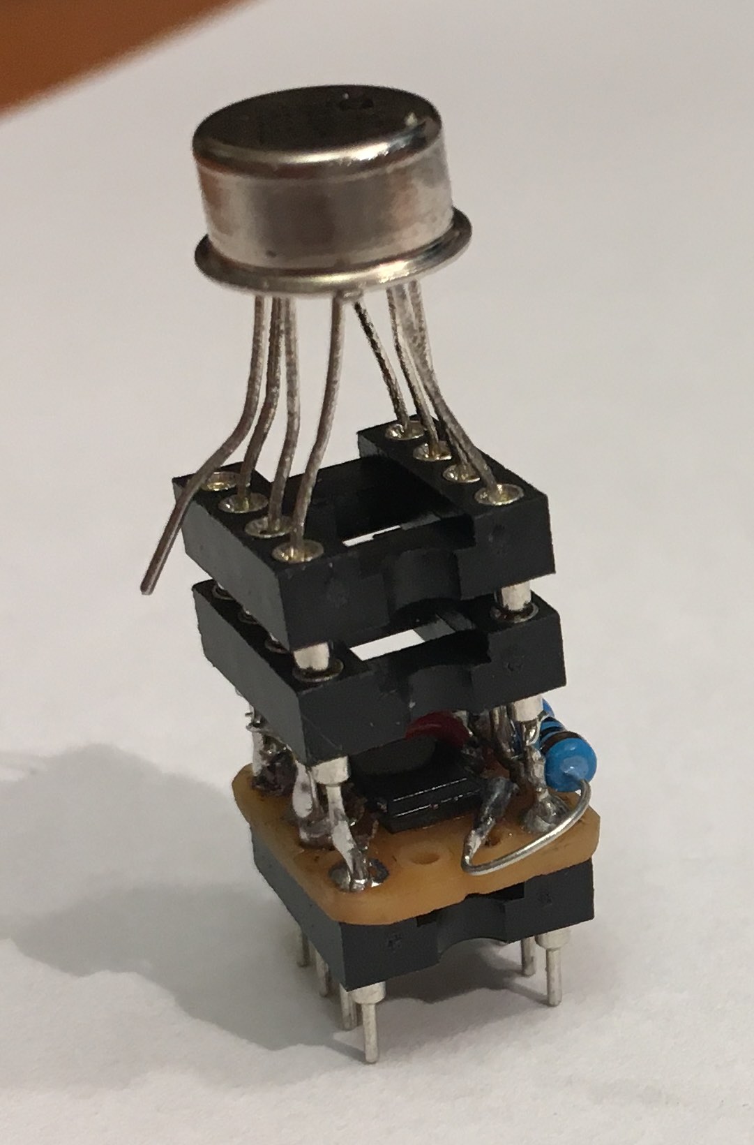

Also, I don't want to make an IV board for this DAC until I understand what is going on with my too-warm op amps.
This morning I have been cleaning up my DAC board, restoring the original wiring for the 1.2v regulator. Think it should be fine on the digital 3.3v bus, or maybe fine to leave it disconnected entirely.
I am also adding a little more filter capacitance to the 5v and 3v rails to see what that does. I am using an LT1084 for the 5v regulator (its what I had in stock) and the 10uf tantalum output cap I have on it is very minimal. I want to try a little more while I'm just cleaning up a few odds and ends that are not big problems, but they maybe aren't as good as I think good practice would suggest.
Also, setting up to do a test separating 5v and 3v power from +-15 rails. Just starting to peel back the layers of possible coupling between RF and analog. Could also be through the DAC outputs, probably some HF noise there, but not sure that is all there is to look for. Another possibility would be ground currents and resulting ground plane voltage gradients introducing RF noise into analog circuitry. A different kind of possibility would be radiated RF noise, which I know LME49720 can be sensitive to (like from DECT wireless phone base stations).
Why all this? Because there is no way a differential amplifier with 10k resistors around it and a few k-ohms output loading, and with maybe 4 Vp_p maximum peak output level audio should be very warm to touch. Especially even when it is hardly outputting any voltage. It doesn't seem credible to me that should be normal for this application. Problem is I can't see any reason for it on the scope. So, I will have to try some other things to narrow down the investigation.
Given all the above, laying out a board is not my top priority right now. If somebody else wants to start working on it that would be great. Download the free Eagle PCB layout software and read the manual. (its not really free, you pay to have them make boards, or pay them to convert the layout files to Gerber format so you can have someone else make the boards). Or, use the app of your choice if that sounds better.

This thought was somewhat confirmed by exiitis with his finding of using the AD797 to reduce the second harmonic was needed.
So my opinion is that this board in practical terms can be modded to fix AVCC with a dual op amp reg and possibly a crystal change and the usual op amp rolling. Taking it beyond that is probably a limted prospect for the person that this DAC was initially aimed at.
