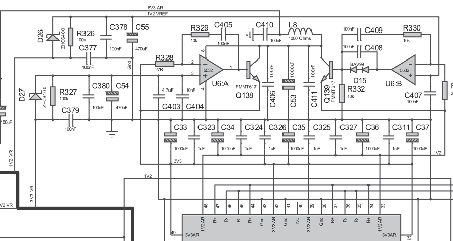

FYI The 9018 has AVCC of 25mA.
I mentioned before there is a service manual for an older version of m-dac out there. Anybody google and look at the AVCC supply? If no, why not? You lazy?
lazy? no. actually I borrowed the idea about series regulator elsewhere, but m-dac uses a similar design.
Thank you. Not just a series regulator though. Lots of distributed capacitance to assure low ESR and across a wide frequency ranges. The series regulator uses full op amp open loop gain at LF, but is frequency compensated for stability at higher frequencies.
Looks like about 2,000uf to 3,000uf total capacitance for each regulator.
A breakpoint is at the frequency where, say, the magnitude of the capacitive reactance of C405 equals the resistance of R329, or |Xc| = 10k. That gives a frequency of about 1.5kHz. Above that, one could say capacitors do an increasingly greater amount of the voltage regulation. Below that frequency the op amp is increasingly responsible for voltage regulation. (I can't see all the resistor and cap values but they appear to be the same for all the regulators, so I will just look at one example here or there.)
Gain of the op amp at higher frequencies, where Xc is much less than 10k ohms, is equal to R329/R328 = 10k/27= 370 (actually -370 because the amplifier inverts). Depending on the op amp used at some frequency its internal gain will fall off to below 370 and that gain will dominate the loop gain.
The gain at various frequencies has to be limited depending on op amp and load to keep the regulation loop stable and free of oscillations. Aside from that more gain should give better regulation. So, we want the most gain we can get while maintaining stability, or at least enough to get the DAC sound quality to the best it can be, or that we have otherwise set as a goal.
The above is a quick take on regulator loop operation by inspection. A better and more accurate model could be obtained, say, by simulation.
Besides linear stability of the regulation loop, there is also some non-linear behavior to consider. The op amp may current limit, say, when the caps are first charging up. During the transition from current limiting (which will slew up the cap voltages) to linear operation, we need to make sure the op amp will make that transition smoothly and without gain/phase and or latchup problems during the transition.
Verification that the regulator works about as expected and that the regulation it provides is adequate to maintain DAC sound quality must be measured and tested after building it.

In the case of our simple ebay ES9038 board, which I think we should probably try to confine ourselves to here as much as practicable, it is the DAC chip itself that pretty much determines the best it can do. For this chip, the recommended ESS circuit seems to work at least up to 192kHz, as that is what mine was running at when testing at Richard Marsh's place. I don't know if it can supply AVCC current above 192kHz or for DoP and DSD. Somebody who uses those modes would need to measure. Then we can get on with this.
Right now we are spinning our wheels, so to speak. We are talking about something where we don't know what we're talking about, which is to say, we don't know what it takes to supply AVCC current above 192kHz because nobody has either (1) measured it, or (2) carefully tested DAC performance with some particular AVCC circuit at sample rates above 192kHz.
In addition, I can confirm that my DAC that was measured is running a 100MHz clock, and that the DAC board microcontroller does not program the Q2M to divide that frequency internally to reduce power consumption. Therefore, the DAC board was presumably drawing full AVCC current for 192kHz sample rate. Only thing I don't know is if turning the volume knob has any affect on AVCC current. We did have to turn the volume down a little to match the calibrated input level of the distortion analyzer.
... Right now we are spinning our wheels, so to speak. We are talking about something where we don't know what we're talking about, which is to say, we don't know what it takes to supply AVCC current above 192kHz because nobody has either (1) measured it, or (2) carefully tested DAC performance with some particular AVCC circuit at sample rates above 192kHz. ...
sorry Mark, I am getting confused indeed what we are talking about? the only point what I am trying to make is, that simple changing of LDOs to better low noise according to the datasheet in this particular implementation will not provide an improvement.
the 0dB 1kHz sinewave I measured was PCM 352kHz. of course, not the current consumed was measured, but the effect of LDO (AMS1117, LT1963, LT3045) and a series reg on THD with everything else as in original. virtually no effect changing LDOs, some -6dB drop with an op amp reg. I believe all of them can provide current enough, so why such response? from the practical point to view to improve the DAC it is irrelevant, just take what works better. still, I have a hypothesis: LDOs alone in the given implementation do not provide sufficient voltage stability due to load transient responses. So where then these load transients may come from? I guess from the high frequency switching upon code-current conversion inside the DAC. according to the info available on this forum "the output of each DAC consists of 64 MOSFET switches, and each MOSFET switch has a resistance of 50k Ohms".
so concluding, to troubleshoot this, one may need to support the LDO with a buffer opamp as you have done, or build something similar like in M-DAC ...
