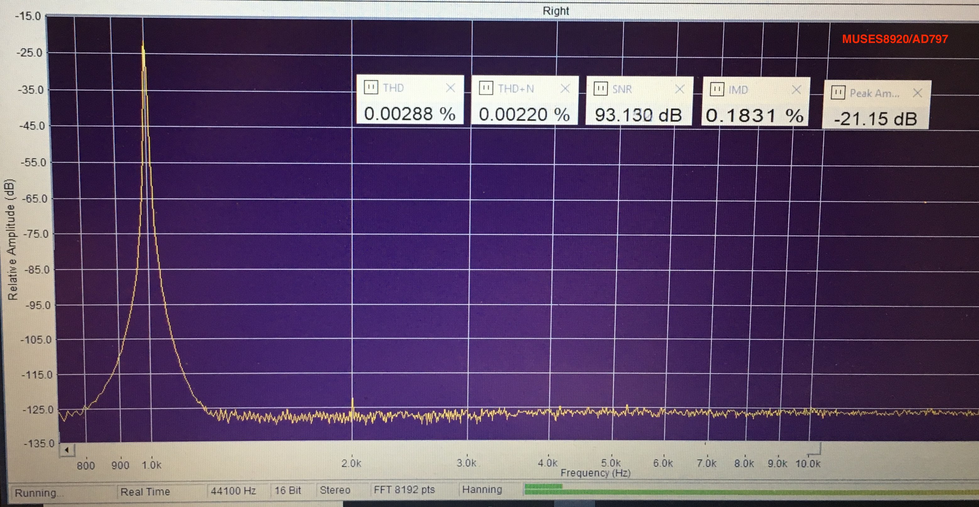

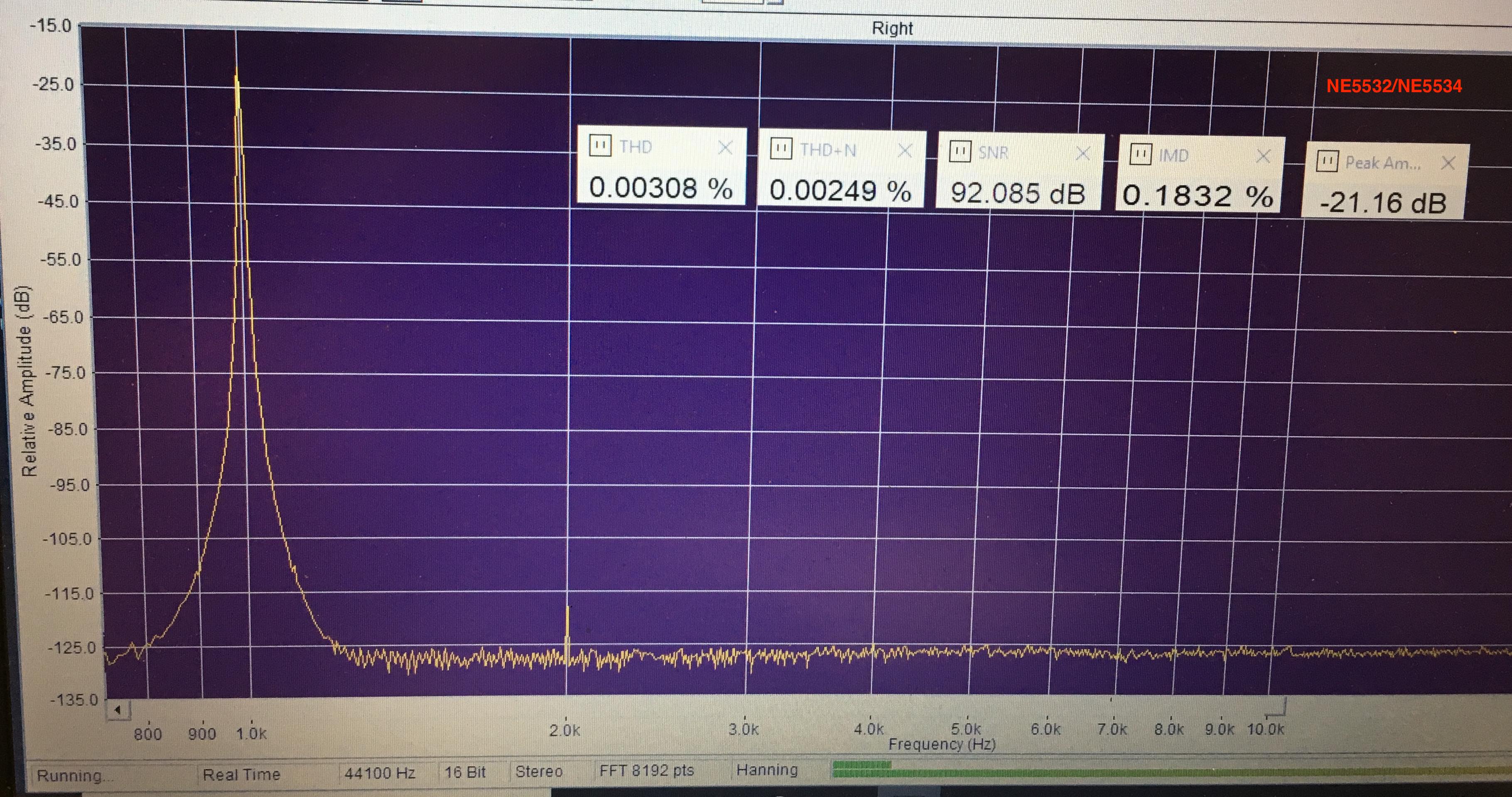

Also on Page 15, there is something that could be considered. That is distortion increases generally in these low current op amps as current output requirements rises. It indicates that paralleled opamps gives less distortion than using a single one when it is driven hard. Hmm.... ideas for the AVCC regulator here ? I knew I saw this somewhere and that is about 24 years ago!
Also a nice discussion of the AD797 that Eziitis has shown to work well and ESS recommends it as well for a reason. Page 16. Some thoughts for possibly more improvement.

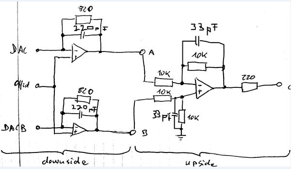

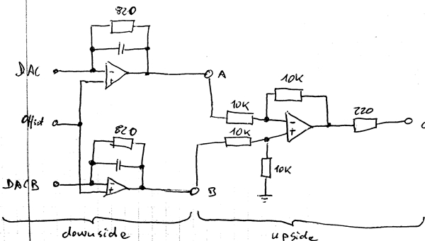

Hello Mark,
I tried to figure out your circuit for output stage from your pictures. Is it correct like below? What cap values did you choose? Could I use film caps here as well?
It looks more simple than the ess recommanded circuit - there are no filter caps on upper side (sum-opamp circuit) and also no caps between the outputs of i/v converter stage - any reason for it?

Yes. The IV stage caps are 220pf, COG dielectric.
More recently I added two 33pf COG caps to each the differential amp stages. The is one cap from the non-inverting input to ground, and one from the inverting input to the output. Standard locations to roll off a differential amp.
In addition, I should probably mention that I have noticed my opamps getting warmer than seems reasonable. I suspect but don't know they may be getting some RF into them, maybe through the power supply. I am planning to run the digital circuits from a separate power supply as an experiment to see what that shows. Also, thinking about programming the Q2M to lower its clock speed with an internal divider to see if that has any effect.
In short, I think the basic circuits I used should work well and not run too hot. They are fairly similar to the corresponding ESS recommended circuit except that ESS does more HF filtering at the differential amp stage to reduce HF noise coming presumably from the DAC outputs. They don't do the extra filtering for their differential analog outputs though, which makes me think it may not be essential. That being said I would probably recommend their circuit over mine with respect to the additional filtering. It's not a bad idea, I just didn't do it because I had precision 10k resistors in stock and not the other ESS recommended parts.
I expect I will probably figure out whatever is going on with op amp temps fairly soon, but for now the project remains a work in progress. It may be by the time I get to power supply recommendations I will include some other new considerations that I don't know about yet.

This thought was somewhat confirmed by exiitis with his finding of using the AD797 to reduce the second harmonic was needed.
So my opinion is that this board in practical terms can be modded to fix AVCC with a dual op amp reg and possibly a crystal change and the usual op amp rolling. Taking it beyond that is probably a limted prospect for the person that this DAC was initially aimed at.
