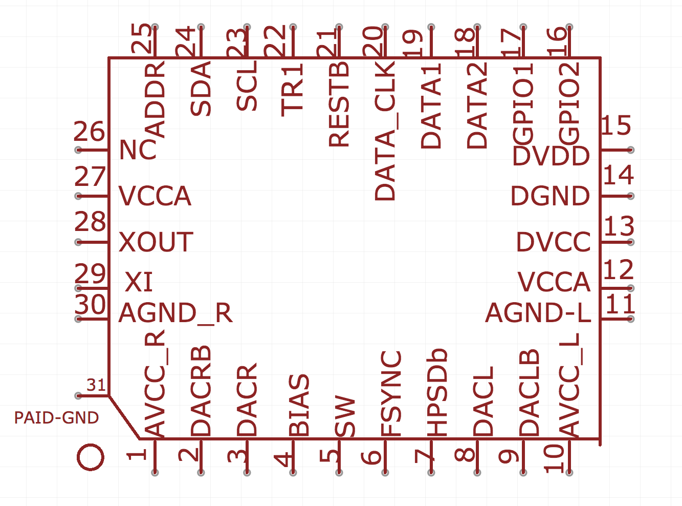

Exactly how many power supply for the q2m chip. I counted at least 3, 2 x 3.3v and a 1.2V. There is very little info on the pins for the es9038q2m.
1. VCCA 3.3v (at two different pins)
2. DVDD (internal regulator, only needs decoupling)
3. AVCC_L (needs ultra-high quality power per ESS application note)
4. AVCC_R (needs ultra-high quality power per ESS application note)

2. DVDD pin is powered by external 1.25V LDO (v 1.04, 1.06). Blue board has only the solder pads for LDO, no LDO on green ver 1.07 (internally generated)
5. DVCC 3.3V pin13
Right. I missed DVCC, thank you. It can be +1.8v to +3.3v. The difference between DVCC and AVCC is that DVCC powers digital circuitry, whereas AVCC powers analog for osc.
Regarding DVDD, 1.2v nominal, although there is a an external regulator on some of the boards, Q2M DS says there is an internal regulator. Don't know why they put a regulator on some boards. The old ES9018 may have needed it.
