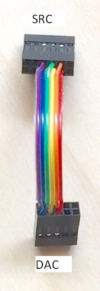

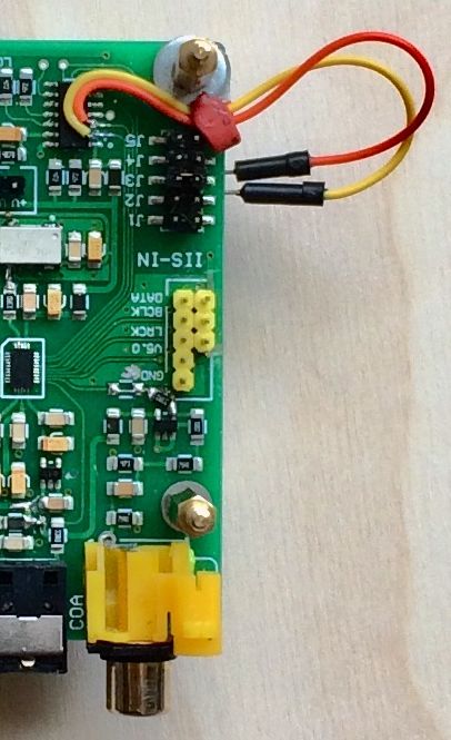

Connected to DAC board using I2S, 32-bit. At first found I2S with this setup only worked up to 352kHz, so decided to work on that issue.
Added a row of ground pins on the DAC board next to the I2S Data, BCLK, and LRCK pins. Made up a short, maybe 3" double row ribbon cable to connect SRC and DAC. Every other wire is a ground wire, so more of a controlled impedance interconnect now between the two boards. Now works fine with sample rates up to and including 960KHz, which is the highest it could possibly go. Just goes to show respecting RF principles can pay off quite well.
In anyone is interested I could post some pics of how to do the RF interconnect and extra ground pin mods.

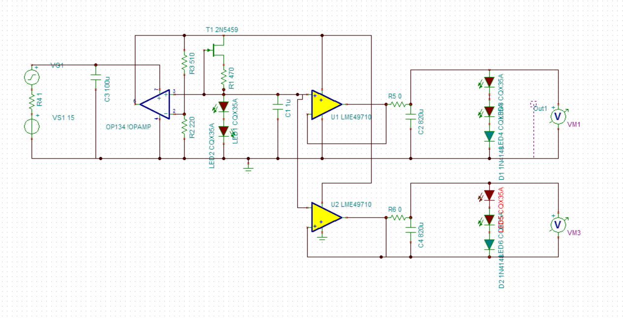

Hi All,
As I announced that I would open a new thread for AVCC power supply. I built the enclosed circuit.(FET is 2SK170BL - not as on the drawing)
The sound is great. See the 66 and 70 posts in the thread:
http://www.diyaudio.com/forums/digi...d-ultra-low-noise-vref-dac-7.html#post5456963
bb.
Just to mentioned I called it 00Reg .

Some pictures showing how the DAC I2S connections were modded to work with the SRC at high speed in order to get the highest sample rates working.
It is not necessary to add pins and sockets, rather ribbon cable could be soldered in place. The idea is like old PATA disk drive cables, every other wire is a ground conductor with each one individually connected to the ground plane at the board on each end. That way it acts much like coax cable in the the RF transmission line sense, although likely with a little less capacitance. It helps to keep the waveforms of the fast clock pulses and the data signal from becoming distorted across the interconnect.
