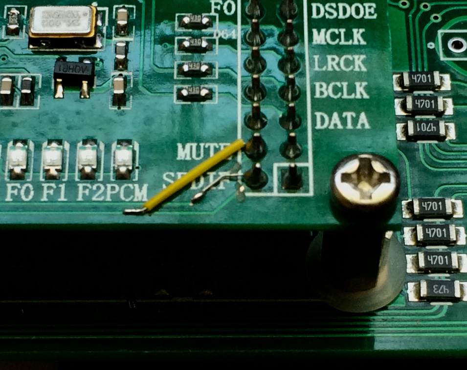

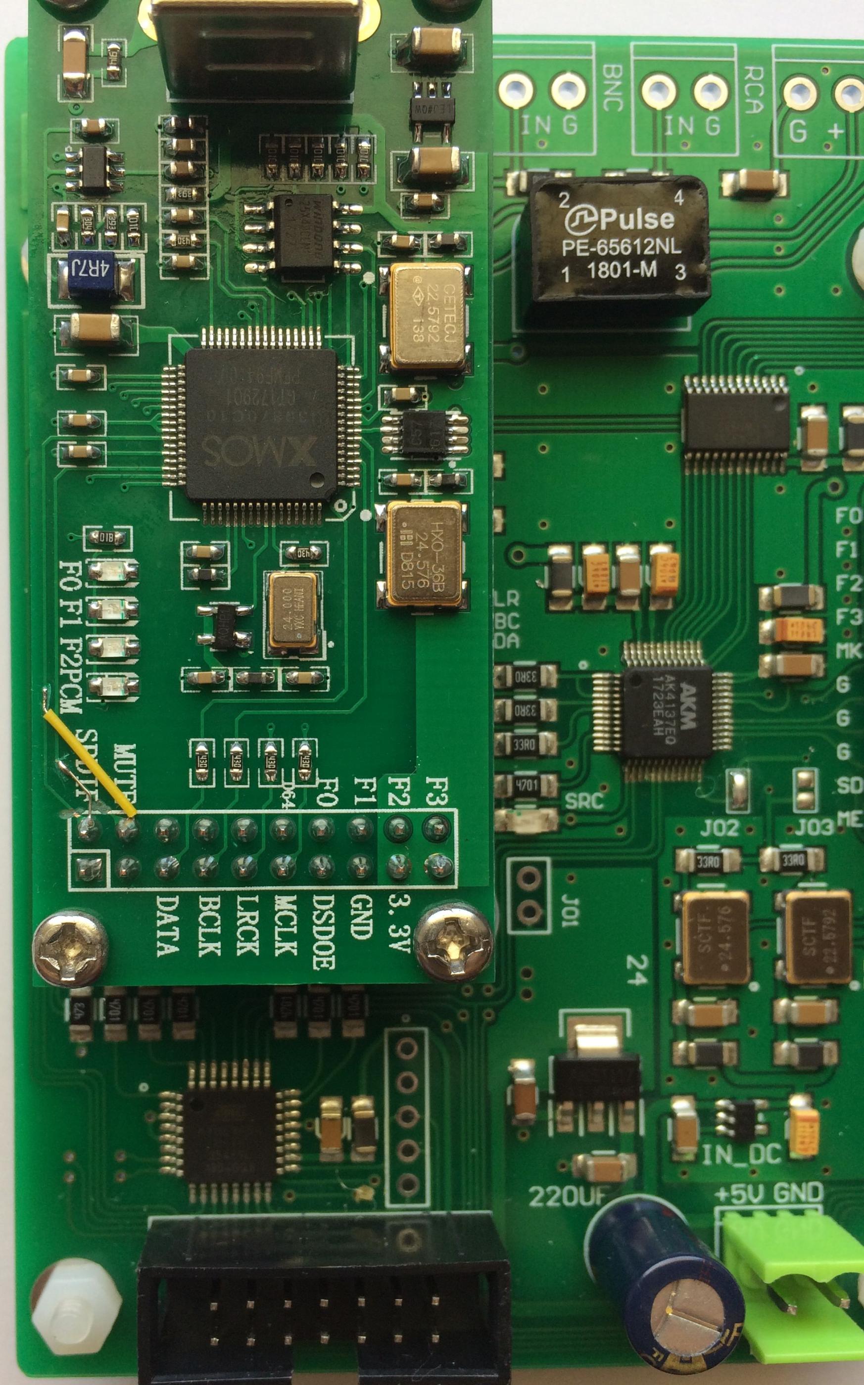

Found a problem with the XMOS USB to I2S board that attaches to the SRC as shown in the previous post. Turns out XMOS board has a SPDIF output which I like and want to keep, but they put it where the SRC board is expecting the mute pin to be, and where it would be on an Amanero USB board. Turned out the safe fix as far as the SRC board goes is to swap the two pins on the XMOS board which was done as shown in the pics below.

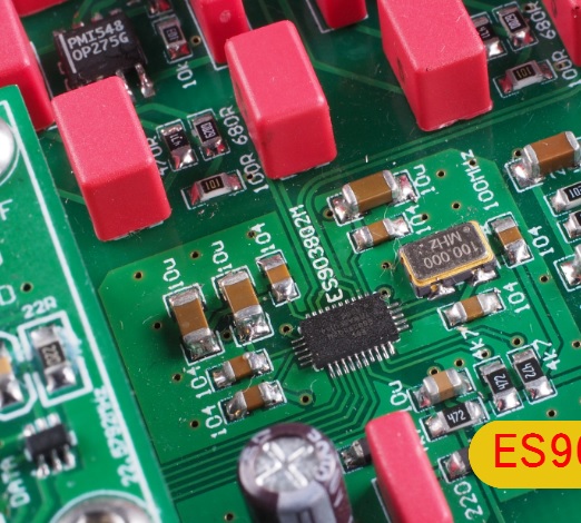

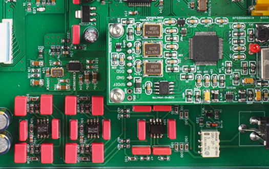

Looks like it has more output stage opamps that just one, maybe 2 or 3. That could be enough for possible I/V conversion. Need to see better pics or see one in person to know for sure.
The DAC has one NE5532 on socket. There are more SMD nearby which could be opamp too. Hard to tell what they are and the function. The TPA6120 headphone amp IC is a good feature for the $199 model.
I like the one I got so far. At $80 less and has more room for mod.
