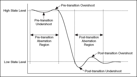

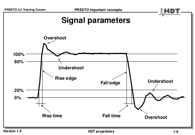

It depends. At high frequencies clocks start to look a lot more analog than digital, at least in some ways. A couple of the bigger factors include slew rate into capacitance (how fast can a device charge up a particular load capacitance), and however much the voltage needs to swing before a high or low level is considered to be arrived at, which would be whatever the load device needs.
Roughly speaking in this situation a 2ns spec is good. However, at 100MHz, one cycle takes 10ns. ESS would like to see 4.5ns high and 4.5ns low. That leaves 0.5ns for each edge transition. By that reasoning Crystek should fail to meet the spec. Various possibilities exist. Maybe Crystek beats their spec into the whatever the Q2M load is. Maybe at some voltage level Q2M considers the edge transition complete when the level has changed by only 200mv or some small number, I don't know. Maybe some other possibility. Hard to say without some work and some test equipment.

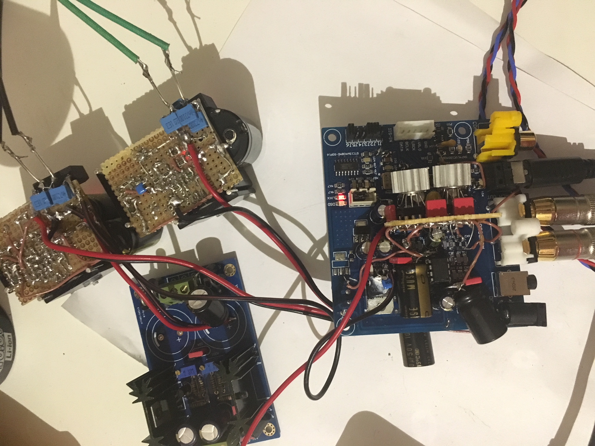

the circuit in the post 1294 is what I finally use. It automatically sets the DAC into current mode. Nothing else to do to achieve that.. The left part of the circuit is on the bottom side on a seperate board while the right part was applied on the top side by modifying the existing circuit (replacing all components). What you dont see on the pictures are the vertical 6K8 resistors where the outputs of bottom board are connected to the circuit on the top side..Also be aware of the exact polarity of the opamp inputs. Pls ask if you have any further questions.
Hi Freezebox, All

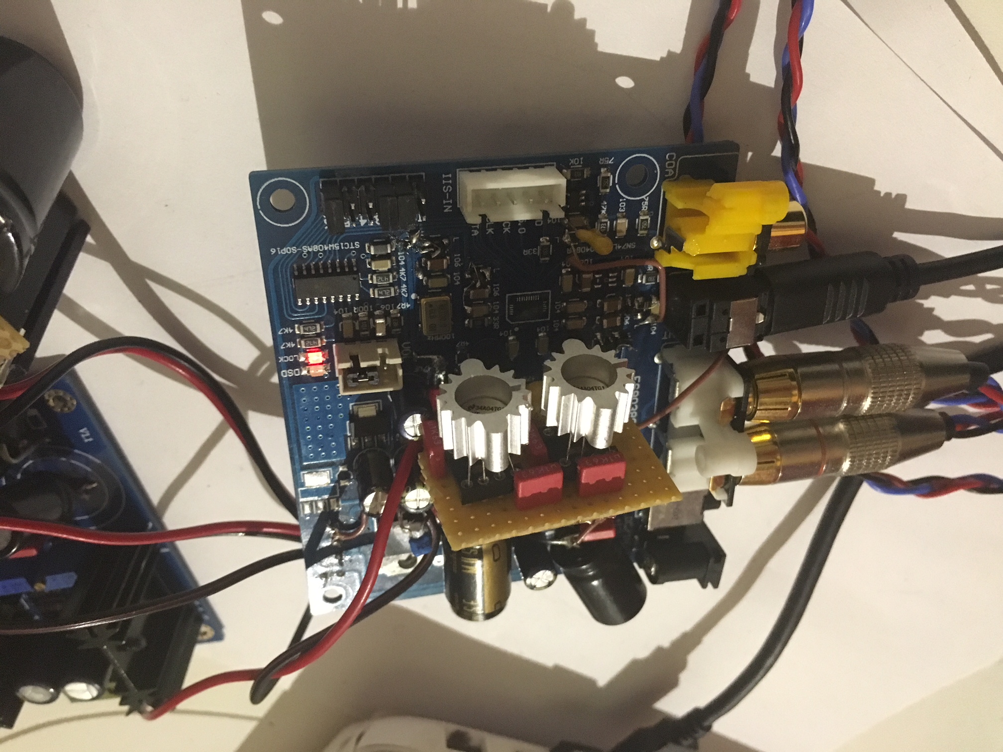

I have done the I/V stage. Although not 100% copy of your circuit. Since I'm lazy I used the LP filter stage which was on the panel, and added the I/V stage according you schematics. Thanks it works fine.
In the I/V stage I used the LME49720. and since I didn't have at home more I used in the LP filter stage OPA2134 - will be change to LME49720 too.
(some advices can be found here also: https://www.by-rutgers.nl/IV-converter.html)
So the current status summary of all MODs I've done:
1) I/V stage
as described above
2) AVCC_L,R
I powered them with an OPA based solution. Described here OPA based Ultra Low noise VREF for DAC more detailed in post 70.
3) Power supplies
- All the panel's power supply is separated with LP5907 and this is powered with a LM317+TL431 modul
- the controller remained on the 7805 (separated)
This 2 were described in this thread in the post 1306
- The I/V stage with the LP filter and the AVCC OPA based REF are powered from a SALAS shunts v1.3
4) CAPs
- I changed the important power CAPs to Nichicon MUSE types.
5) Upsample
- I ordered the upconversion unit, suggested by Mark based on the SRC4392
(this not yet arrived yet)
I do not intend to replace the clock - according some posts here it can further enhance the voice, but maybe not too much comparing with the above described MODs.
So thanks again for your inspirations and helps. Since I'm satisfied with the voice I really stop here the moddings on this panel. I will try to find a box and will put my ugly panel into it.
See some more pictures. Not nice, but sounds OK.

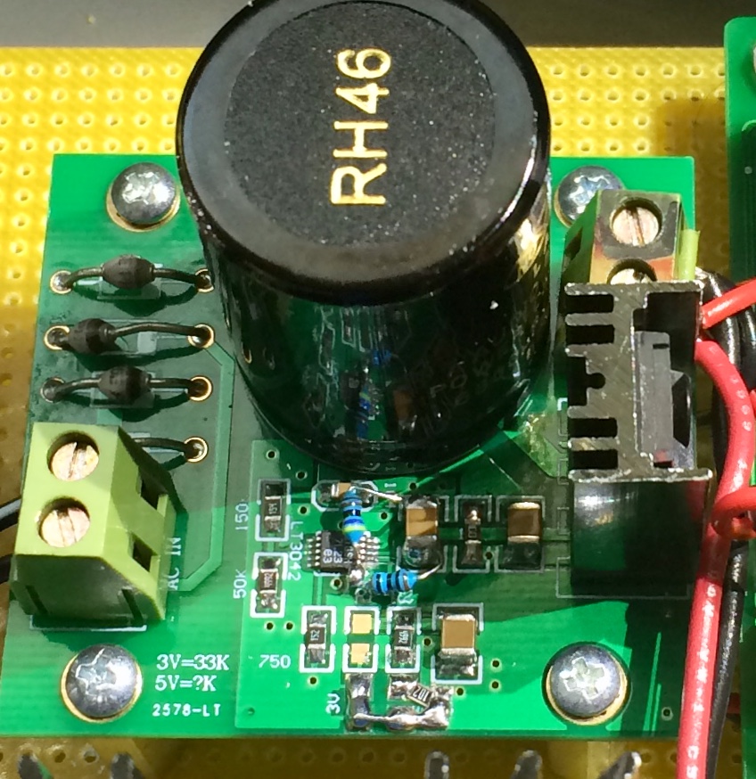

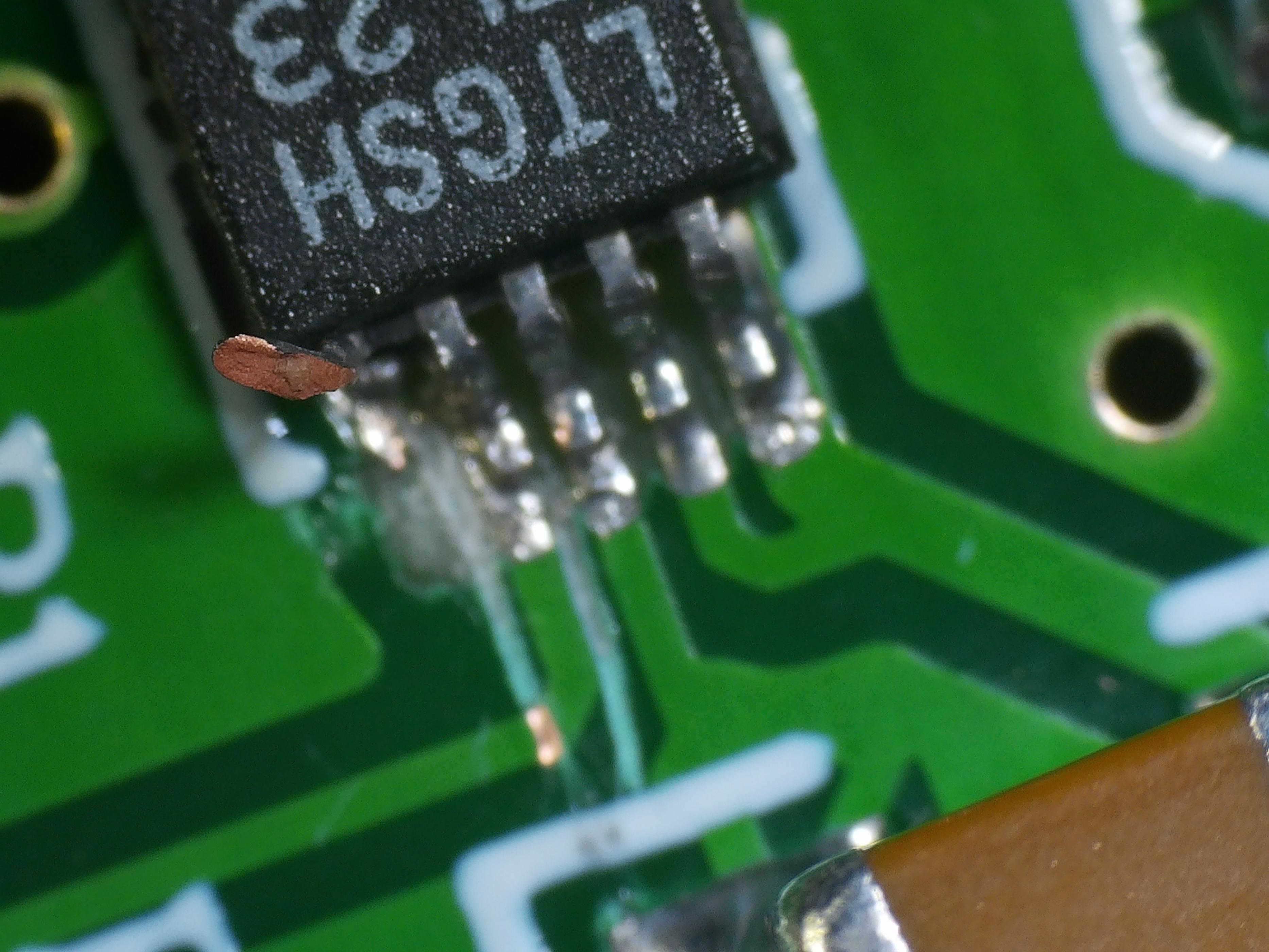

As a part of some testing with all the various DAC boards and digital audio connection options available I was going to try running all the 5v supplies from one 5v power supply. Had an LT3042 board that was no doubt overkill but should work at least to do some testing.

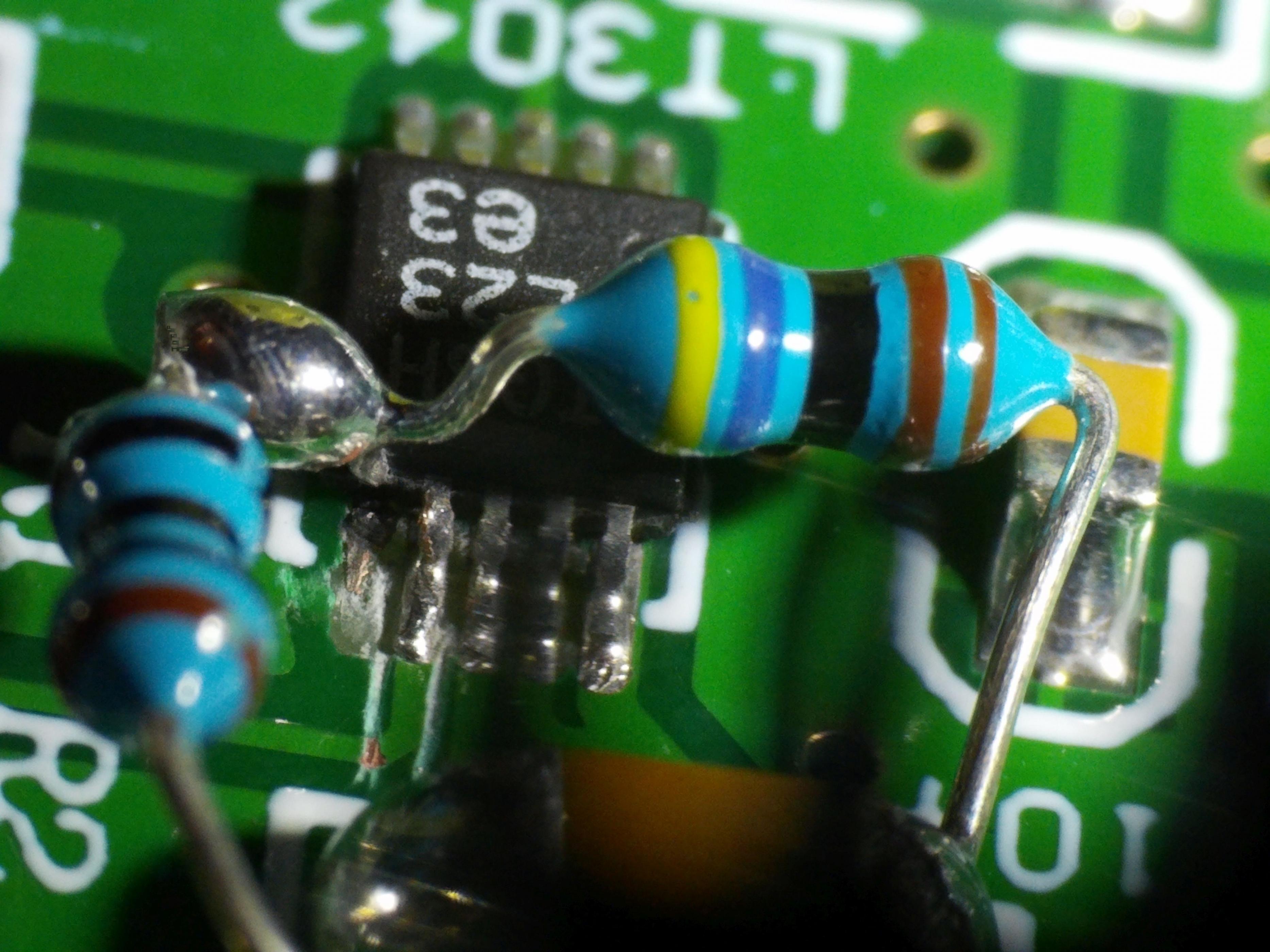

Turns out it didn't work with the AK4137 SRC board which hung at boot when powered from the LT3042 board. Turns out the 5v was coming up too slow for the SRC board microcontroller to boot properly. Needed to do something to get it working so decided to try modding the LT3042 board for fast-start operation.
That requires connecting 2 resistors to pin 6, which was found to be connected to pins 1 and 2 by a trace running under the chip. No easy way to get at the trace so decided to try lifting pin 6. First removed big filter cap on board to create better access to the chip. Must have tried a little too hard when lifting the pin with an Exacto knife because it popped up rather suddenly and pin 7 loosened slightly. Have to be more gentle next time. Anyway, re-soldered pin 7 and connected 2 resistors to pin 6. Fast start now works very quickly, and AK4137 board boots right up with no problems. Pics below.
The LT3042 as configured is for 5v, not 3.3v. Also, 1.5A or whatever amps seems like even more overkill to use for AVCC when it comes to an ES9038Q2M.
