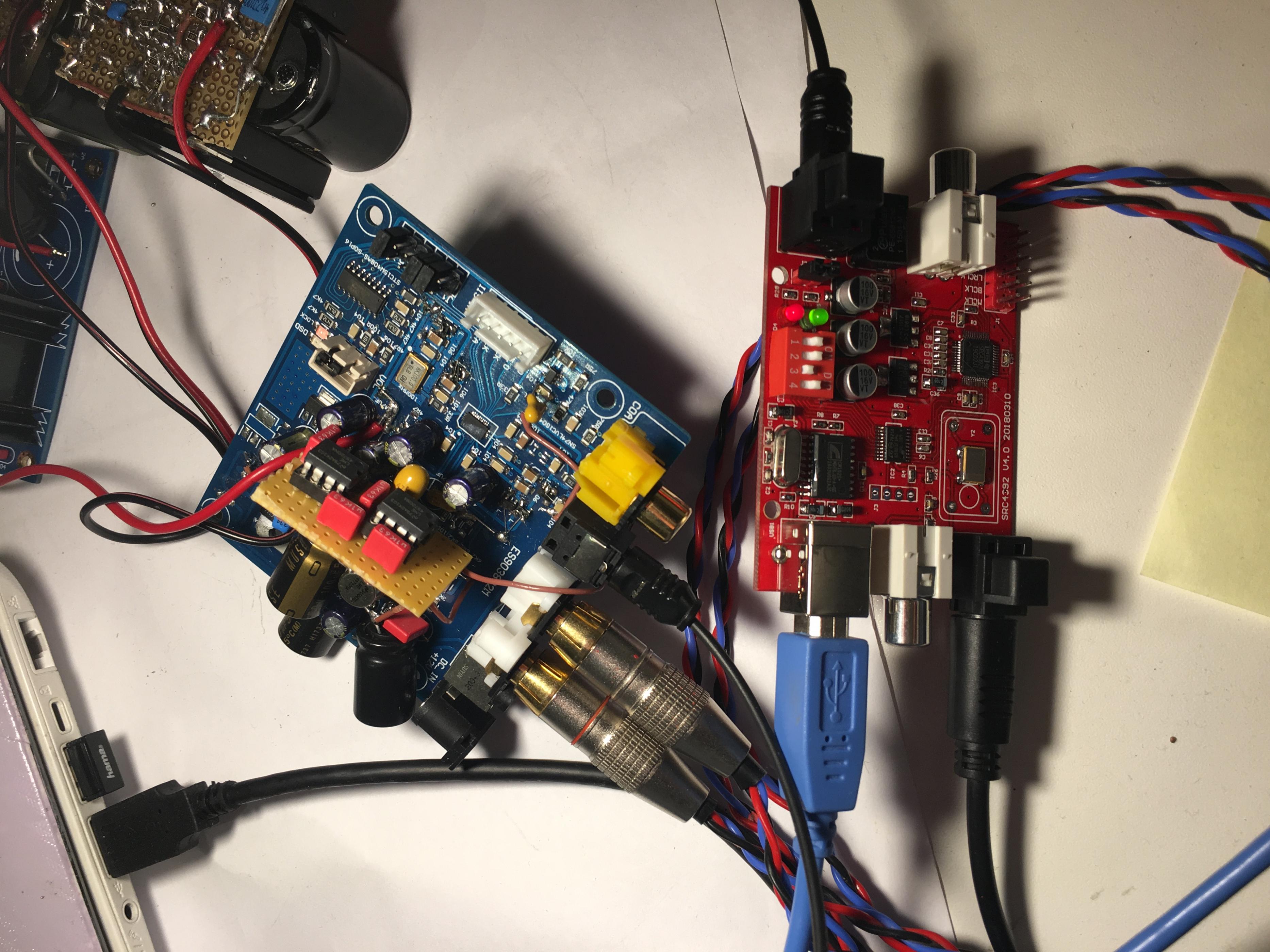

Good News i received the src4392. And also some components from mouser. So on avcc I can replace the several small caps to Elna silmic II 470uF. And added the up sampler. Like the change in Sound :)

babolcs, Good to hear from you! Finally, someone tries an SRC4392. I like what it does too.
However, shouldn't the switches be set to up, up, dn, dn? If you look closely at the clock on the SRC4392 board it should say the frequency on it. Set the switch for the clock frequency you have. That tells the SRC4392 board microcontroller how to set up the receiver PLL.
Also, if using TOSLINK optical output you should set the upsampler to 96kHz, not 192kHz because optical is unreiiable above 96kHz. Better to use coaxial SPDIF if you want 196kHz out. It may help to know the coaxial SPDIF out on the SRC4392 board is transformer isolated, so no ground loop worries if you use it.

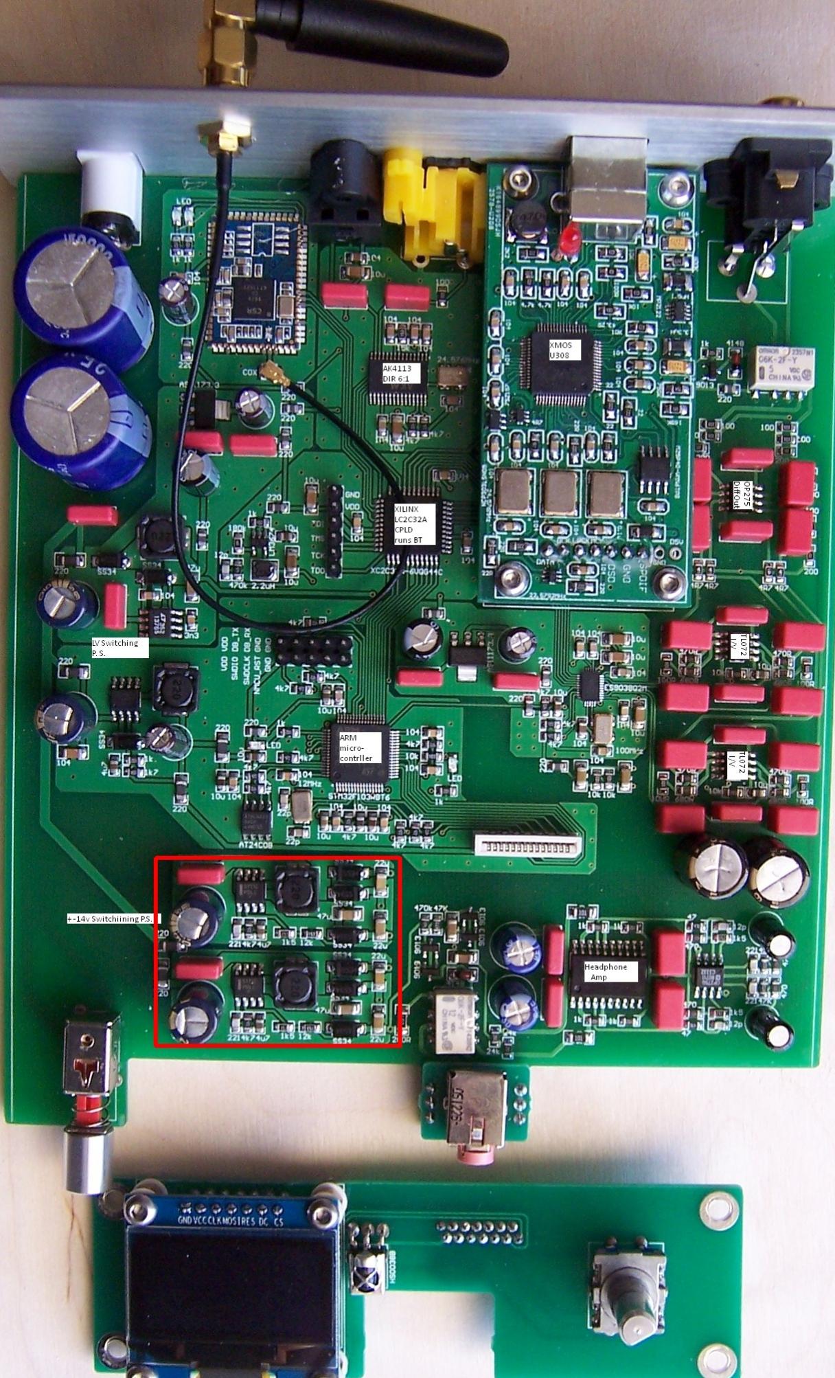

Interesting news. The new ES9038Q2M Chinese DAC arrived today. The fancy new version with bluetooth and IV outputs, all that stuff. GAO su5 ES9038Q2M DAC Supports input Bluetooth 5.0 APT X USB XMOS 208 fiber coaxial highest audio decoding 32 bit/384kHz DSD256 -in Digital-to-Analog Converter from Consumer Electronics on Aliexpress.com | Alibaba Group
It has a built-in headphone amp, XMOS USB board with what looks to be a couple of different sized USB connectors on the back. Just got done trying it out.
It is distorted. What did I expect, right? It runs off a 12v, 2A. wall wart. Looks like it has IV to differential outputs. The headphone output sounds excessively bass-heavy and distorted. Tried the line outputs into my LME49600 HPA, and it sounded bass-light and distorted. The distortion may be a little less than the DAC boards we have been modding so far, but not a whole lot less so.
On the front panel there is a power button and rotary encoder knob that controls volume. Pushing in on the knob actives a switch that selects the desired input, USB, BT, TOSLINK, or SPDIF. That's it. Doesn't seem to be any way to change any other settings. There is a little hole in the front panel that looks like poke-hole, but pressing on what looks like it might be a switch inside doesn't seem to do anything. Maybe there is some trick to it, but so far I haven't figured out what might be.
Looks like the DAC is going to need some work. +-12v or +-15v power I'm guessing as the possible first thing. Haven't measured any voltages inside it yet, though. Will try to get some closeup pics soon so anyone interested can have a look.

Ok. Got it changed sw4 to off.

See some more pictures. Not nice, but sounds OK.

Thought I would follow up with a pic of the boards inside the new DAC. I have labeled some of the parts, but probably have to zoom in all the way to read the tiny writing. Still haven't traced out AVCC, but already no wonder it sounds distorted. Besides the switching power supplies the IV opamps are TL072. Don't know what these guys were thinking since those opamps distort more in to low impedance loads and the IV feedback resistor is more than low enough.
EDIT: Looks like diyaudio has messed up my good quality jpeg by compressing it too much. If it is too illegible let me know I will try to find a way to put up something better. Maybe cut it into pieces.
