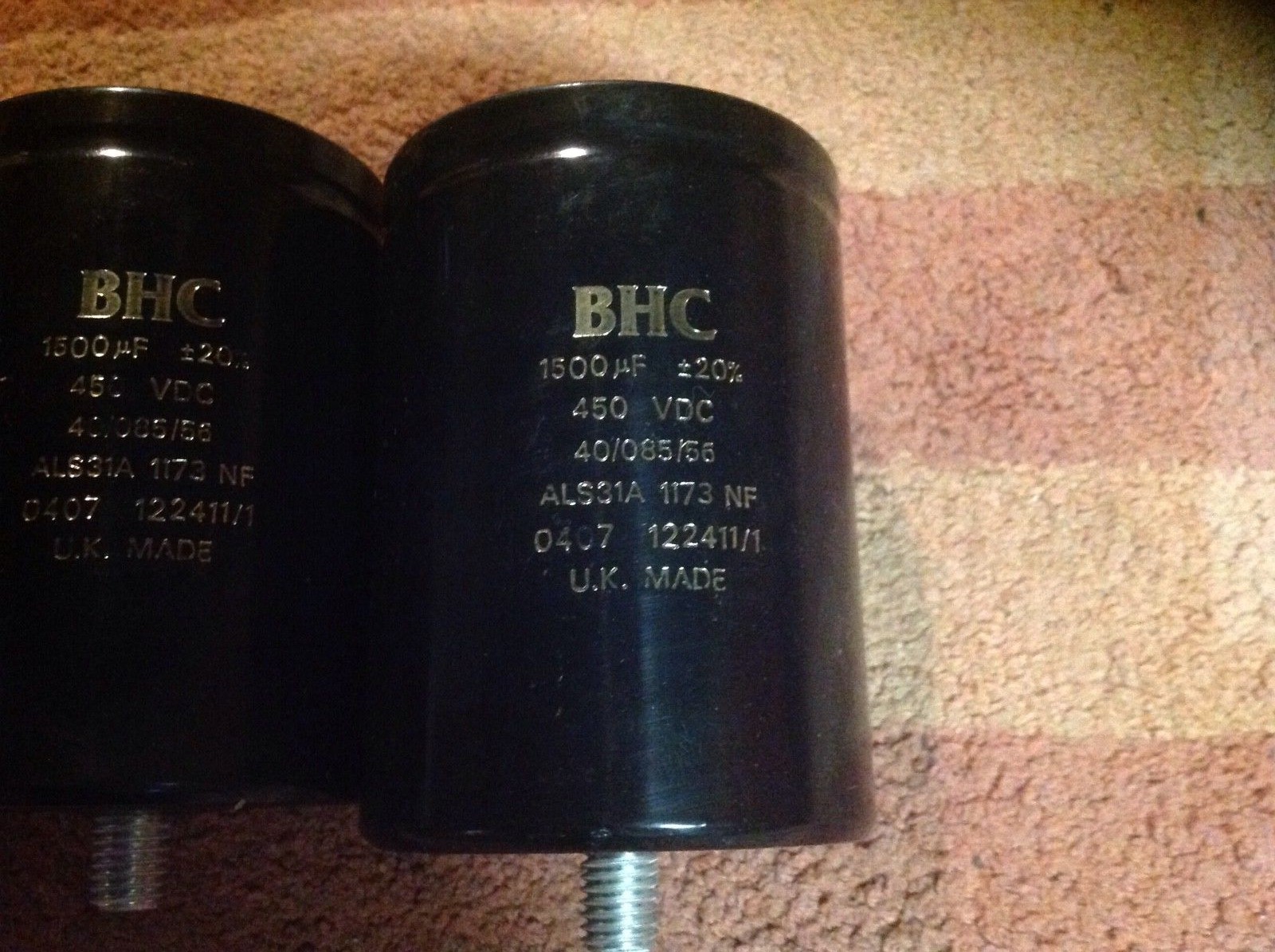

Not exactly ideal for this, those are probably more for tube circuits. 35 volt or 50volt caps would be plenty. You could use them somewhere you need 1500uf aluminum electrolytic at less than 450v though. You could use them for LM317 and LM337 circuits, but usually you need one before and one after each of the two regulators.

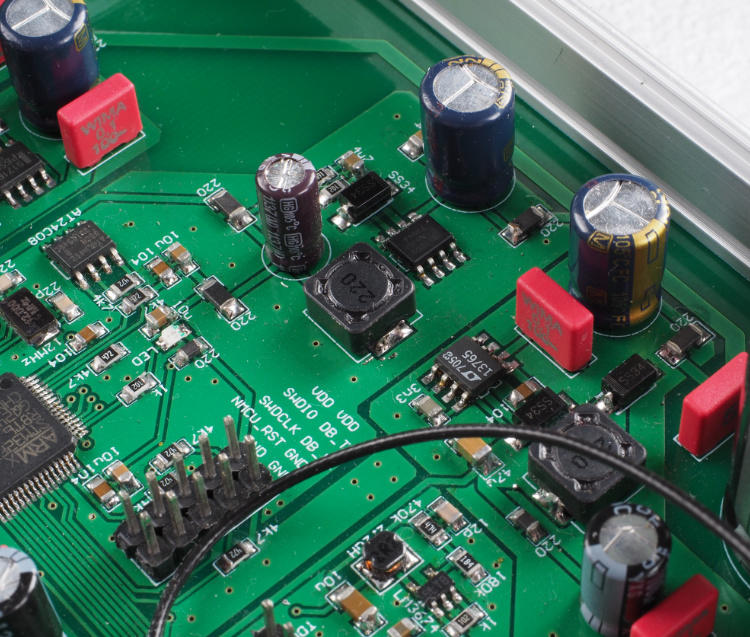

It seems that maybe there are different versions of this board, there are presentation pictures with different parts. Maybe the final product is being sold also with some lower cost parts. I will upload some of them in case you can recognize something useful. Some pages note about specifications:
(So it seems it is a bit different from the one that Markw4 has, different op-amps for example, some reference name codes, nobsound su5, d5, a20 ...? )

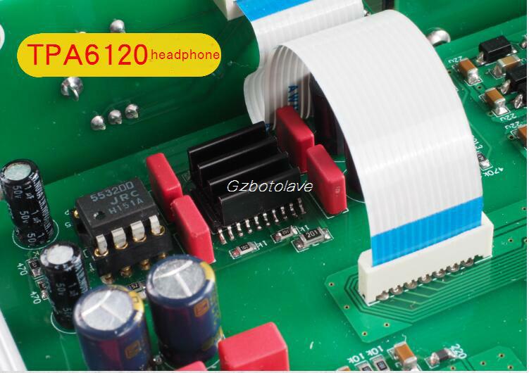

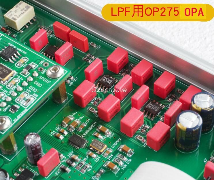

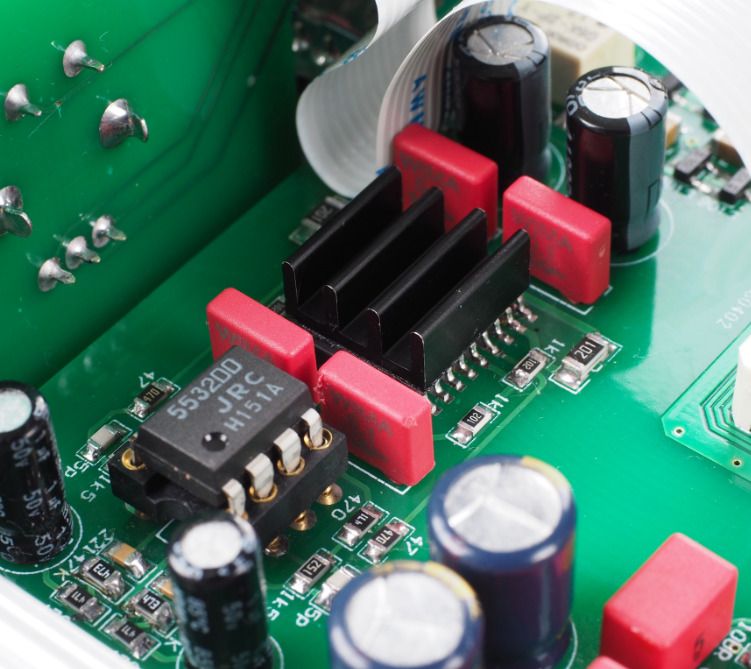

@pentajazz, Looks like there are two versions of the main PCB shown in the pictures. They vary in only one area, the headphone amplifier. The one I have here has a TPA6120A2 headphone amp which is preceded by a soldered-in opamp.
In the pictures that look different, the HPA chip looks like it has a heat sink stuck to it where is says 'Gzbotolave,' (in the pic below) and the opamp next to it is in a socket. The opamp that is soldered onto my board there is an OP275.
Otherwise, I see you have posted pics of various locations inside the unit, but they all like like mine does in those areas.
What they are calling the LPF is what I would call the differential output. Mine has an OP275 there. Easy enough to change that one thing.
Lastly, decided to double check, this is the one I ordered: GAO su5 ES9038Q2M DAC Supports input Bluetooth 5.0 APT X USB XMOS 208 fiber coaxial highest audio decoding 32 bit/384kHz DSD256 -in Digital-to-Analog Converter from Consumer Electronics on Aliexpress.com | Alibaba Group
The pictures of it show it has the HPA opamp in a socket even though the unit I received does not have the socket.
Thus my final conclusion is that there is probably only one version shipping. The one with a socketed HPA opamp may have been a prototype or something.

some differences from Markw4's board photo:
dip8 socket at headphone amplifier as noted (OP275 --> jrc 5532) (with different size red capacitors and black heat-sink)
op-amp 2x at I/V TL072 --> 2x OP275
op-amp 1x OP275 at diffout --> 1x OPA2604 (with different size red capacitors)
