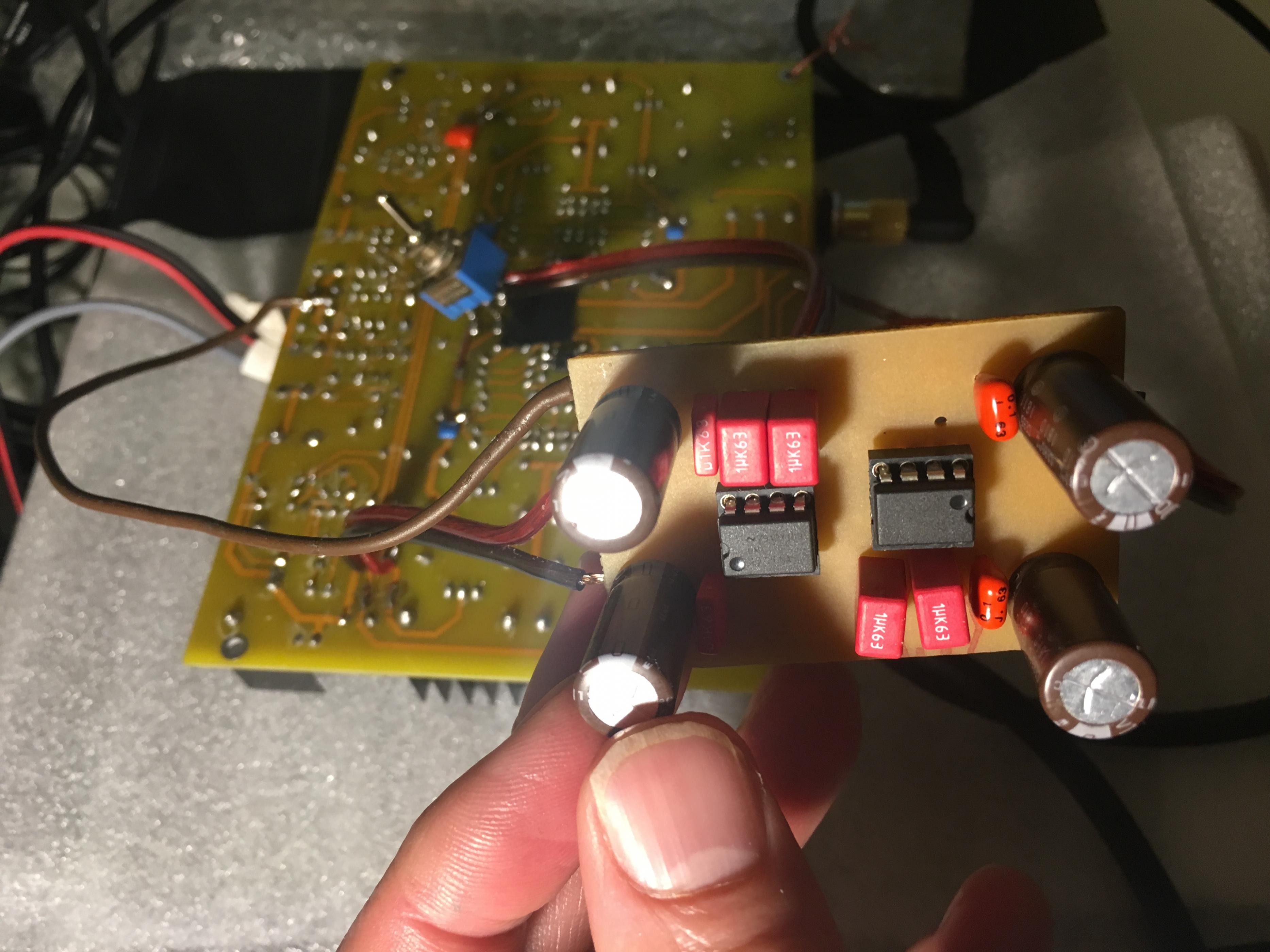

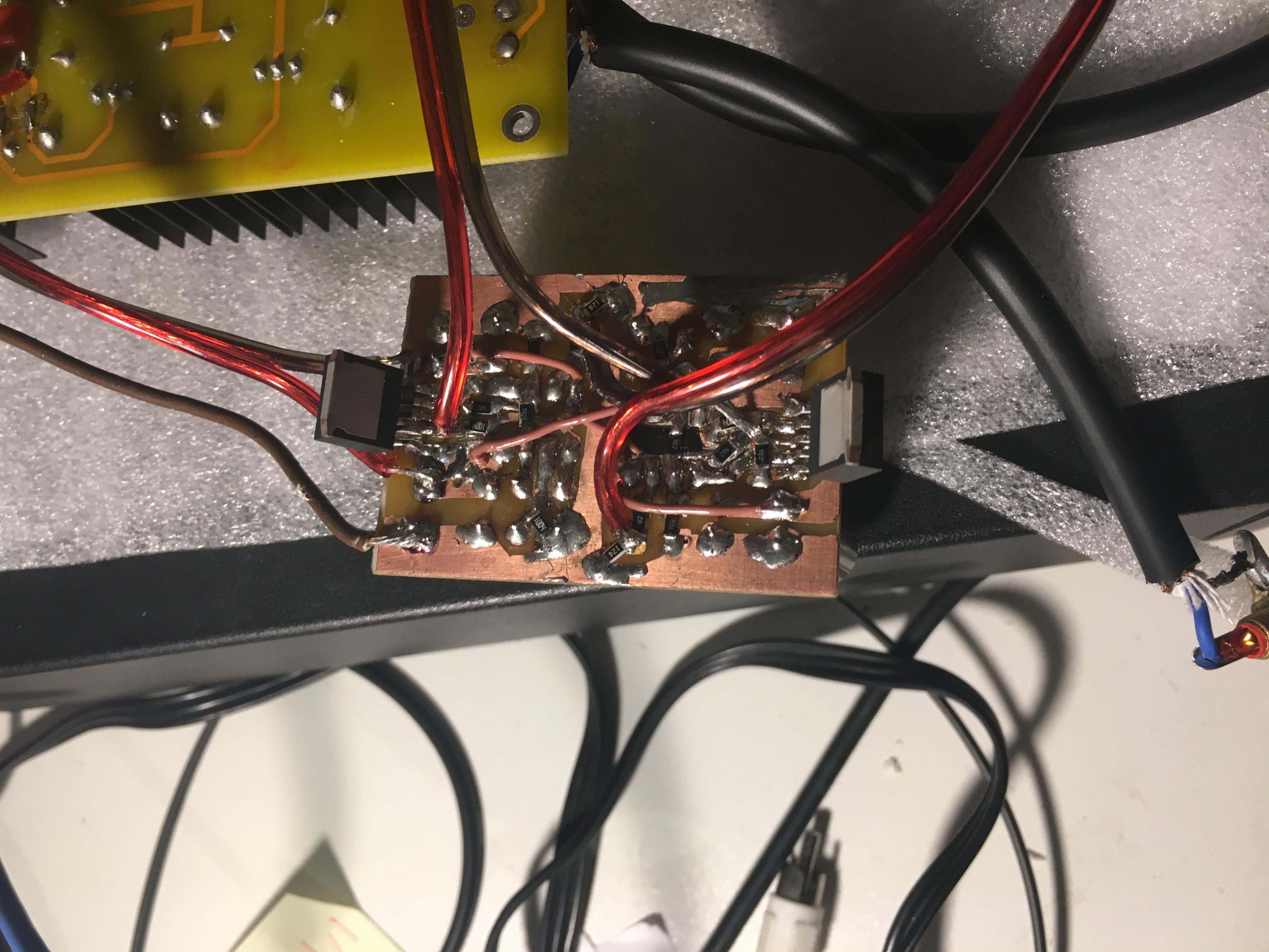

Hi Mark, All,
I built the 49600 based HPA. The DC servo based version which is slightly more complicated but proves no DC on the output. Comparing to my Lehmann (Class A) HPA basically it has slightly clearer voice. The difference is minor, but some distortion from the middle range disappeared.
Sz.
Thank you. Just to be aware they are fast and can oscillate easily if care is not taken to use a ground plane and proper decoupling. Just a word to the wise. Somewhere I wrote some things about what I found out when modding my HPA. Think it may have been back here: http://www.diyaudio.com/forums/digital-line-level/314935-es9038q2m-board-63.html#post5402398
Also, it started as one of these, but I found I had to do some work on it: 1PCS LME49720NA+LME49600 headphone amplifier KIT | eBay
If you would like to talk about it some, be happy to.
Hi Mark, All,
Sz.
...some distortion from the middle range disappeared.
Very good, low distortion is what we need for comparing DAC mods.
When you say you you built the DC servo version, did you buy a bare PCB and populate it, build it from scratch, or something else? Do you have any pictures (others may be interested too)?
The manufacturer/seller claimed SNR at 123dB and 20-20K band distortion of 0.00006%. There is no doubt some level of marketing exaggeration. It would be nice to see some real world measurement by an independent reviewer.Regarding the new Bluetooth Q2M board I just got and have been working on, I just got around to taking a good look at the grounding scheme on it. I think I already mentioned that the IV and differential output stage area of the board has no ground plane, contrary to what ESS recommends. It only has one thin trace running down the length of the side to do all the signal and power bypass grounding. I though I might be about to improve that then I realized the ground path back to the Q2M chip for IV signal returns was a nightmare mess. It runs back under the +-14v switching supplies, around the other corner of the board, up though about 3 vias to a short strip on top of the board, then back down though a couple of vias to return to Q2M from the completely opposite side of the board. No wonder it sounds bad and distorted with switching noise.
I ordered a pcb but since the delivery time is expected 2 month (eBay) I decided to draw a pcb. I’ve forgotten to mention that I could realize a complete DC coupling - so no cap at all in the signal path.
I used the protection circuit of the Lehmann. So likely small chance to get in trouble.
And I would mention the amazing packaging of the 49600. (Ordered from mouser - small box- anti static sponge inside)
ok here you are the pictures. The pcb itself is not very nice. I started to plan it with KiCad but finally drew manually not having laser printer at home to be able to print to a transparent film.
