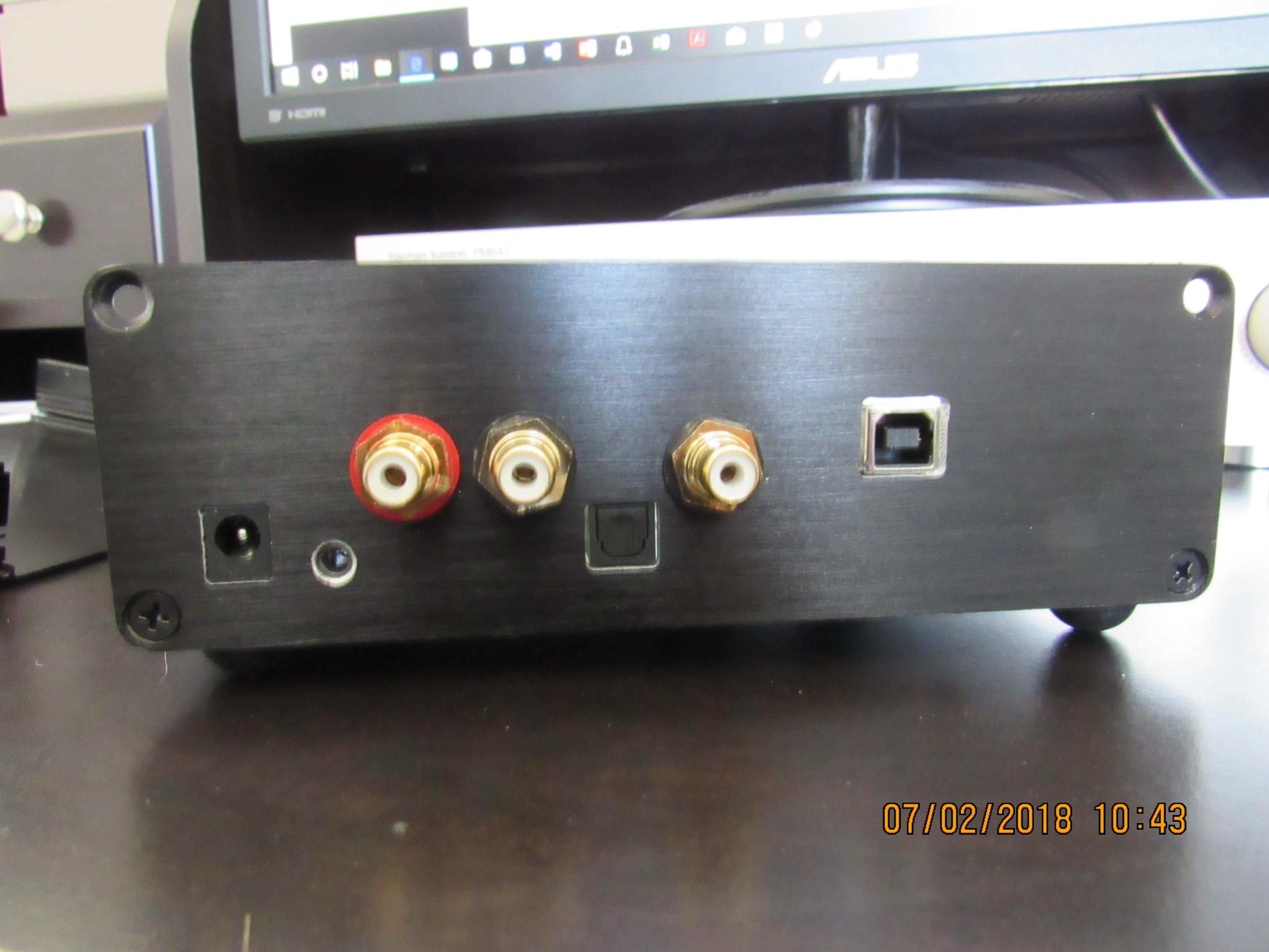

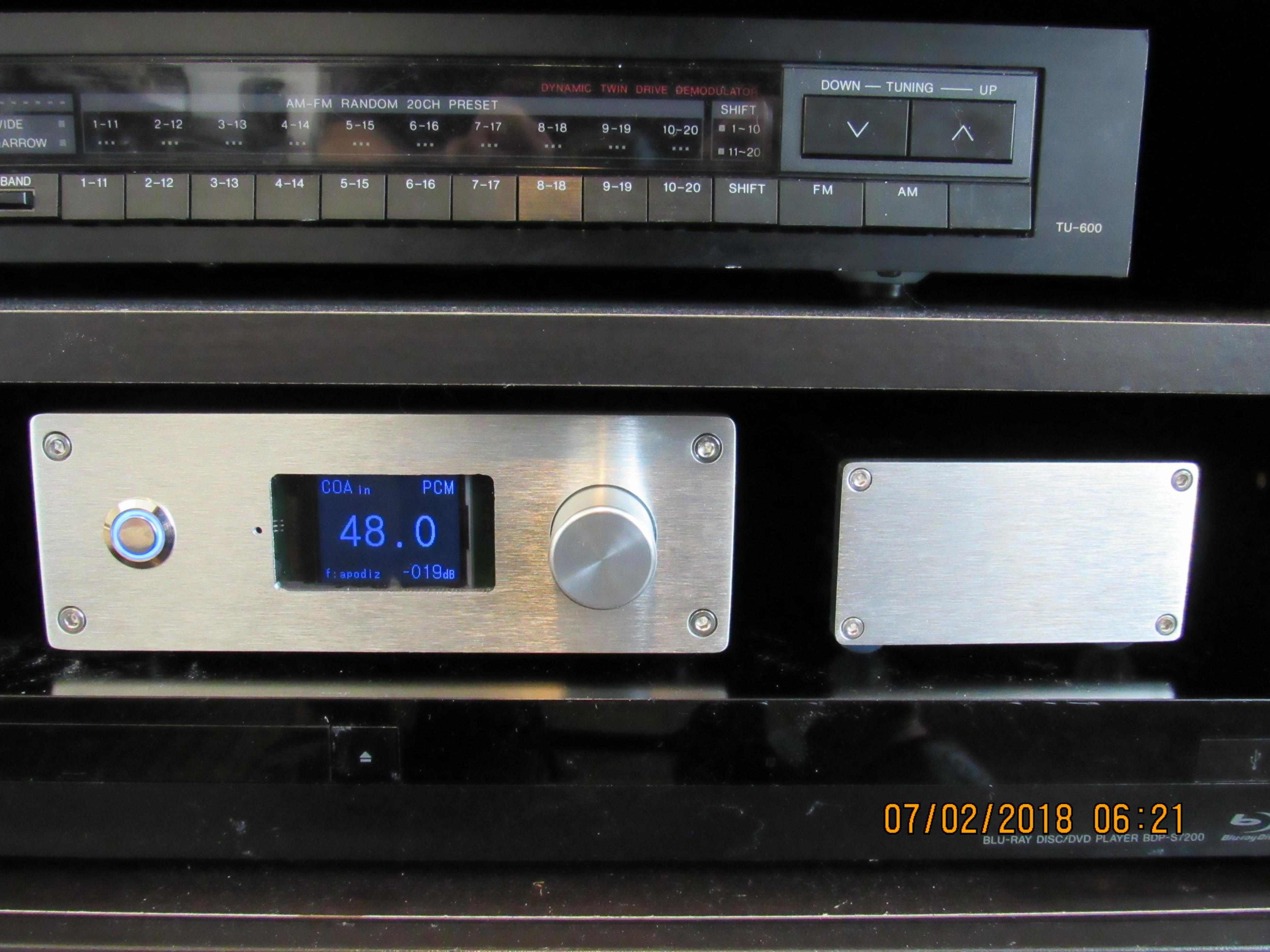

The DAC links the TV cable box and a Sony BDP-7200 Blu-Ray player to a Harman Kardon AP2500 preamplifier. The Blu-Ray player also serves as my CD player.
![IMG_4729.jpg IMG_4729.jpg](https://www.diyaudio.com/community/data/attachments/641/641978-396fc8451410ad4386022fce5b2e62d0.jpg)
![IMG_4730.jpg IMG_4730.jpg](https://www.diyaudio.com/community/data/attachments/642/642014-0d5e9d8e39565d8a141c4e6473ad7855.jpg)
![IMG_4734.jpg IMG_4734.jpg](https://www.diyaudio.com/community/data/attachments/642/642038-4ee0cf13db9121eea024f0eafe3f3e73.jpg)

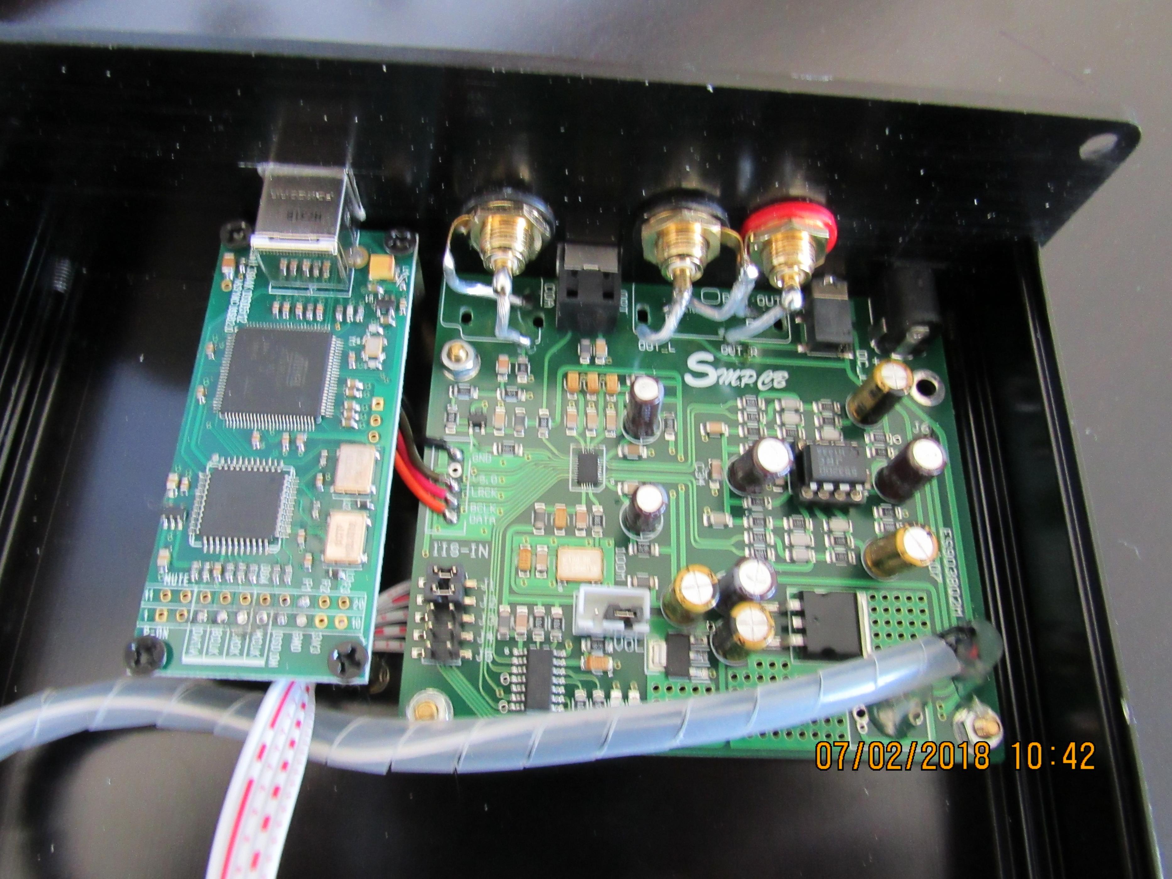

The DAC is built around the VR1.07 of the ES9038Q2M board we discuss on this thread. At the beginning, I used a switching PS from the Topping VX-1. It sounds very good from the get go. The sound is open and transparent. It has a stable sound stage with good depth. The construction of the DAC box is well executed. A lot of hot glue to hold down the TFT display panel and wires. I like the upgraded RCA socket, better than the one on the original board.
![IMG_4732.jpg IMG_4732.jpg](https://www.diyaudio.com/community/data/attachments/642/642183-e9e546d91cf4437fe702958c4b982c63.jpg)
![IMG_4733.jpg IMG_4733.jpg](https://www.diyaudio.com/community/data/attachments/642/642211-c48a13444b12fc7d261086f53ec9d0d4.jpg)

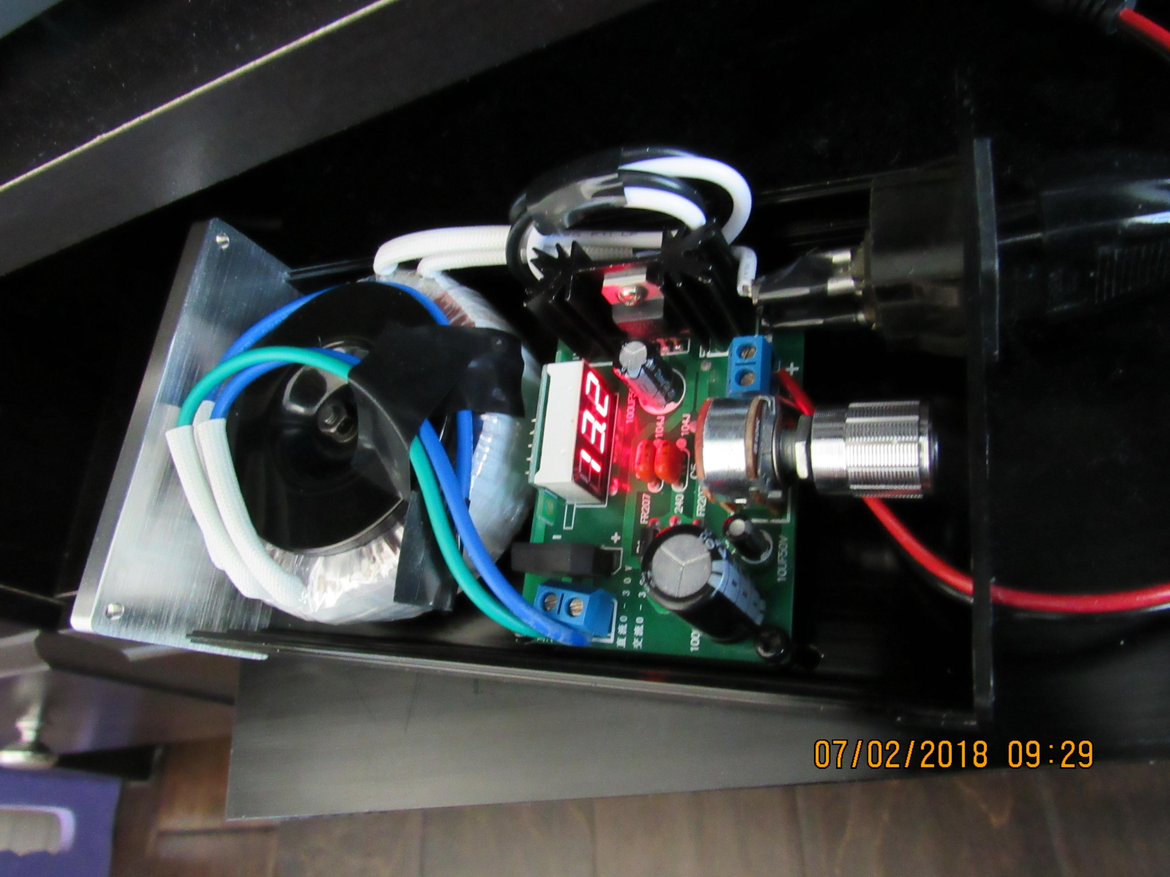

I built a linear power supply for it. It can output 9 to 15 volts up to 1 ampere. It has a good size toroidal transformer and the board has a DC voltage panel for easy setting.
![IMG_4731.jpg IMG_4731.jpg](https://www.diyaudio.com/community/data/attachments/642/642088-5ee0dcb9c7b4a1bd82cbc70826f624a5.jpg)
I was planning to install a dual voltage PS. But there is not enough room inside to house the transformer and PS board. I went the easy route.

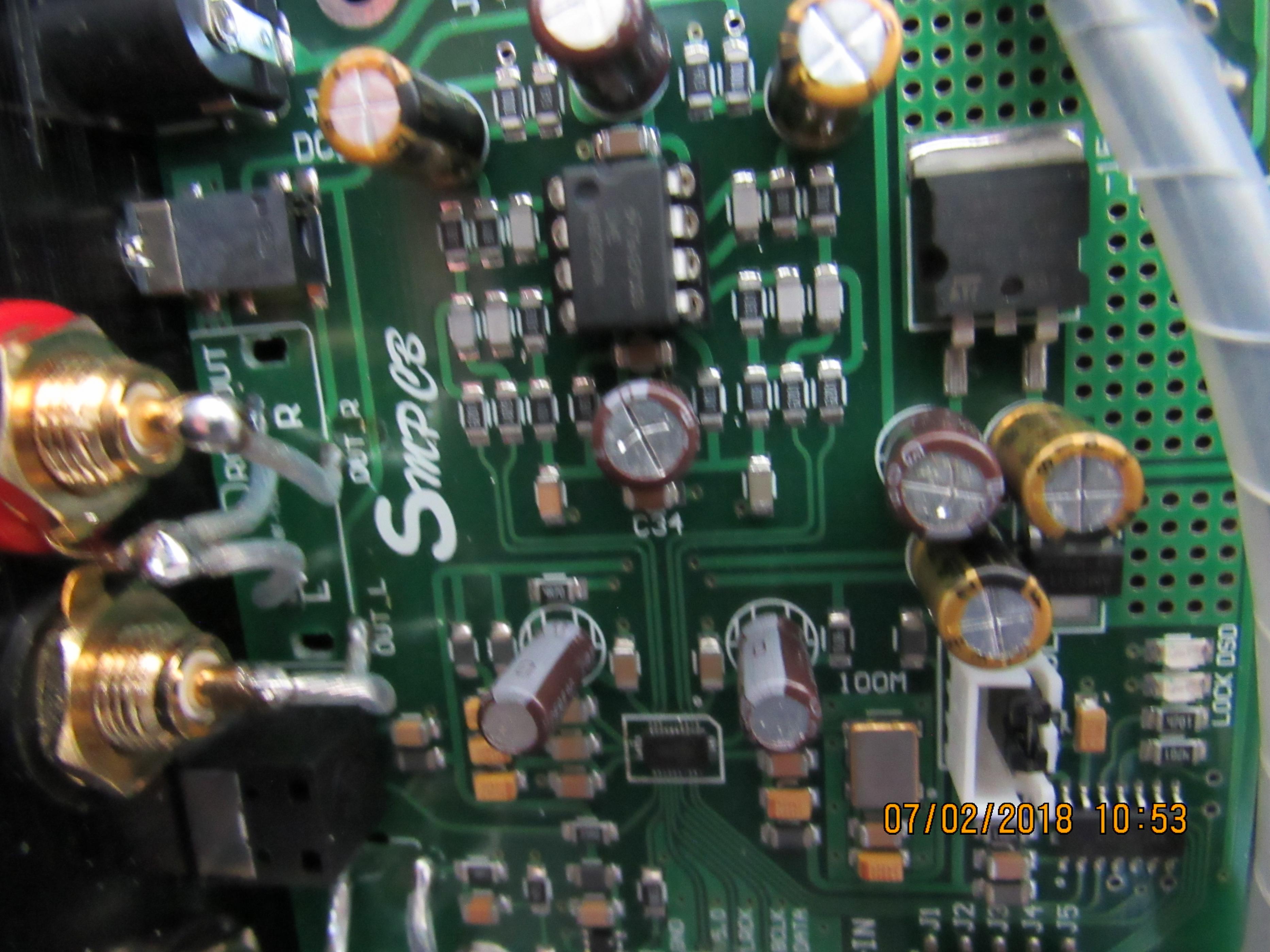

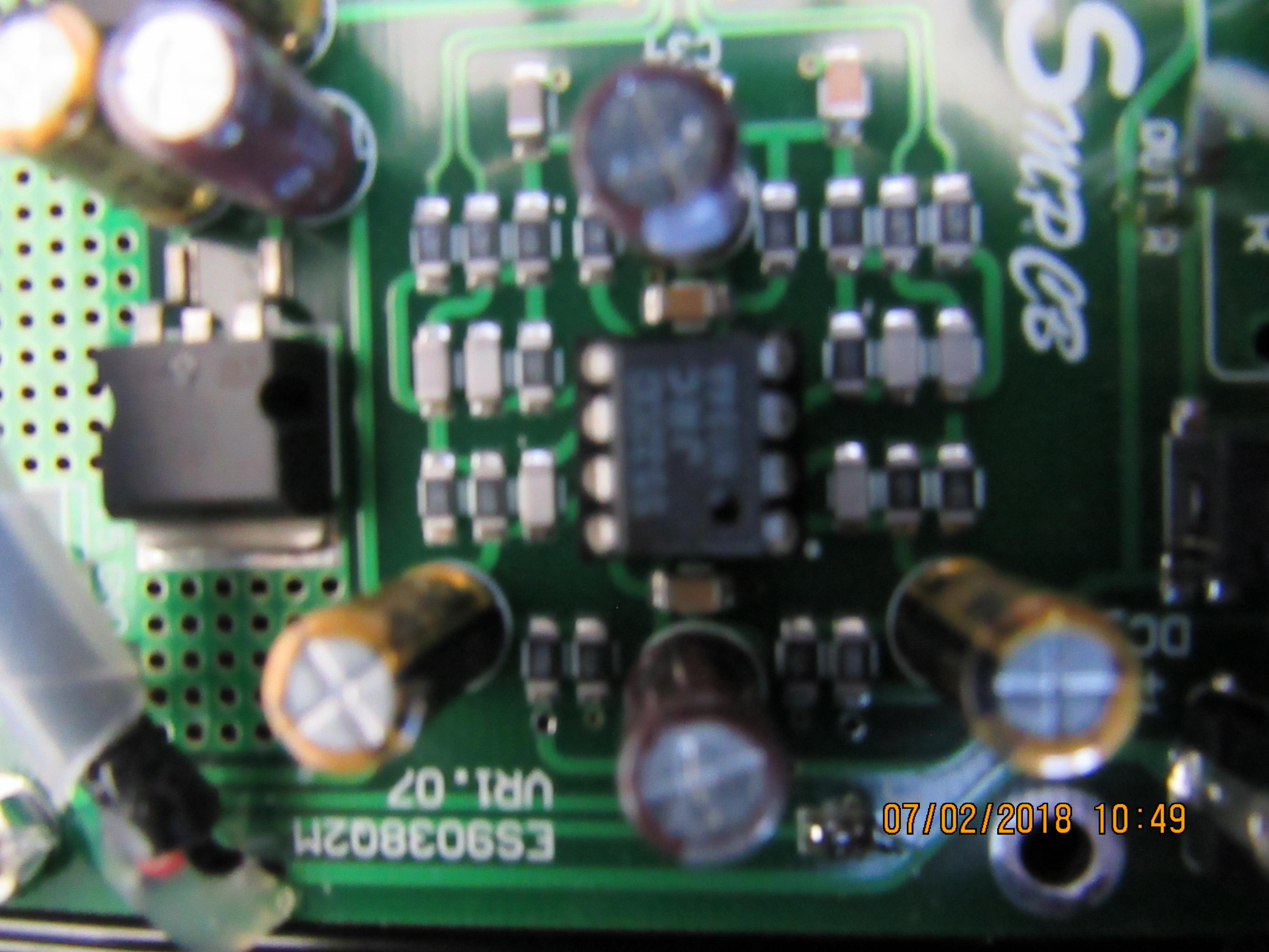

I did not even try to add I/V. I just replace the output stage opamp with a LME89720. The board came with NE5532DD which should be very good. I changed the opamp only because I have a whole bunch of the 720 in my spare box.
![IMG_4735.jpg IMG_4735.jpg](https://www.diyaudio.com/community/data/attachments/642/642118-65ad180f2459159d5b1af0573247927f.jpg)
![IMG_4736.jpg IMG_4736.jpg](https://www.diyaudio.com/community/data/attachments/642/642152-b0ae11c16f3fab4036090be2ded70513.jpg)
I purchase an Apple Remote which allows me to perform all the front panel functions.
![appleremote-oldstyle2.jpg appleremote-oldstyle2.jpg](https://www.diyaudio.com/community/data/attachments/642/642215-14cf8b485572e812b670e6880451b1df.jpg)
My previous DAC were a Rotel RSP-1570 (for main audio) and a Tianyun Zero DAC (computer sound). Both were 10 years old vintage. It is not surprising that the MShow DAC sounds pretty decent to me. The TFT display and remote function are nice bonus. I will not hesitate to recommend this as good investment for the money, at half the price of name brand DAC. In fact, later this month, I will try to sell mine to finance my ES9028PRO project.

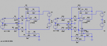

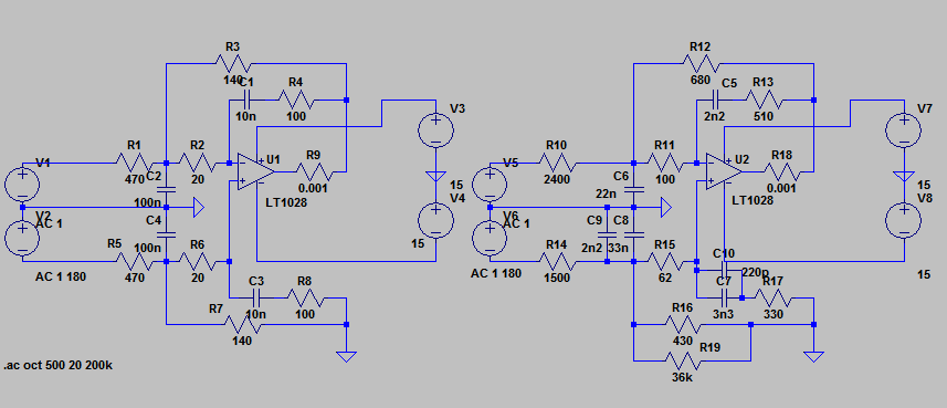

abraxalito, as you have the simulation tool running, could you please check what would be adequate resistor values for this circuit in case of an LME49720 opamp?
Would be also interesting to see your simulation circuit in LTSpice to make my own simulations (I did just discover Spice last week-end, but not sure how to simulate this circuit correctly..)
Hi freezebox - here's my suggested replacement, alongside the original. If you need the .asc file rather than just a screen grab, let me know. I've scaled the impedances to be roughly the same load on the I/V opamps at low frequencies, and aimed at 2k.
What do you mean by undue loading? Current limiting on the peaks?
I mean loading beyond the manufacturer's provided data. For opamps that provide THD+N plots, the load impedance is typically 2k, sometimes 10k and/or 600ohms. The 600ohms case is in general poorer than with higher impedances. This can be seen in the applications information for the AD797 for example.
With the LM4562 - and this seems to me to be a unique case - the +ve rail PSRR is shown with differing loads. The 600ohm load shows about 10dB poorer figures at HF than higher impedance loads.

Previously you said, "In the second, the input impedance of the bal-SE stage is too low .."
Then you said, "I just put the schematic into LTSpice which confirmed my suspicions - that those particular resistor choices place undue loading on both the I/V opamps..."
So, what I am trying to understand is what did you do in LTSpice to confirm you suspicions that the there is undo loading on the IV opamps?
The reason I am trying to understand that is because the IV opamp outputs only swing +-1v p_p, which means the output current is 10 times less than if they were going +-10v.
So, however you determined that the loading was too much using LTSpice, did you take into account any effects of the small output voltage and thus small output current under actual operating conditions? Does that make sense what I am asking about?

I ran the sim and asked it to show me what the input currents were to both + and - sides. The reason I couldn't tell this directly by observation is the 470ohm resistor's far side is 'bootstrapped' by the opamp and so gives a lower impedance than merely a passive 470ohm load.

Sure, I accept your point about current but I don't see characterization in any audio opamp datasheet for what happens with loads below 600ohm. Distortion is specified with example load resistances, not with a current source as load.
In the circuit I analyzed the I/V opamp feedback resistance is 2k72 so would you confirm that the peak output current from the DAC is 368uA? (This seems rather low for any DAC which is why I'd like confirmation).
No I didn't because I'd have to guess, uneducatedly to what degree the issue was mitigated by the relatively small output swing.
Thank you very much! I will try to re-built it in LTSpice as lessons learned. The opamp you were using is similar to LM49720? As I understand, Zin is deviating from opamp to opamp though it might not easily be exchanged by another one, right?

Zin here is determined by the choice of passive components (Rs and Cs) not the opamp. LME49720 is the same as LM4562 as I understand it, that should work very well in this circuit, measurement-wise.
