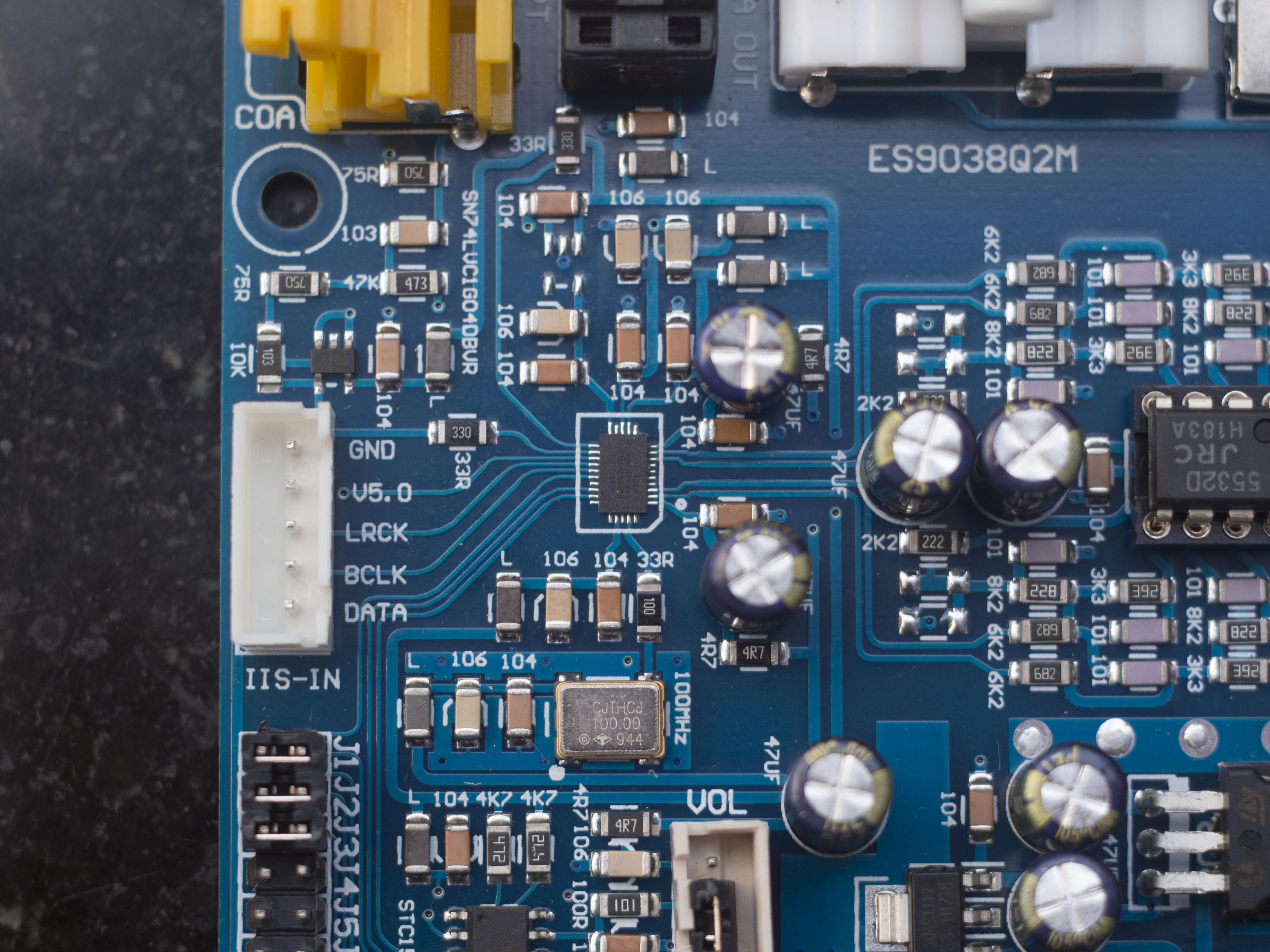

You might want to go back and look at the pictures here: http://www.diyaudio.com/forums/digital-line-level/314935-es9038q2m-board-84.html#post5415832
There is also a picture of the pinout diagram for the DAC chip here:
ES9038Q2M Board
The thing about the pictures is that they are high resolution but when you click on them you don't see full detail. So, to look at one click on it to open it, then while it is open hover the mouse over the lower left corner where a white X should appear. Clicking on the white X should expand the pictures up to full size. Or, you can right click on the pictures when they are open to select to download them. Then you can look at them in whatever picture viewing app you like to use.
Anyway, one picture shows the dac board with labels on some of the parts. It needs to be viewed at full size to read all the labels. That should help understand what all the parts on the board are for.

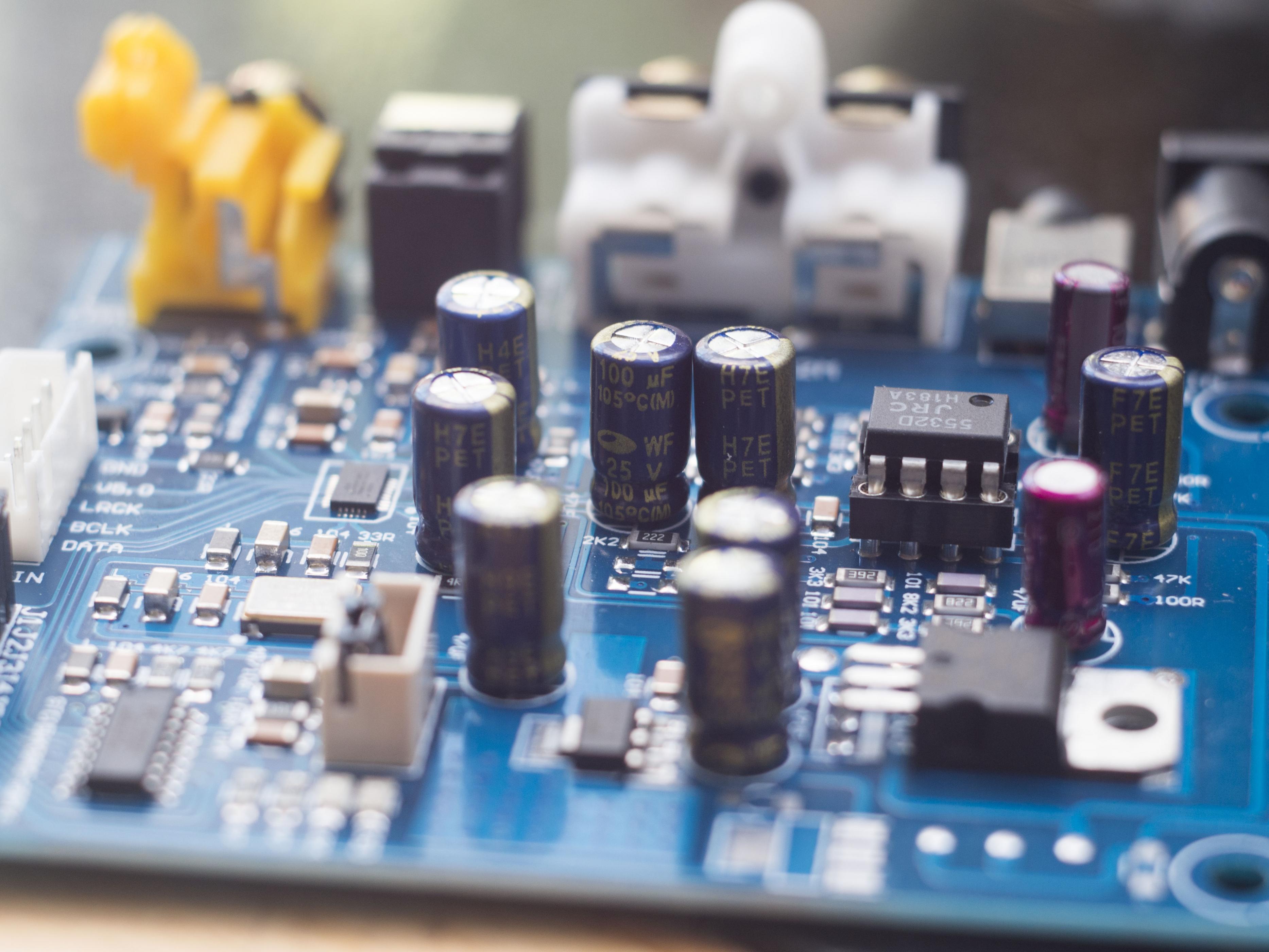

The way I modified the DAC board was to mount some mods on the bottom side of the DAC board. There is a special ultra-clean power supply for something called AVCC, a voltage that is super critical for good dac operation. Also on the bottom are the IV or current to voltage converters. The bottom also has a couple of 3.3v voltage regulators, one as a reference for AVCC, and one to power the clock. I might have done that part a little differently. Maybe the pins on the DAC chip labeled VCCA could have been powered by the same regulator as the clock.
On the top of the board the area where the socket is has been modified to make it into a differential amplifier to sum the IV outputs into Left and Right stereo outputs.
Also on the top of the board the clock oscillator module has been replaced.
In addition the 5v regulator was replaced, although currently I am not using that for 5v power, I am using an external 5v supply instead.

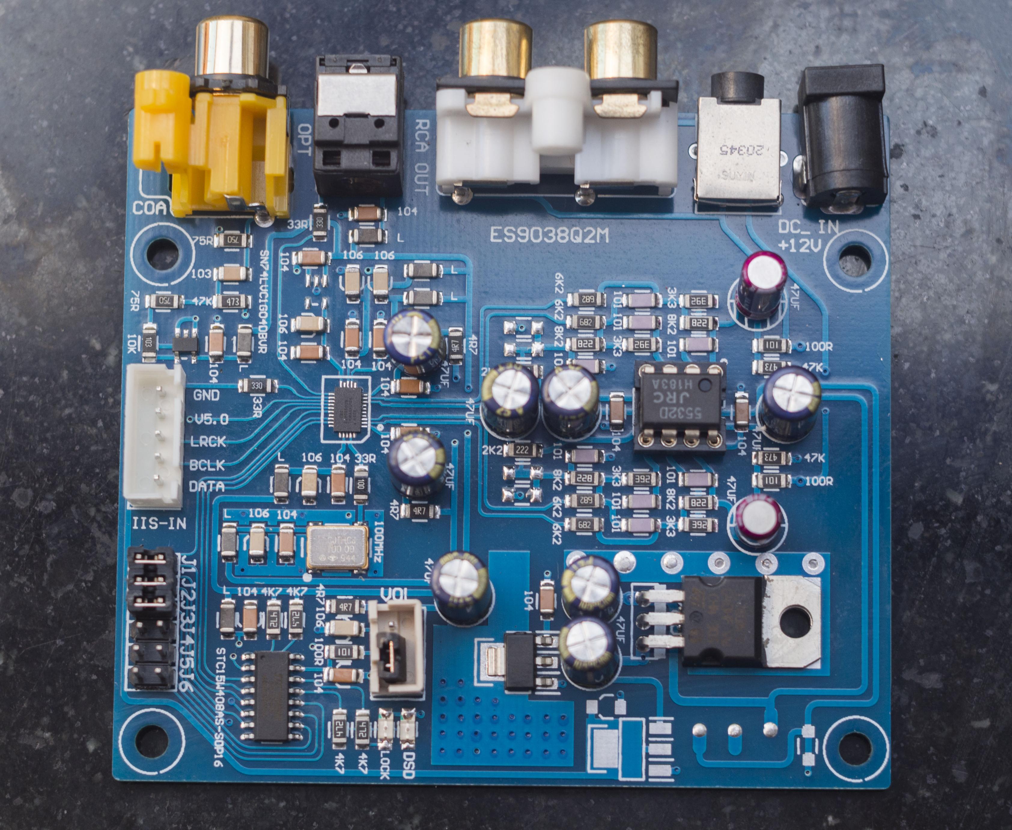

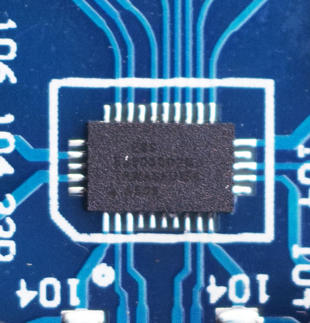

My DAC board just arrived in the mail, I have to say, it has a very cheap feel to it. There's only one op amp and it's socketed.
I'm suspicious that this is a fake knock-off rather than an actual ES9038 chip as it's unmarked and looks nothing like the pictures of the ES9038 IC I've seen.
I'll post pics shortly.
It should be a Q2M chip like you saw in the pictures I linked to. They are small and rectangular, not bigger and square like the PRO chips. To read the laser marking on chips sometimes it takes a magnifying glass and a flashlight held at an angle to see it. That isn't uncommon.
Well, I was wrong, it is marked, just very hard to see with the naked eye, I could only see it when I looked at the digital photo I'd taken of the board.
Here's the pics:

Regarding the board you just received, it looks like they are trying to get people to run it from a single ended +12v supply. I marked up the picture you took to show where positive, negative, and ground would be connected to a dual rail +-12v or +-15v power supply. I also put a red X where a trace would need to be cut, as it connects the negative rail to ground which would be needed if using a single +12v supply. The other green board similar to the blue one you have comes the with the power configured the other way around as the default, with a jumper that needs to be soldered in if using a single supply.
