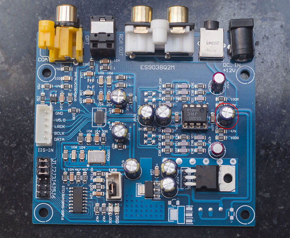

I would think it would be possible to use some thin wire to connect to the trace on the board, the question is, can I do it, I'm not entirely convinced this screw up wasn't my fault, to err is human...

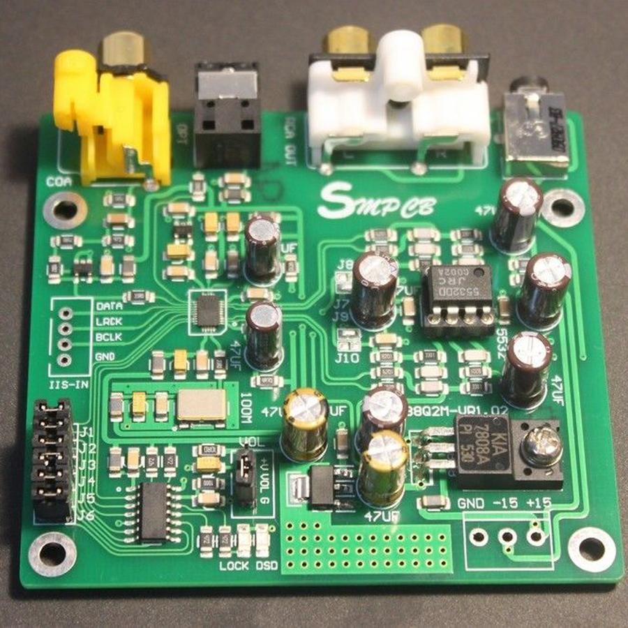

1. the particular bard is a knockoff of original one marked "Smpcb", expect lower quality materials
2. soldering is an art, and it also requires some kind of temperature control or at least appropriate wattage of the iron, right flux etc. try beforehand on an old pcb or something
3. if this is your long time commitment, invest in appropriate tools and skills. if not, then buying an entry level hifi DAC is much more sensible option. otherwise more frustration and money wasting will come.
I also had this problem with one of the CAP desoldering, but I agree with Mark, it is possibly (and likely) repairable.
I also have an old Weller unit. the 7 marked tip should be OK, the 8 is too hot (if by accident you have the same)

I tried my board out, powering it with a 13v 200mA wall wart and the two LEDs light up, then the lock one goes out and the dsd one stays lit. Connecting it to my PC via TOSlink and hooking into my amp with phono cable, I get no sound at all.
So I'm wondering, do the jumpers on the board have to be configured in a certain way to enable the TOSlink connection?
Or maybe my dodgy solder connection on one cap is why I get no sound.
for your board may work:
Audio input settings:
J1 short, coaxial input
J2 shorted, optical input
J1 and J2 are not shorted, I2S input

Removing the jumper on J1 and it now works but it doesn't sound good at all, fuzzy, tinny, some distortion, no low frequencies, just a load of treble and some mid range. In short, it sounds terrible, like a cheap transistor radio on a weak station.
So either my dodgy soldering on that one cap has greatly ruined the sound or the board I have is a lemon.
I should have tested the SQ of the board before I made any changes and if it had sounded this bad, I'd have sent it back for a refund.

I've checked and there is definitely no electrical connection on the positive pin of the cap I replaced, so I bet that's why the SQ is so bad.
One other thing I've noticed is that silkscreened on the board next to every cap location is the value 47uF but apart from two that are 47uF, the caps are 100uF.
I'm thinking I should cut my losses and just buy one of the authentic SMPCB versions that already has good caps and the terminals for connecting an off-board PSU, which is missing from this blue board which has a wall wart barrel connector instead.
