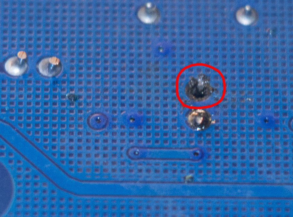

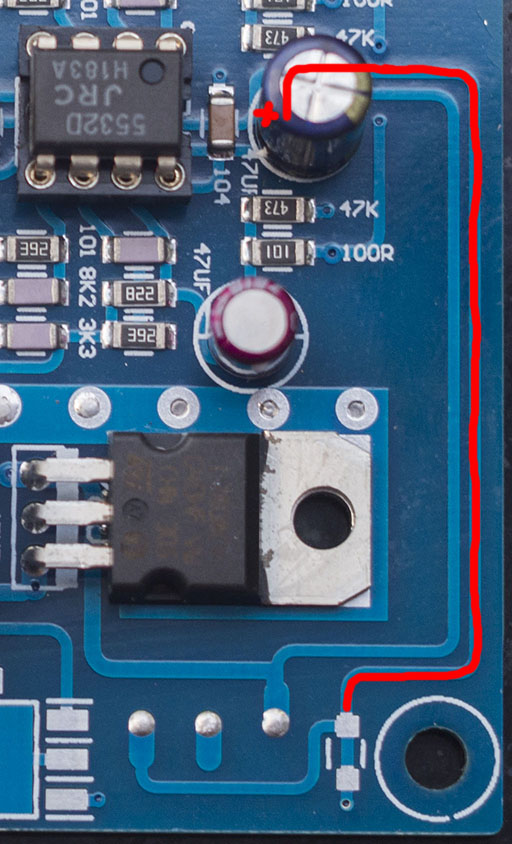

I've been examining the board and I think I've worked out where the trace that leads to the unsoldered positive pin on the replaced cap comes from:
attachment.php
So to fix this, I should run a jumper cable from the positive pin on the cap to the solder pad at the bottom right of the board?

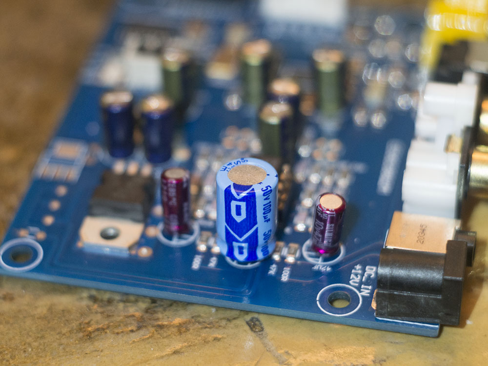

I managed to get my CD card reader working so here's some pictures of the damaged I did and my proposed repair:
The replacement Rubycon 100uF 50V cap:
attachment.php
The missing solder pad on the underside of the board on the positive pin of the Rubycon:
attachment.php

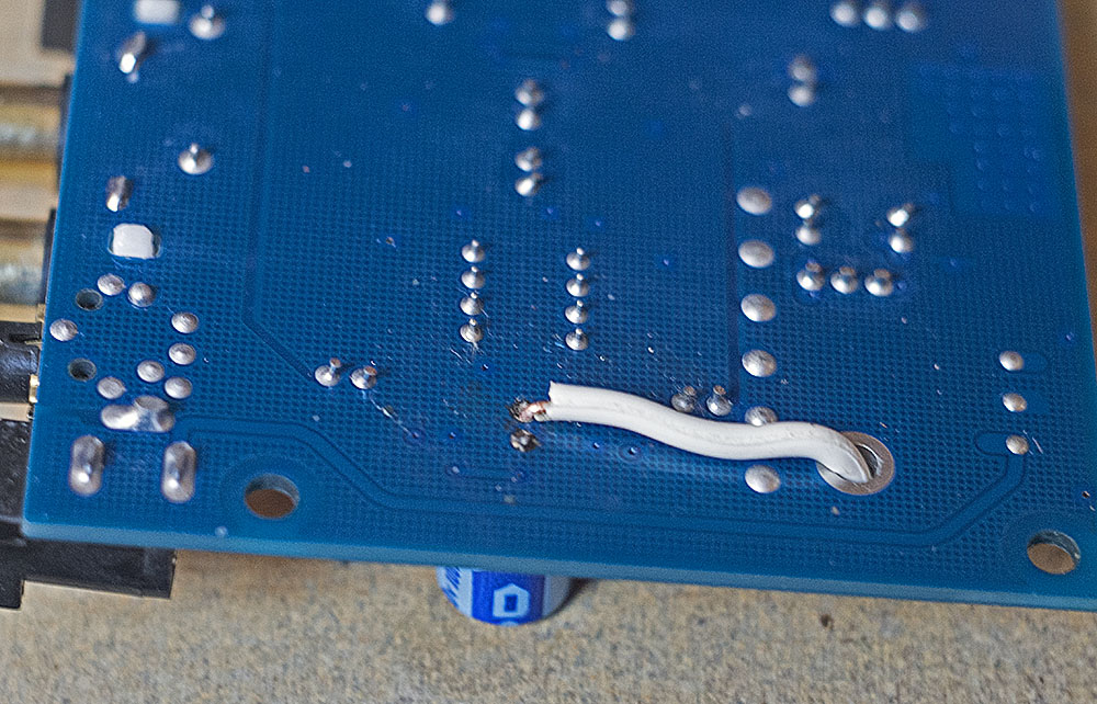

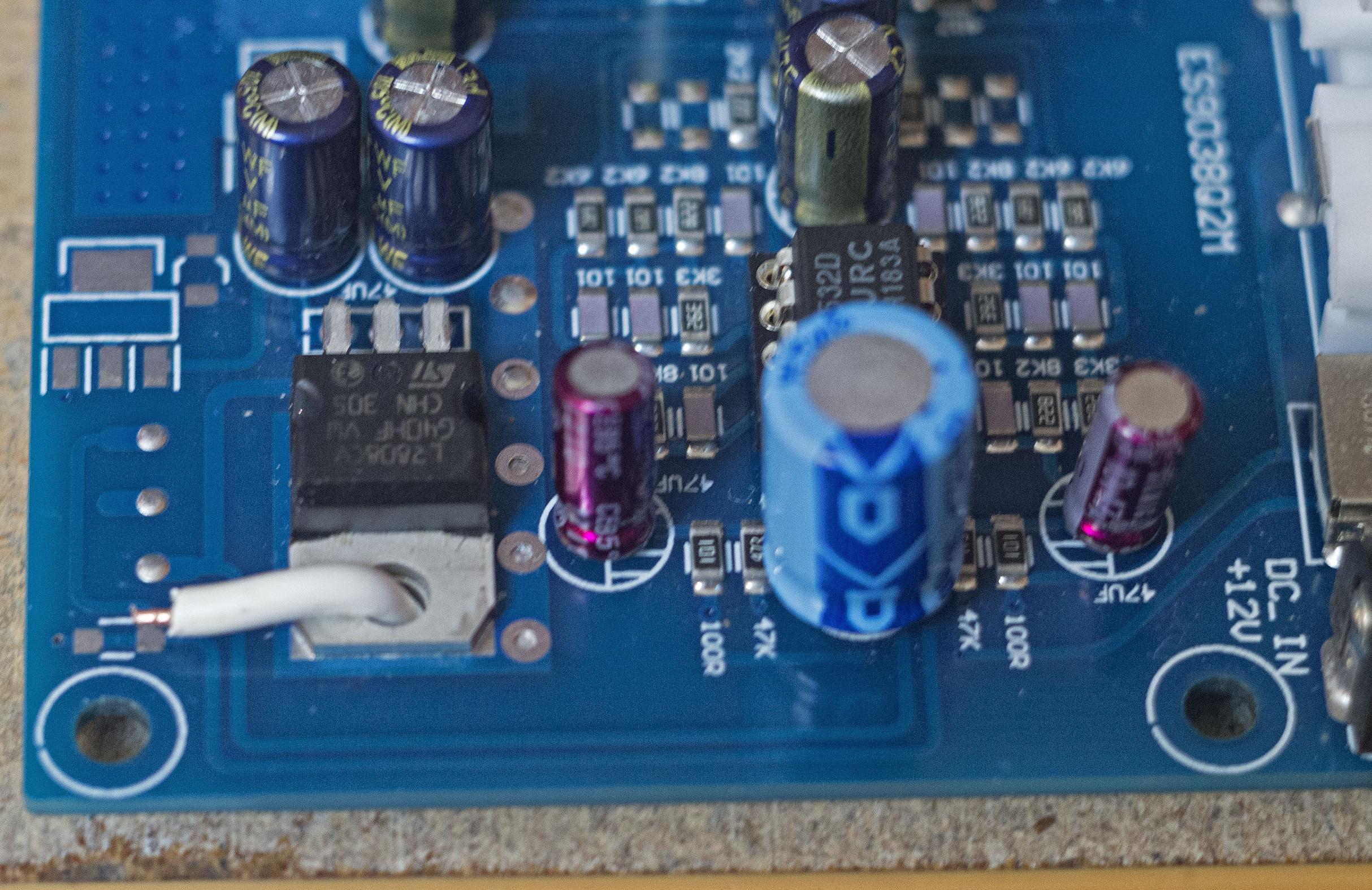

How I propose to run a jumper cable to repair the board, I haven't soldered it in place yet:
attachment.php
attachment.php

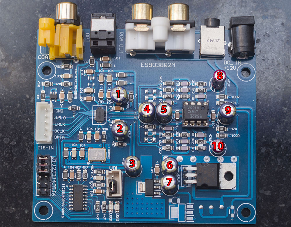

After the mess I made replacing one cap, I'm reticent to change the others, so I thought I'd ask which of the ten caps on the board are in the signal path and need to be replaced; hence I've labelled the caps 1-10. 9 is the one I've already replaced. So, which ones need to be replaced?

As far as the most important caps to work on, it might be 1 and 2, the AVCC caps. No need to remove them though. Just add some large value caps on the bottom of the board and solder them onto the leads sticking out down there from caps 1 and 2. The idea would be to increase the total capacitance and see if that helps. (once the rest of the board is fixed of course.)

and how you have connected the cap #9 right now?
Electrically, it is connected exactly as it was before, the jumper wire is performing the same task as the trace on the board that I messed up by ruining the solder pad on the cap end.

By large value, what sort of rating? The ones on the board are 100uF and I have 100uF Rubycons, I can buy some of a higher value, but what higher value do you suggest?

only the cap 8 and cap 10 on the board are in the signal path, my opinion is don't need to replace.

Regarding your statement that running a wire around to attach a cap lead at some other point on the circuit board as being exactly the same at attaching it right at the original location, that may or may not be a correct approximation. At high frequencies two points on a circuit board that appear as being at the same node on a schematic may be very different in their electrical characteristics. That is because circuit board traces have resistance and inductance which is not shown on a schematic. Sometimes those things can cause lots of problems, so please keep that in mind with something like a dac board.

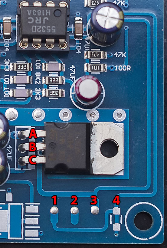

I've got a rotten migraine today so no getting much done. The multimeter I'm using is a Rapid Electronics 318 DMM, I bought it about 5 years ago:
318 Digital Multimeter | Rapid Online
attachment.php
With the meter set to it's continuity setting, I'm getting a good circuit between A and 3 and between B and both 1 and 2.
Sorry for being a bit dense today, blame the bad head, but what else should I be measuring?
