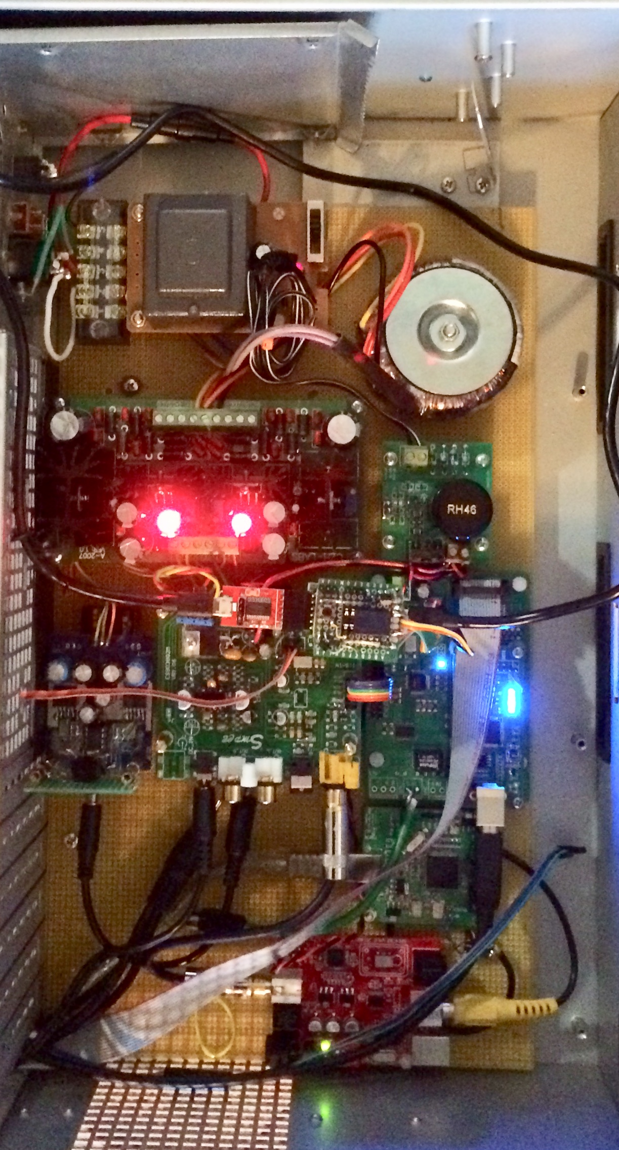

I will attach a picture below of the full test setup as it exists today.
If not familiar with how photos work when viewing in the forum, you can click on a photo to open it for viewing. While it is open if you hover the mouse over the lower left corner, a white X may appear which would indicate the picture is not being displayed at full size. Clicking on the white X will open the picture at full resolution.
It is also possible to right click on an opened picture and select to download it for viewing on the local computer.

What is the LT3042 powering now?
The LT3042 is the 5v supply for the SRC boards and for the DAC board. All of those board then have one or more 3.3v regulators locally. Just used the LT3042 for that because I had it and it was handy, it's probably overkill.
