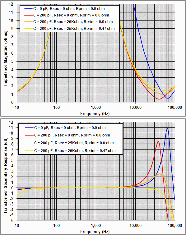

Using the parastics posted for the Antek-0506 it is easy enough to calculate response and impedance with good accuracy using this spreadsheet:
http://www.diyaudio.com/forums/plan...101-electronics-challenged-2.html#post2555863

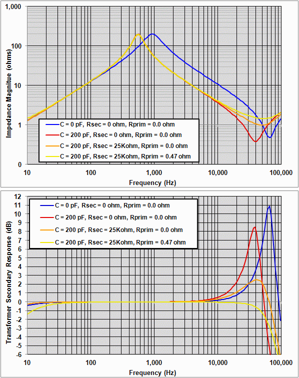

In the attached plots, C= ESL capacitance, R= resistance in series with primary
Pic #1: Shows impedance and response trends for increasing capacitive load with R = 0 ohm
Pic #2: Shows trends for varying R, with C = 1200pF
This is the typical capacitance for a "jazzman-style" flat, unsegmented ESL, for which the Anteks are used.
Note that R = 1 ohm provides a -3dB slope in the top octave which is exactly what is needed flatten the +3dB slope of the on-axis response of an ESL line source. Reduction in R might be desired if listening is done slightly off-axis.
Pic #3 and #4: Shows trends for varying C with R = 1 ohm and 2 ohm.
Pic #5: Shows impedance and response trends for increasing capacitive load with R adjusted for maximumally flat stator response.

I found another old measurement.
I did make in the past a transformer for a hybride esl, 1:115, never used it but last year i gave it to a friend.
Unfortunately no impedance measurements are left but i know for sure that it will be not very low (above 8-10Ω at least at 10kHz).
I had a couple questions concerning your measurements:
1) Do you know what the input impedance was of your measurement setup? The amplitude of the resonance peak for the "no load" and "load=200pF" should not be the same if there is no change in damping resistance between the two cases.
2) When adding the 25K resistors in series with the primary, do the measurements show voltage across the secondary winding? or voltage across the 200pF capacitor.
3) Curious if you recall number of primary turns, and core size. Based on frequency of resonance for "no load" and "load=200pF" leakage inductance would have to be quite lower, perhaps around 5uH, and winding capacitance similarly low around 90pF.

20Vrms(200Hz) sound about right for SU60A c-core with 40 turn primary.
The best fit I could find for your transformer is:
Leakage inductance = 4uH
Winding capacitance = 110pF
The main thing I couldn't match was the Q of the unloaded resonance. Perhaps at the high frequencies there are other losses not included in the model that would damp the resonance. Adding just 0.1 ohm in series with the primary would bring the unloaded resonance peak down in line with the 200pF curve.
Estimated impedance at 10khz would be about 10ohm unloaded, or 4 ohm with 200pF load.
If used to drive a 1000pF load, impedance at 10kHz would be ~ 1 ohm.
For a esl unit i guess 200pF would be enough if you have a step-up ratio of 1:115.

This is the reason why i like graphs double logarithmic:
This reminded my of old joke from college days...In lab class if your experimental data wasn't following expected linear trends, just plot it on LOG-LOG scales.
Almost all experimental data looks better behaved when plotted LOG-LOG. 😀
Seriously though, plotting impedance for circuits with reactive components in LOG-LOG format can often provide better insight into which components are dominating the impedance, and relative level of damping at resonance. Attached below is re-plot of transformer data from post#28.
I believe STAX used to plot impedance for their ESLs with LOG-LOG scale.
