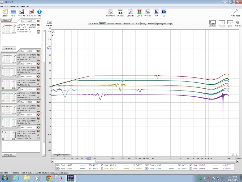

I found that I can get 40Vms at a 300Hz saturation point.
At 40Vrms I get 4500Vp-p out of the AS-1206(m) and this actually enough to make my little panel really sing.

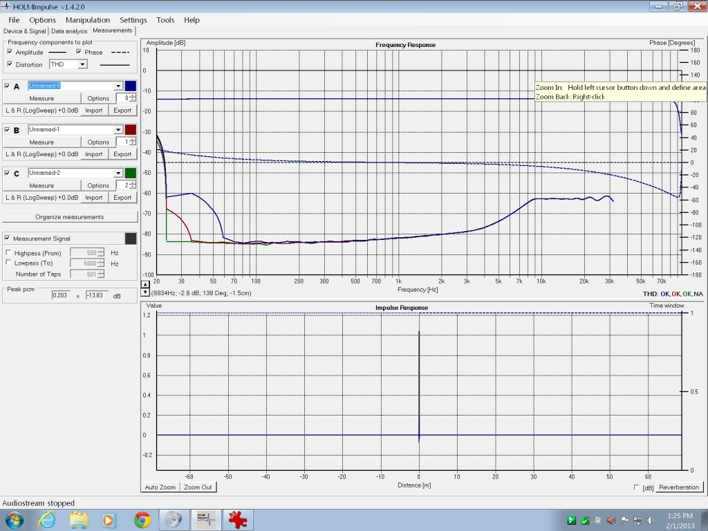

I many of my tests I have found the same jagged irregularity in some of the curves and found them to be random and intermittent.
I had found this to be the fault of my motherboards sound card.
My good out board sound cards don't do that and produce clean curves.
You can do a Loop back test to verify this.
I was pretty much stuck using my motherboard sounds at the time.
But here are a few examples of the same issues I had as well.
The other thing is that if you don't use a buffer in between the divider and the sound card input you will get non-linearity's as as the low impedance of the capacitor input of the sound card input changes and is not driven with enough current from the output of your high impedance voltage divider.
Else your curves look pretty good.
Very similar to my first curves then I found the issue I had explained using Visual Analyzer and made a buffer and now they are clean and accurate.

The photo of the Holm sweep may have been from using my GINA24 card in my other machine and it is very clean.
I will see if I still have the plots I did using the other cards.
I was having a hard time trying to figure out if it was the sound card or the software that was causing the glitches.
In my earlier post using SimpleS I had the same issues and they went away when I switched to a better sound card in a different machine and is why the curves were smooth and doing the same test with the same Transformer on my new motherboard's sound system and produced dirty curves again.
Here is the thread were I described the weird issues I was having too,

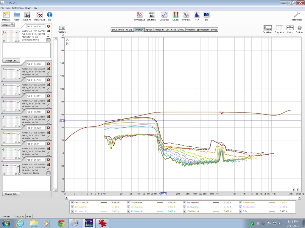

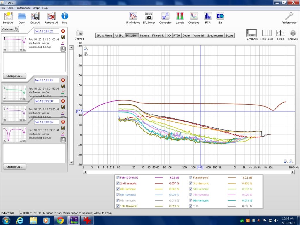

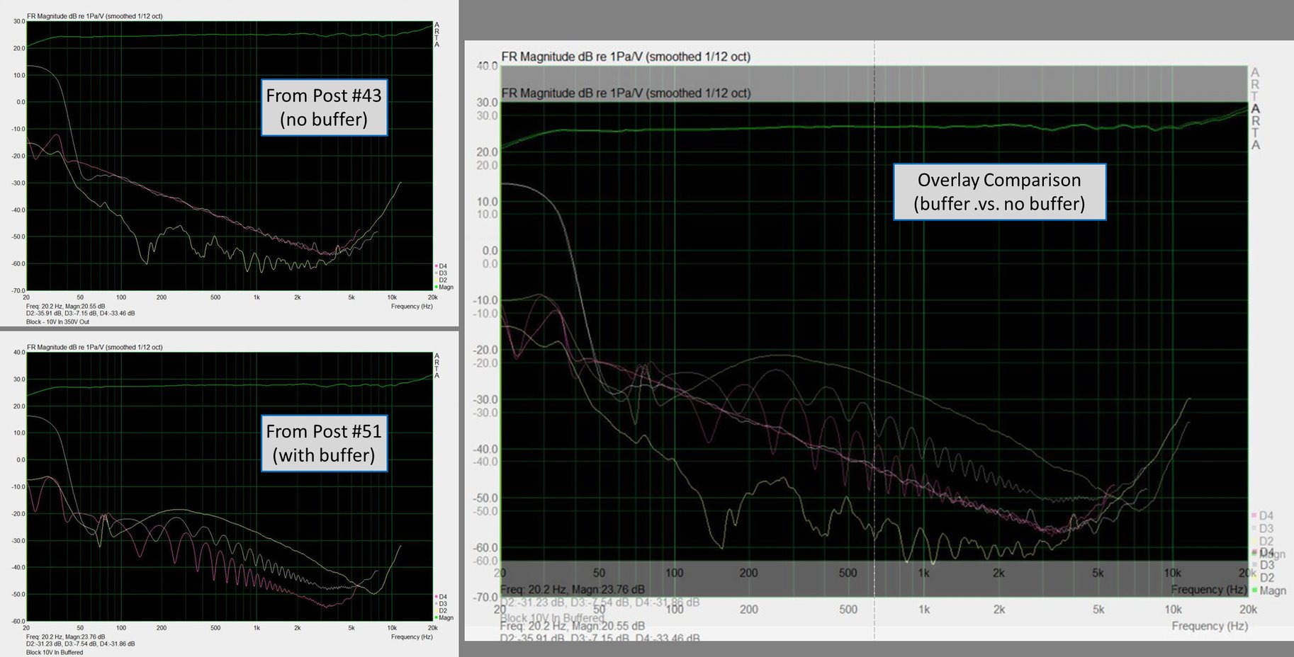

Oh, now I get you! I had thought you are talking about the DC blocking cap but you mean the RF filter cap usually about 200pF. Also yes, of course the output of the voltage divider is about 1Meg so it will not feed the 10K input of my soundcard well. Can't believe I didn't think of that, usually I use a much lower value voltage divider for recording the output of amps, like 1K output Z.
I shall build a high-Z buffer and try again!
Okay I have built a TL074 unity gain buffer and taken measurements from that. I had no input Z setting resistor on the buffer, so it would present a very high impedance and bias current would be drawn through the voltage divider at the transformer end.
These are the results same settings as before - 10V input.
Block
Noratel
Nuvotem
So in this case we can see that the Block TX seems to have lowest distortion. This is probably because the Nuvotem and Noratel are both 30VA and the Block is 60VA.

Those curve look much better.
From about 300hz (the point of saturation) I get about .5% thd and then it drops to about .1% and then by the time it gets to 500hz or so, and above 1Khz it is quite low typically .04% or lower.
Depending on my voltage level and whether or not I have the software properly calibrated for the level that I am testing, I have gotten readings as low as .004% above 1Khz at full power, and that is the limit of my sound cards THD.
At this point I am basically measuring my amps THD (Crown DC300a).

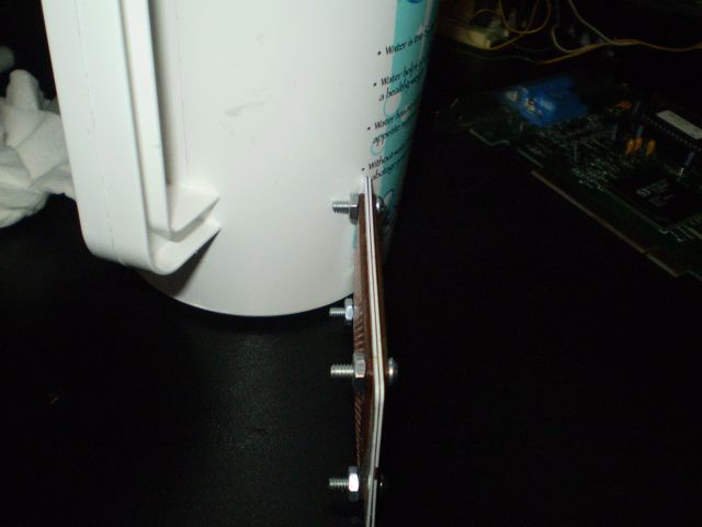

I have one PP OPT from a Knight PA amp the had EL34's in it.
I tested it back in 2010 with the method's that I did know back then and I was not impressed.
Although it did work great for my Micro ESL headphone driver (See Pic's).
The ratio for one was way too low to be used with my Little Panel and I didn't want to risk burning it out with the high voltages as it is the only OPT that I have and the amp still works.
I had a pair of 6V6 opt's that I used when I built my first set back in 2003 but they eventually gave out due to the high bias voltages that I was pushing.
But they sure sounded great (for awhile..He,he,he,he)!!!! ;)
I had the same idea as you with my little panel (3.25" x 9.75") that "Hey this thing should be able to at least out perform my Midrange and tweeters!!" and it DID !!!
But I ended up burning it up before I got to put it in finally service.
But the pair cost me less than $10 to make and I have plenty more material.
When built properly these thing will scare you out of the room!!!!
When listened to properly they will engulf you into what you are listening to!!!!!!
I haven't listen to them in stereo since about 2004 when my original OPT's finally quit working.
Since 2010 when I revived my little panels I only used one pnal at a time to do all of my testing and to learn understand the characteristics and what their flaws were in order to improve upon them in the next build.
But I was still amazed listening to just one panel when I finally got it to mate properly with one of my little 5 1/4" woofer and with a 8" sub driver as well.
Just incredible !!!

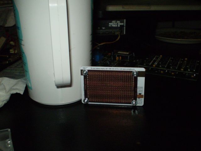

I have some Perforated material that I have finally decide to make two 4 foot long by 5" wide panels for use as Midrange/Tweeter for my Big system, as I am tired of blowing out and replacing the dynamic drivers and the last set has been blown out again and will never be replaced again!!! ;)
jer :)
Very Good !!
I must be missing something...
Why do you feel that the distortion curves taken with the buffered input look better?
Comparing the measurements for the "Block" transformers, the frequency response is essentially identical with or without the buffer indicating the capacitors on the sound card input were sized properly for full bandwidth audio use. Ignoring the ripples from mains interference, D4 is essentially identical as well. But, D2 & D3 are much worse with the buffer included.(D2 is 30dB worse, D3 about 10dB worse)
@ Tenson,
Did you perform a loopback test with the buffer to confirm low distortion as you did for the non-buffered setup in post#48? http://www.diyaudio.com/forums/planars-exotics/233008-esl-hybrid-5.html#post3767153
Is it possible the DC-offset of the power amp was larger when the buffered measurements were taken?

They certainly are different aren't they.
I probably should have refrained from that statement as "they look better" before I took a closer look at the graphs.
Sorry about that, oops!!!
But there definitely is a difference between the two and this does not surprise me.
Using the Buffer will definitely isolate the sound cards impedance from the resistor divider.
I had gotten a completely different results too, although not as drastic.
I don't believe I saved any of the screen shots I did before using the buffer.
But it was when I did a loopback test with and without the resistor divider that it was not consistent between the two tests without the buffer and was with it.
I mentioned this in my earlier post.
jer :)
I think the results with the buffer are more accurate. It seems odd otherwise that the distortion on all three TXs was much the same. In the buffered measurements there is more difference between them and as expected the TX with higher VA rating has lower distortion in the low-mid frequencies. Additionally, the buffered tests show a more common pattern of falling level with increasing harmonic order which is not present in the other test set.
I did a 1KHz FFT test with the buffer in place and all was well, distortion around -100dB.
It just can't be accurate to drive the 10K soundcard input from a resistive divider presenting 1Meg source Z. That constitutes a pretty good current source, doesn't it?
I don't think my amp was performing any differently by the way. I even tried it from two sources - direct from my soundcard and via my Cyrus pre-amp with similar results.
As Quoted~ "But it was when I did a loopback test with and without the resistor divider that it was not consistent between the two tests without the buffer and was with it.
I mentioned this in my earlier post."
This was mainly from when I was doing Imepedance measurement curves directly into the sound card.
The FR did not change and shouldn't, I do see your point Bolserst.
I don't have all of the components at hand to get setup right away to check this on my system.
But it has got me thinking and I will dig out my apparatus and get it finished so that I can do some more testing now that I have the latest more stable version of Visual Analyzer.
There was definitely something that has added more THD compared to the earlier graphs.
All else the THD in the earlier graphs show similar consistancy's as the cores I have tested at about .05% and better.
Except the last one that shows as high as .5% THD, until 1Khz at approx. .17% and gets lower from there as the frequency goes up.
THD to dB - convert percent to decibels dB % percentage voltage % vs per cent converter THD+N total harmonic distortions calculation signal distortion factor attenuation in dB to distortion factor k in percent decibel damping - sengpielaudio Sengpiel
jer :)
P.S. I didn't see your confirmation while I was making this post. ;)
Okay! I've done a loop-back with the amp, voltage divider and buffer, but without the TX. Actually it also has my Cyrus pre-amp in line since I couldn't be bothered to change the plugs.
The voltage divider was in fact not 10meg and 1meg as I had said. It was 10meg series and 10K parallel. So this was providing a 10K output impedance on all my earlier tests.
To do the loop-back test below I reduced the series resistance to 1meg and kept the parallel leg at 10K. The amp was set to output 50V. No significant load on the amp, just the voltage divider.
I'll also say sorry that my tests are not normalised at 0dB. I don't know why they are all at around +30dB, I keeps doing it even with a feedback channel. I need to look in the settings.
I think the results with the buffer are more accurate...the buffered tests show a more common pattern of falling level with increasing harmonic order which is not present in the other test set.
I agree that the distortion trends for the buffered results do make more sense as far as reducing level with increased order. One other thought I had was that perhaps the results are getting contaminated with ground currents. Did you happen to run the test twice swapping the ends of the transformer secondary that your buffered probe was hooked to? This would change the phase of the distortion fed from the secondary to the probe input relative to any ground currents. If you see difference between the two measurements, the "real" answer is likely somewhere between the two.
Excellent :up:
At audio frequencies the 10K input impedance of the sound card will be in parallel with the 1Meg resistance, effectively shorting it. So the voltage divider for the unbuffered case is made up of 10Meg series + 10K shunt. Right? Or am I having a senior electronics moment...
OK. I was just asking 'cause I know some Crown amps are DC coupled and the offset does drift around a bit. I didn't know if part of the large difference in 2nd harmonic might be attributed to DC current in the primary.
