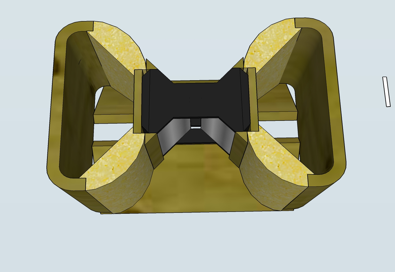

Got me thinking
Hey badman,
Your pic got me thinking and that is always dangerous ...
If you put the heil 90 degrees to the way it is in that horn and move it forward you will be reflecting both the front and back waves into the front. The horn of course has to be made of metal but its relatively easy to bend sheet metal into a horn. Then back it with wood I guess.
The dipole actually creates more trouble than it helps IMHO. The tempest which has the smaller heil in a monopole is a easy speaker to toss in anywhere. The dipole amt1b I have just reflects and smears and just makes a mess in my house atleast.

Hi:
Can you draw a diagram? I'm not sure what you're saying with the orientation. If need be, I can damp the backwave, which may well be better suited to my purpose, but it sounds like you're talking about creating a heil horn with a dual entrance of dissimilar pathlengths.
I'm going to try kerfing the sideboards and wrapping them into place today. The 1/2" panels acting as spacers are only glued in place, and that only by press-fit gluing (which isn't as bad as it sounds, especially if you gapfill with glue after wards). But the 3/4" wrapped side panels ought to substantially increase the strength of the assembly. I'm not decided on whether to use the top deflectors- the dipole cancellation upwards may be the better solution for me.
In your post #117 the last pic. Turning the amt assembly 90 degrees, so you're looking at the big square end of it, and moving it forward so its closer to you and the Horn shape closes into the back of it will make it a monopole with the front and back waves comming into the front side via the horn.

I don't have the problem with the dipole that you seem to, and I'm well beyond the point of no return on this assembly. Will update as it gets built.
The arrangement you propose is a worst-case scenario, IMO. The cancellation from the 2 sides of the dipole would make this a non-starter, unless I'm still misunderstanding.
Not cancellation, its reflecting both the waves into the front ...
If it works in my house I could make a bunch and sell em ... sounds like an amt, disperses like a horn.

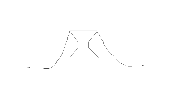

Please knock up a diagram of what you're describing, I think we're having a communication breakdown.
However, you're wrong on the dipole operation. The AMT works such that when pleat 1 opens, pleat 2 closes, pleat three opens, and so forth. So when a positive pressure is created in front of the ribbon, the opening pleats on the back side create a rarefaction. They are indeed 180 degrees out of phase, just like a ribbon without a rear chamber, but the pressure/rarefaction are created by the bellows motion rather than an in-out motion, hence AMT.
Yea That 180 degrees is correct, it will be out 180.
The coil is in the wall of the pleat per se, not at the bottom, I keep getting that confused.
That means the left speaker needs to be built 1 way and the right its mirror image.
I will try to put a drawing up. The other thought I had was, just because it wont cancel each other doesn't mean it would sound good. Horns are not meant to have sound hit the wall @ a 30-60 degree angle, In a way horns are there to prevent sound from dispering into a wider and larger spread out field. Without that horn, you would get more response way off axis and a lot less response on axis. Anyway I'll try to get a drawing done and post it.

Now you're talking L/R cancellation... the cancellation we're concerned with is the front vs. rear wave of the heil. I'll wait for your drawing!
