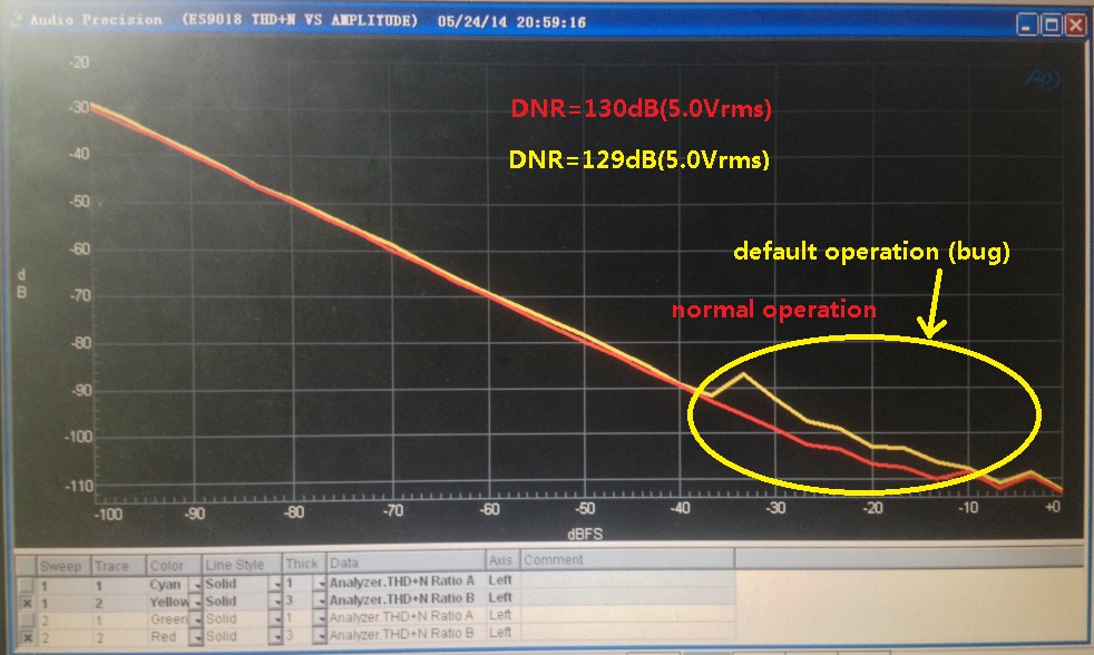

Hi Dustin,
It seems that you've not been log on diyaudio for a long time. I post my question here in case you come here again later or ...
It it no double that ES9018 has the noise bumping issue in every chip. No matter which I/V you use, discrete or OPAMP or tue (if you can done a tube output stage which can deliver ~1.5uV rms noise in audio band).
But in fact, the chip can work normally in some way. (I am not sure about the root cause and corresponding solution) Please find the measurement below:
the yellow curve is the default working condition, in this way ES9018 diliver ~129dB DNR in my bench. But most important thing is that the THD+N is a little poor in the range -10dBFS to -36dBFS. When I dig it deeper, I found that the THD is not the issue, but the noise floor.
the red curve is the normal operation which I expect from ES9018. It delivers 130dB DNR and excellent THD+N in the full output range. Further check on this working condition, the whole system provide amazing linearity up to +/-1 ~2 dB error in -140dBFS to 150dBFS range.
I think all the user want to get the second operation condition from ES9018. Will you share your comment on this question?
Thank you in advance.
BR
Paul Lu

Hello
Do you know if the ES9018K2M also suffers from this bug or "working condition"? or is only for the first ES9018 version?
Very thanks.
