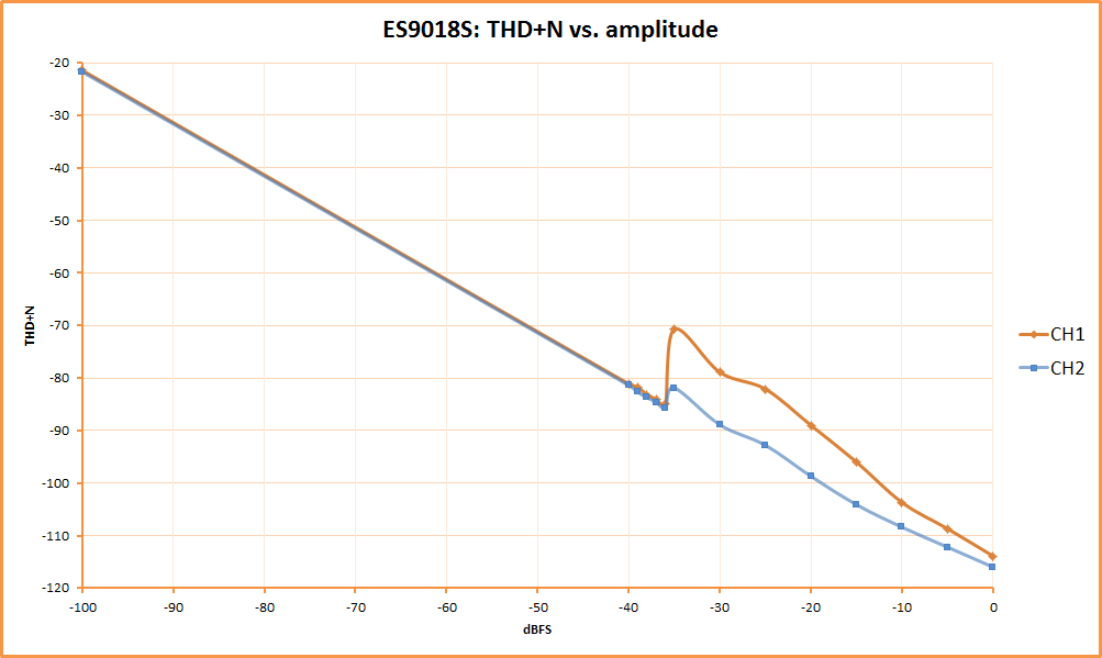

If the noise-bumping is somehow connected to the limit cycles, then it may not appear (or appear less) with real - non-sine - music signal, am I right?
Yes, less, but if the music signal happens to wander just around the critical level then it can modulate the noise floor.
(many R2R's tend to get bumpy THD+N vs level plots too, when signal crosses the boundary where next 2x element jumps in, but there it's mostly THD because the error cannot be whitened)
Still, I don't get why the noise falls down again when amplitude is rising from 35dB up. There should be even less space for element scrambling...
Does it really fall down, or the SNR just improves because the signal itself comes stronger? The THD+N vs level plots look like the noise stays pretty much at the new level, as expected. Although maybe improving a little possibly due to some modulator dither kicking in and reducing the error.
Yes, see table in .xlsx attached to post #2351 - measurement of best and worst channel of my DAC module.
The integrated THD+N error signal amplitude, which is about ~1.4uV for very low level signals, suddenly jumps to 8.35uV on -35dBFS, but again falls to ~3.3uV near full scale (where majority of it is probably formed by THD itself, not noise).

I was dealing with the same problem, thinking that it is my design's issue, until I've been told about your post.
I've reached over -124dB THD and ~1.6uVrms audio band noise, which yields about 121dB DNR (my module is 8 channel with 1.6V output voltage). But interestingly, I found out that every channel has different full-scale THD+N, varying from -113 to -116.5dB. I spent tens of hours trying to solve it!
After reading your post, I sat again to R&S UPV and measured THD+N vs. amplitude and got the same result as you. There really is a bug manifesting itself between -35 and -36dBFS by steep noise rise, while THD level is not affected. However, I think it is a output, not input stage bug, because it acts differently on each channel.
Channels 2 and 6 are performing best, while 1, 7 and 8 are the worst. All measurements has been made with I2S input in asynchronous mode and the bug is present with both cheap Fox and high-quality PLEtronics MCLK oscillator.
Unfortunatelly, I can't (or at least don't know how to) make a plot of noise vs. DC level (in dBFS). Could you try to do it on your AP? I think there may be only single (or few) problematic DC level/s corresponding to certain input data levels, which could be filtered out by DSP to solve this problem.

Thanks for your input.
To my system, the issue did not appear sometimes when I power my DAC up.
In that case, the noise for whole range is ultra clean. as you can see from my measurement.
But, I am afraid that ESS will not reply a single word to this issue. Because many customers are using ES9018 in their products. Like WEISS, etc.
I think it will not affect listening most of the time, but I insist on my standard. This bug can not meet my requirement unless I can find a stable way to avoid this.
