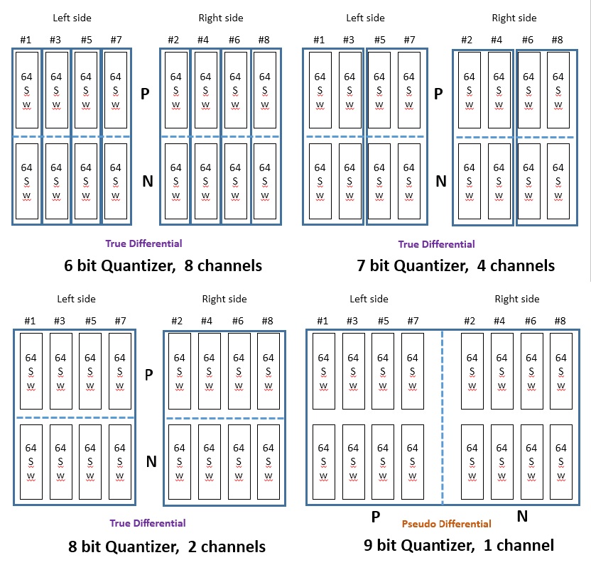

Hi, cu6apum!
I hesitated to show my further explanation here because I got aware that my basic understanding on an analog DAC section of ES9018 Sabre32 architecture had been wrong at the timing of my initial posting you quoted. As of now, I have no suitable environment to check the validity of my current idea shown as below. Therefore, please remember that the following explanation is just my "guess".
1. Definitions of "True-differential" and "Pseudo-differential"
I have no idea on strict and generic meanings of those terms. I think it's better for us to regard these terms are "ES9018" specific ones.
2. Consideration on a hidden register setting for "quantizer bit length" of analog DAC section of ES9018
As the most of you may know, one channel of ES9018 has a pair of analog DAC sections, one for a positive phase and another for a negative phase. Each analog DAC section includes 64 CMOS 1 bit switches in parallel and decodes 65 level delta-sigma modulated digital signal in an unary (thermometer) coding. The switching frequency is MCLK/64. Each analog DAC section outputs a mono directional positive voltage or a negative current (outbound current from DAC chip) with 1/2 full scale off-set value.
If you think of both positive phase and negative phase output of a pair of analog DAC section, both signals are mono directional positive voltage signals. By treating the positive phase signal and the negative phase signal in a differential, we can get a bidirectional swing on one channel.
The ES9018 architecture provides an optional method for configuring its analog DAC sections so that they may accept delta-sigma modulated digital signals of higher levels, 129 (7bit), 257(8bit) and 513(9bit). (This n-bit notation is called as "quantizer bit length". It shows a level of delta-sigma modulator output.)
I illustrated these configurations in the attached figure.
3. "Pseudo differential" for "9 bit quantizer bit length" configuration
The ES9018 architecture might have a certain kind of "physical isolation" (not a galvanic isolation) between a left side (Ch1,3,5,7 side) and a right side (Ch2,4,6,8). In the case of 9 bit quantizer bit length, making 8 positive phase analog DAC sections into one group across the sides must be impossible. Therefore, 4 positive phase analog DAC sections and 4 negative phase analog DAC sections in a left side should be grouped into one positive phase output set. In the same manner, 4 positive phase analog DAC sections and 4 negative phase analog DAC sections in a right side into one negative phase output.
I think this irregular configuration is called as "Pseudo differential".
I really welcome any comments from you.
Bunpei
Bunpei, thank you, this looks like the most comprehensive hypothesis made in this thread.
Yet I don't understand completely how the outputs are internally grouped together, as the physical stereo-mode design suggests simply paralleling all the outputs of each side together. This means that equal current (read: digital value) is going to be fed to all of them. Or not?!
If so, this is proven to be true for "true differential", whatever it means. And some experiments above in the thread say that if "pseudo" is chosen with polarity flip, the output signals do NOT completely cancel each other. This is more like roaming in the dark, than having a clear ideology of this chip.
And finally, on your drawing. I was pretty sure that 9-bit depth does not mean all-mono mode, it just denies "true differential". Am I wrong? Post #35, http://www.diyaudio.com/forums/digi...re-reference-dac-8-channel-4.html#post1429418
Thank you!

Hi, cu6apum!
I think one of major advantages of true-differential configuration is that the total number of CMOS switches in "ON" state at one side of DAC chip is always kept constant. This is a very good requirement for an analog power supply.
As you pointed in your post, this advantage might not be obtained in the "Pseudo-differential" configuration I assumed.
However, designers of the DAC chip might have been attracted to the fantastic idea of realizing "513 level" analog DAC section accommodating 513 level delta-sigma modulated digital signal. This would be expected to bring an extremely high resolution. At the same time, the 9 bit quantizer mode should break a good symmetry built in this architecture.
As a matter of fact, I have never tried the 9 bit quantizer mode in my environment.
I appreciate comments by those who actually tried this.
Bunpei
