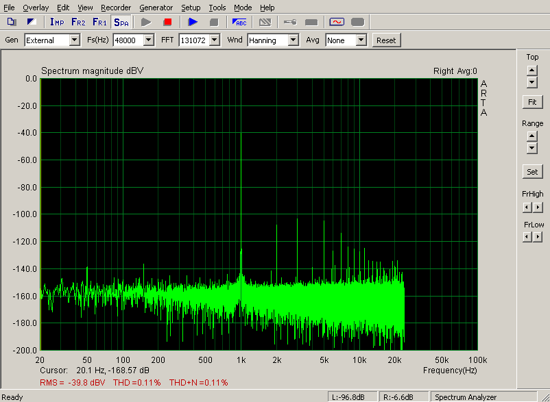

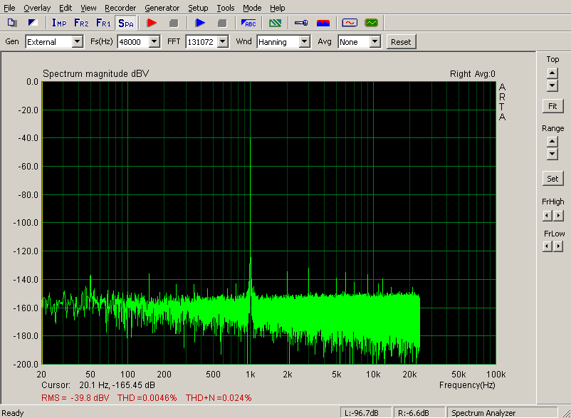

I'm not sure if following issue was discussed here, but I have following observation:
The distortion components of the 1kHz -45dB signal sampled at 48kHz played from SPDIF depends on previous operation of SW volume control.
I'm using Toslink -> Buffalo3 -> IVY I/V unbalanced -> +40dB amplifier with OPA627 -> ESI Juli@ soundcard.
The distortion components (under -100dBV) changes when volume is decreased and then returned back to the maximum. They does not changes when output of DAC is disconnected and connected back to the signal chain.
Can someone confirm this?
Here are two measurements with difference that only digital volume was decreased and then returned back. The y axis is calibrated.

More info: mine ES9018 changes harmonics distortion pattern on any change of any volume register (0..7) to different value via I2C.
These harmonics varies in the range -105dBV to -130dBV.
The pattern does not change with DAC reset and neither on short-term power down.
Harmonics pattern does not change on stop/start playback and also does not change on volume change in the signal.
It changes only when value of volume register is changed to different value.

Random harmonics pattern clarification and visualization:
My setup: Buffalo 3 with ES9018S C500, 100MHz clock, 8ch I2S input, chip default register settings, sinus 1kHz -45dB.
The harmonics are different on each start: http://i.imgur.com/CAzdfTl.gif
The harmonics change after alteration of volume registers: http://i.imgur.com/X8QercG.gif

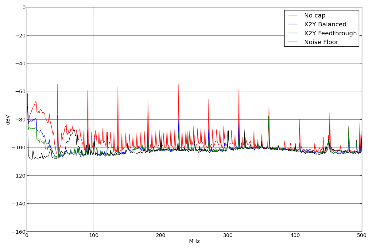

Bonus : Here is FFT of ES9018 output, from Rigol DS2000 300MHz scope sampling at 2Gsps. As you can see, MCLK is feeding through (as expected), nice HF spikes up to the scope bandwidth limit... some passive filtering might not be such a bad idea after all.
Can you post scope traces ?
That's the "magic" of the digital sources. Most people concentrate their efforts on audio band distortion, but in fact it is the HF interference that makes a difference in sound. Takes a long time to get enough experience to evaluate what is important and what is unimportant
