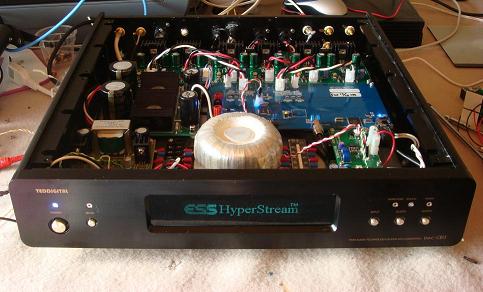

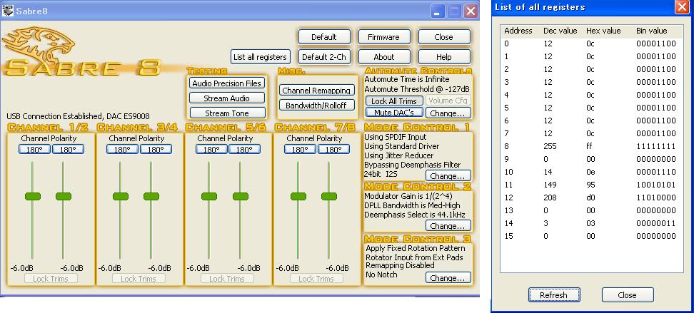

Hello! I'm Digital "WOTAKU" live in JAPAN.
Hello, DIYers!
I am nagaesan, an enthusiast of ES9008S chip live in JAPAN.
Russ wrote;
>I am guessing you mean "demo-board" firmware?
I think that you know, inside ES9008S IC-chip, there is some memory area and controll software for re-setting firmware.
I use ES9008S boards, that have USB controller. The work to renew firmware is very simple.
But I think you can renew from I2c interface your firmware in ES9008S IC on the Buffallo DAC.
hirez69 wrote;
>On the Ess site they are not available.
>The latest release is 2.0.2.1 version.
Yes. The latest rversion "2.0.2.1".
[sabre8_automute_disabled.iic] and [sabre8_noAM_SPDIF_Pol0Deg.iic] are not exhibit yet.
>Where did you find them?
I suggested improvement of ES9008S to JAPANESE ESS-IC chip importer ARROW UEC. And helping ES9008S promotion in JAPAN.
I am introducing ESS's ES9008S "super high performance" on my homepage. As a result I got experimentally version firmwares.
http://www.teddigital.com/ESS_Es9008B.htm
