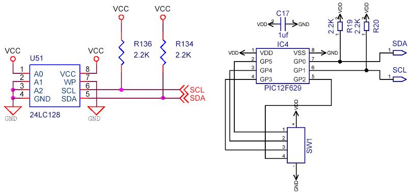

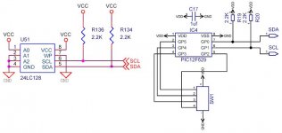

Re: No21 and No22 pin of ES9008S-IC chip
Correct. firmware lives in the 24LC128 and PIC12F629, not in the ES9008.
nagaesan said:ES9008S IC chip
No21 pin is SDA_SO7,
No22 pin is SCL_SO6,
No19 pin is GND.
SCL and SDA are controlled by 24LC128 on ES9008S ESS eva-board.
SCL and SDA are controlled by PIC12F629 on Buffalo board.
>there is some memory area
Oh I'm sorry, DAC itself only has registers.

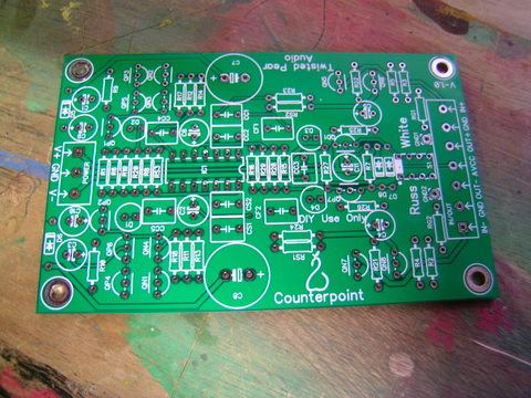

Re: Counter point DAC
The Counterpoint is indeed intended for the ESS9008/ES9018, but it would work equally well with any current output DAC. It is meant specifically our Buffalo DAC. I am not sure how you would make it work with the EVAL board as you would need to exclude the on-board I/V stage. Probably would require some board surgery.
There is a quad opamp on the board, but it is only used to set bias voltages and act as an integrator. It does not do the actual I/V conversion.
It could be called a type of fully symmetrical folded cascode current conveyor design, but not a classic current conveyor. I am really not sure how to classify it.
One cool feature is that the output can be balanced even if you use a single ended current source, but you can take only one end and use it single ended with almost no THD penalty.
I can't wait to fire it up and give it a rip outside the simulator. The earlier prototype worked very well. So hopefully the testing goes ok.
