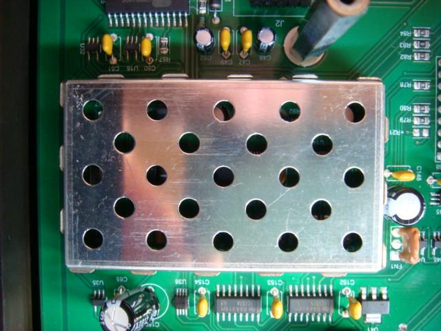

ESS Sabre Reference DAC (8-channel)

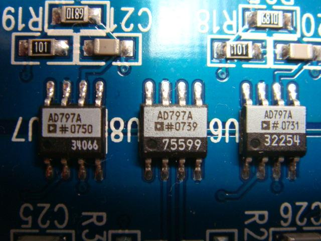

ES9008S eva-board I/V stage
This photo is ES9008S eva-board I/V stage close up.
ESS choice Analog Devices AD797.

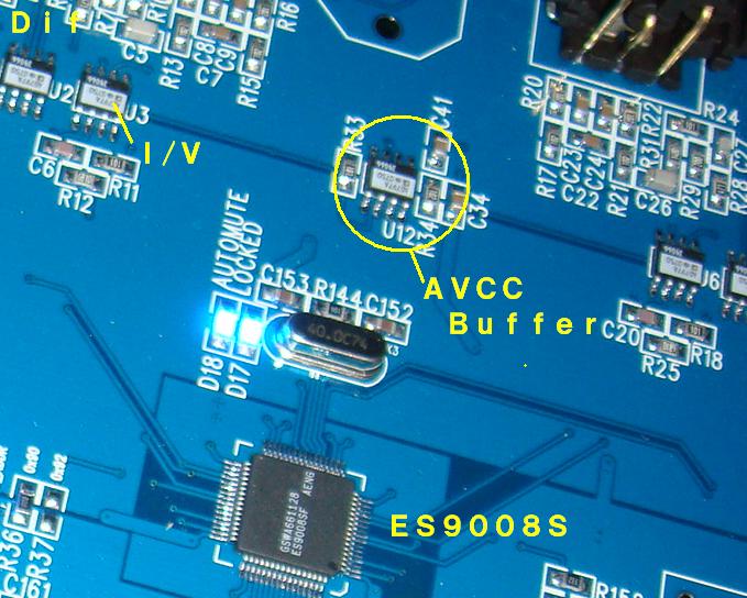

Re: Why McIntosh use CS8416?
nagaesan said:
McIntosh MCD500 has 192kHz24bit digital input RCA terminal.
I checked this Digital Interface Reciever IC, it was CS8416.
I wonder why McIntosh uses CS8416 conventional PLL DIR-IC, because ES9008S has very nice non PLL / Time stump based DIR circuit.
Do you know who it is?
My guess is they used it for convenience, since they needed to multiplex multiple SPDIF inputs.
The ES9008 has no provision to multiplex SPDIF.
Cheers!
Russ

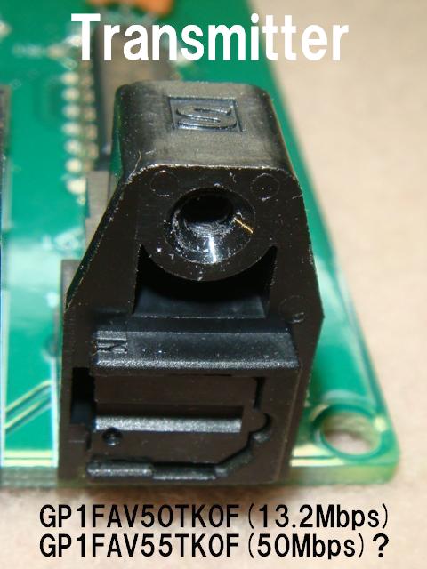

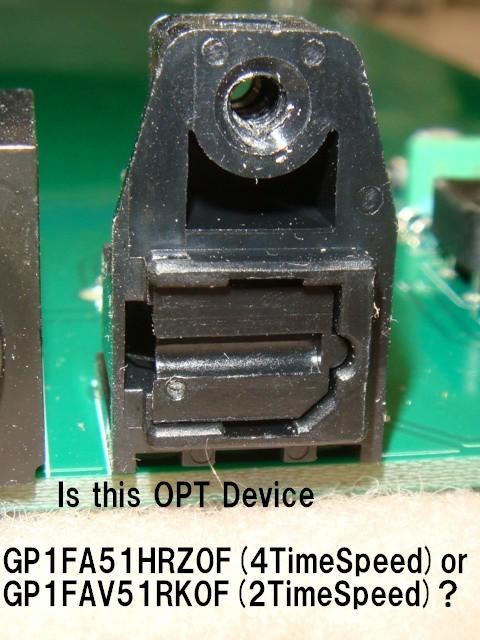

TOS-Link reciever device of MCD500
Recieving OPT Device is this.
I do not know this is 4times speed(DVD-Audio 192kHz is OK)
or 2times speed(DVD-Video 96kHz)
But I already checked it, MCD500 can recieving 192kHz 24bit.
How I checked it, that I build up Audio PC, installed RME HDSP9632 sound-card.
RME HDSP9632 support 192kHz24bit
And I used "Adobe Audition" sound editting software.
http://www.teddigital.com/prx06.htm

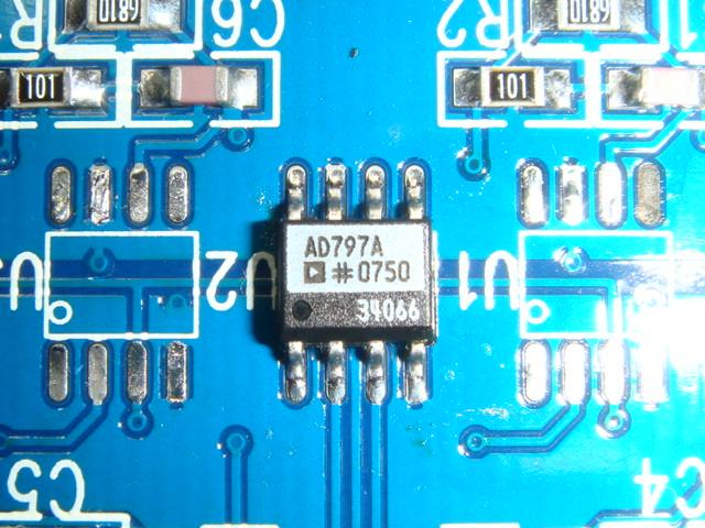

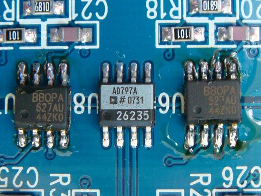

OPA627 on ES9008S eva-board
Today I changed I/V OP-Amp on ES9008S eva-board AD797 to OPA627.
I think AD797 is a nice low noise good performance OP-Amp.
But I want more faster OP-Amp for I/V stage.
I changed I/V OP-Amp, AD797 to OPA627.
OPA627 is high slew rate and short settling time than AD797.

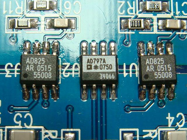

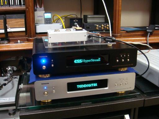

AD797 or AD825 or OPA627
I have 3 ES9008S eva-board.
No1. board is not modify, this I/V stage is AD797.
And I put this eva-board in a silver color chasis.
No2.board is modified I/V stage, AD825.
And I put this eva-board in a black color chasis.
No3.board is also modified I/V stage, OPA627.
This eva-board is naked.
