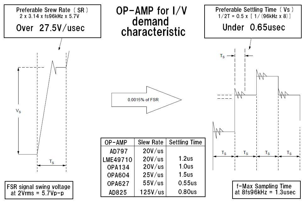

AD797 or AD825 or OPA627
Sound focus
No1. ES9008S+AD825
No2.ES9008S+OPA627
No3.ES9008S+AD797
No4.YM3623B+SM5803+PCM1704+OPA627+BUF634
Sound clarity
No1.ES9008S+OPA627
No2.ES9008S+AD825
No3.YM3623B+SM5803+PCM1704+OPA627+BUF634
No4.ES9008S+AD797
Dynamics
No1. YM3623B+SM5803+PCM1704+OPA627+BUF634
No2. ES9008S+AD825
No3.ES9008S+OPA627
No4.ES9008S+AD797
