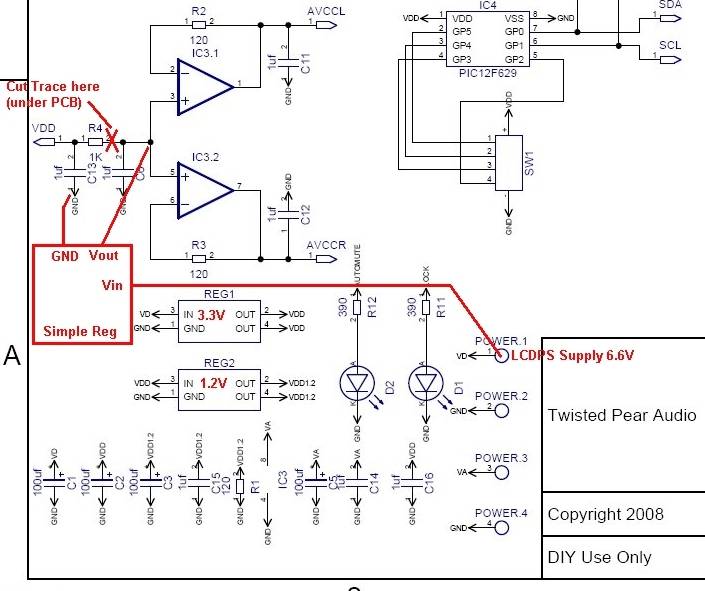

Algar_emi said:Hi Russ. I assembled the Simple Reg modification PCB for the Buffalo and I'm testing it right now. In your latest schematic with notes, you mentioned that the Vref can be changed by changing the R3 value.
Reference to the enclosed schematic with my measurements results.
I can only get 2.8V at Vout, changing R3 cause small variation from 2.75 to 2.85, but that about it. All the other currents you recommended (R4 > 4ma, R6 > 1ma, R1 >4ma) are meet. The two leds reference source D1-D2 (green leds) is 3.9V. The way I see it, R2,R3 form a simple voltage divider, not loaded by the high input impedance of IC1, so the ratio of Vled X (R3/R2+R3) should fix the Vref value. I should be able to adjust R3 to get Vref 3.3V but I cannot. By the way I'm using the circuit with jumper (short) used for Re and Rf.
Any suggestions?
Is the value of 2.8V enough for the Vref value on the Buffalo PCB, or is it too low?
Thanks for any help you can provide.
My first guess is that the current through R6 is too low, try reducing its value I would try 470R.

One more thing. I only used the LT1115 for simulation. It actually is a not a good choice for the cct. Try opa227 or something similar that can run down to 5V.
My fault for not noting that.

Simple Reg is working like a charm. Problem was very simple, since I made my own PCB two layers, but without plated hole vias, two connections were missing between the layers, one being the Op-Amp supply pin
Suffering a cold these days, I missed this stupid little detail. Should stay in my bed
Install the jumpers, fine-tune R3 and perfect 3.30V REF. Thanks Russ.
Here a quick connect diagram for the Simple Reg connection to the Buffalo.

Your very welcome.
One note. I actually designed that reg with the idea of using it to actually power AVCC, not just provide a reference. But it sould work just fine in either role.

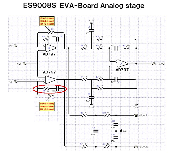

Consideration of I/V Converter
ES9008S and ES9018 are super high performance DAC of the current output. IC. It is high sound quality than Asahikasei AK4399.
We high-end enthusiast tested many OP-Amps for I/V conversion circuit. This time, we were able to borrow EV-borad of ES9008S, we tested I/V converter OP-Amps for Hiper Stream DAC .
How do you think about I/V Converter's dynamic performance that SlewRate and Settling Time at DC to 40kHz?

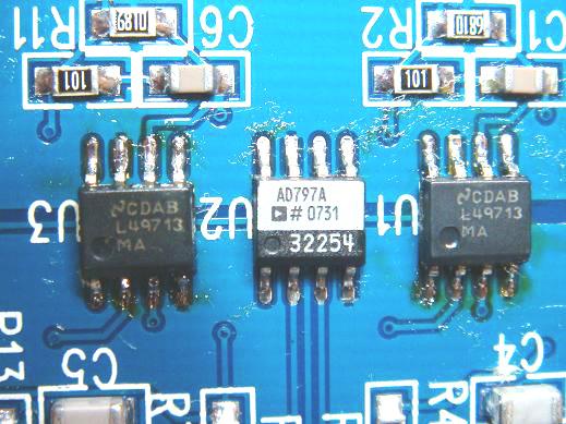

LME49713 for I/V converter
Thank you Mr.audioman54, for infomation of good performance OP-AMP.
Now I replaced AD797 to LME49713 on ES9008S EVA-Board.
But I do not hearing this sound. I must go to my office.
When I come back my home, this evening, I will check waveform by oscilloscope, and hear LME49713 sound.
And next saturday, I will go to high-end audio shop IKEON Tokyo Ikebukuro, for comparing AD825 vs LME49713 with audio enthusiasts.

This will probably not work very well. The LME49713 is a current-feedback opamp. It is not a direct replacement for a AD797 (voltage feedback).

LME49713 and LM7171 for I/V converter and AD797 non buffered output
Mr.audioman54 recomended me LME49713. So, I would like to try it.
I will check tonight LME49713 I/V converter's waveform by my 100MHz oscilloscope, and I will listen and compare LME49713, AD825, OPA627,AD797 I/V sounds by my home system.
After my home hearing LME49713, if this sounds good, I will go to audio shop for enthusiast's hearing test.
A few years ago, I already tested LM7171 I/V stage my PCM1704 DAC. This DAC has a buffer. (ES9008S EVA-Board has not a buffer.)
Then the LM7171 I/V circuit did not do an oscillation, but sound was not good than OPA627.....
But I already bought LME49713, I try this and I will report.
P.S
My anxious point
1) Super High Performance DAC of Noise Shaping Type has ultra high frequency quantized noise, I think I/V stage OP-AMP needs more Slew Rate and Settling Time when using PCM1704.
2) When using balance output, the AD797 I/V stage has not buffer.
3) When using unbalanced output, the AD797 differential amplifier on ES9008S has not buffer and series resister for prevention of oscillation.
