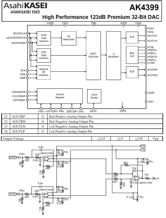

nagaesan said:Cauhtemoc,
>The ESS DACs are voltage output just like the AK4399 or AK4397
May I ask a question?
Can AK4399 have outside I/V comverter?
No. The AK4399 and all other switched capacitor DACs are voltage output by nature, so you cannot use an external I/V converter.
I like outside I/V DAC-IC
Cauhtemoc,
We can select ES9008S(ES9018) output signal, voltage mode or current mode.
But AK4397(AK4399) ouput is only voltage mode.
I like outside I/V DAC-IC.

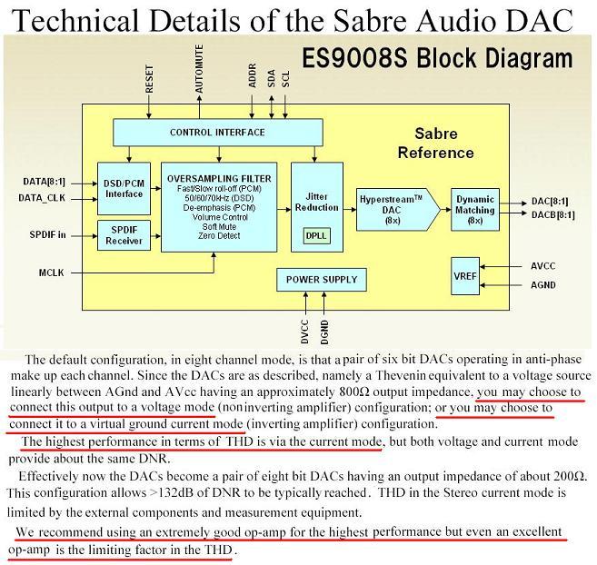

The ESS DACs are a bit special. They are voltage output DACs, but they have a small resistance (~200 ohm) in series with their output. This means that they can be used either into a high impedance as a voltage output DAC, or into a low impedance as a current output DAC.
A "true current output" DAC is one which can only be used as current output, for example the PCM1794 or AD1955.

Re: Has ES9008S 200ohm series register inside IC?
No its not exactly like that.
Each symmetrical DAC segment has a fixed output impedance (R). Hint, "R" is a pretty high value.
There are "S" segments per channel. You could probably guess this number pretty easily.
4 channels in parallel per DAC.
Now its just simple math.
R / S / 4 = 195.3125 ohms
I can't give any more details.

What I said is true from a functionality standpoint, but I simplified it somewhat to make it easier to understand.
But if you want the gritty details, the output of each DAC consists of 64 MOSFET switches, and each MOSFET switch has a resistance of 50k Ohms. This means that each channel has an output impedance of 50k / 64 = 781,25 Ohms, and 4 channels connected in parallel has an output impedance of 781,25 Ohms / 4 = 195,3125 Ohms.
Russ, you already knew this, but others probably did not. Dustin has also previously revealed this information publicly, so I don't think I'm violating any NDAs by posting it.

nagaesan said:Are there small series resisters insede ES9008S?
Well essentially yes.
That is what Cauhtemoc and I have been describing to you.
There are lots of 50K output impedance voltage sources in parallel.
