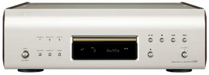

And now I asked DENON DCD-SX to lend this weekend.
DENON DCD-SX is adopted AsahiKasei 32bit DAC AK4399.

Re: Infomation of 32bit DAC audition party
nagaesan said:
Hello every one.
Now I had a infomation that AsahiKasei AK4399 exhibition was decided.
