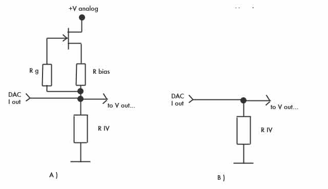

I have some Q,
about Sabre ES9008 I-outputs :
Are they Current Source Output or Current Sink Output type?
Which one of theese two diagrams, I uploaded
shoud be better for the passive I-to-V conversion?
Which value is the lowest value of passive R iv that I could apply,
and not to damage dac chip?
Is the lower value of RIV lowering the distorsion for ES9008, same like in
for instance pcm63 and tda1541 dacs?
Or not?
I put, just for the test 1K (at each dac Iout, each -,+... )
the chip remain the just slight warm...
could someone answer please?
thanks

Zoran said:
I have some Q,
Or not?
thanks
Hi Zoran,
THE output looks like a voltage source with 781.25 Ohm output impedance. "Current mode" is simple when you put the output to a virtual ground and some level (we use 1.65V) then therefore use the current though the 781.25 Ohm in a IV stage. I is not a typical "current source" or "current sink" like the other chips you mention. You could short the output of the chip to ground or AVCC without damaging the chip.
Hope this info helps
Dustin
Hi Dustin,
thanks for answering...
It is from help to me.
I designed open topology, so I have Vref of 3.3V analog supp. for each channel,
and also Vref of 1.65V in case of using standard OP IV conn.
but passive R-IV, ball. tube out, SE output transformer is an option too,
as well as current buffer...
Do You have any experiance or idea, how low can I go with passive R
(because I need lower Vout before tube stage, gain of the tube stage will be probably
about 15 times... So it will be nice to have about hundered mV after R iv).
You can simply use a resistor to AGND or any buffered voltage from AGND to AVCC.
There is nothing more to it. 🙂
If you use AVCC/2 then your DAC will not have to sink any current through your R when idle.
Cheers!
Russ
