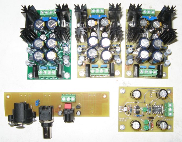

Just completed most of the support PCB for my Buffalo. One LCDPS for the digital supplies, two LCBPS (my own PCB and parts choice) for the upcoming CounterPoint ver2, the digital input PCB with AES/EBU, True 75 ohms BNC and optical SPDIF using the TORX142L (192Khz speed support). The RCA is not mounted because I'll use the USB input card for the forth input into the CS8416 MUX.
There is also the small Simple Reg PCB for the Buffalo analog reference modification. The MUX is all assembled as well as the Buffalo. I just need to complete the USB card and wait for the Counterpoints.

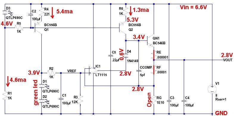

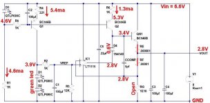

Hi Russ. I assembled the Simple Reg modification PCB for the Buffalo and I'm testing it right now. In your latest schematic with notes, you mentioned that the Vref can be changed by changing the R3 value.
Reference to the enclosed schematic with my measurements results.
I can only get 2.8V at Vout, changing R3 cause small variation from 2.75 to 2.85, but that about it. All the other currents you recommended (R4 > 4ma, R6 > 1ma, R1 >4ma) are meet. The two leds reference source D1-D2 (green leds) is 3.9V. The way I see it, R2,R3 form a simple voltage divider, not loaded by the high input impedance of IC1, so the ratio of Vled X (R3/R2+R3) should fix the Vref value. I should be able to adjust R3 to get Vref 3.3V but I cannot. By the way I'm using the circuit with jumper (short) used for Re and Rf.
Any suggestions?
Is the value of 2.8V enough for the Vref value on the Buffalo PCB, or is it too low?
Thanks for any help you can provide.
