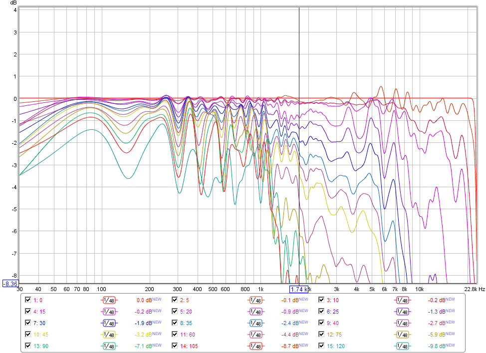

Normalized polar plots:
3 cycle frequency dependent windowing plot for bare pipe:
The normalized view is extremely good predictor of off axis response if driver is equalized perfectly flat on axis. With driver in bare pipe roll off going off axis is nearly textbook perfect. The 3cycle windowing is indicative of transient attacks in music source smoothly loosing their edge as radiation progresses off axis.
16 cycle frequency dependent windowing for bare pipe:
Above, the longer windows introduce some ripple. At 16 cycles, above about 2kHz the train of 16 waves is still short enough that room reflections are absent. Below 2kHz, floor, ceiling, and then three wall reflections become an influence. Reflections of fourth wall, the back wall, come into play below about 600Hz. Also as mentioned in prior posting, pipe radiation is likely factor at longer wavelengths. Of note is magnitude and width of consecutive peaks and dips. They are narrow with high Q values, and audibility is generally not considered an issue with human hearing.

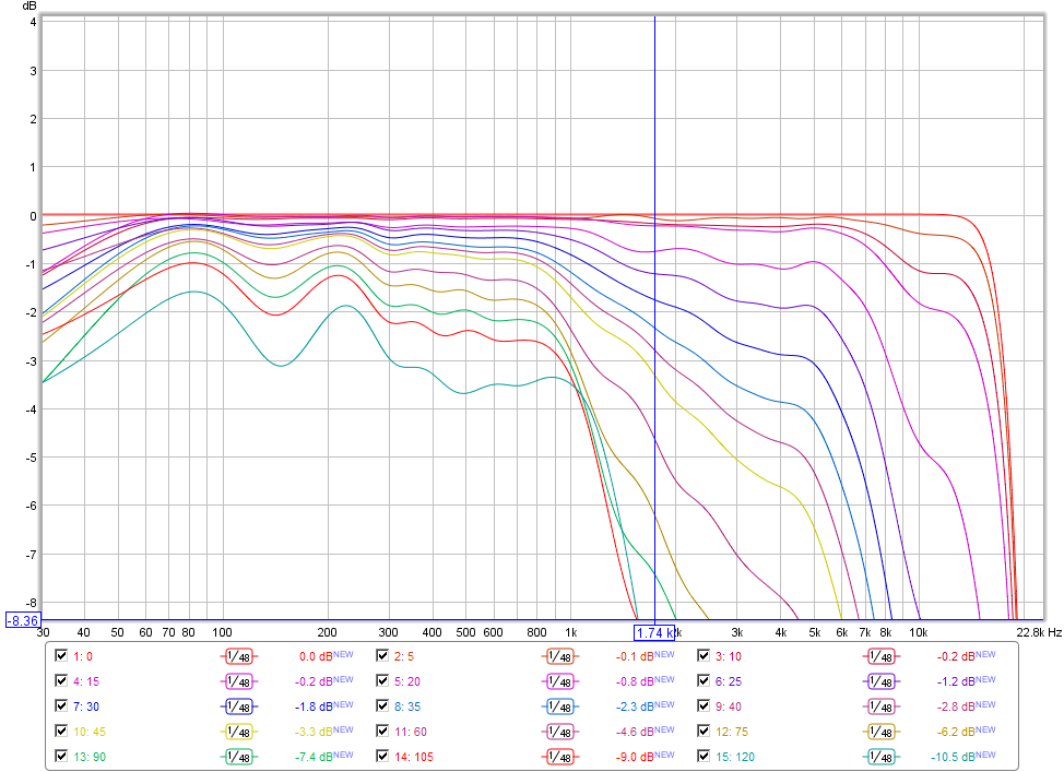

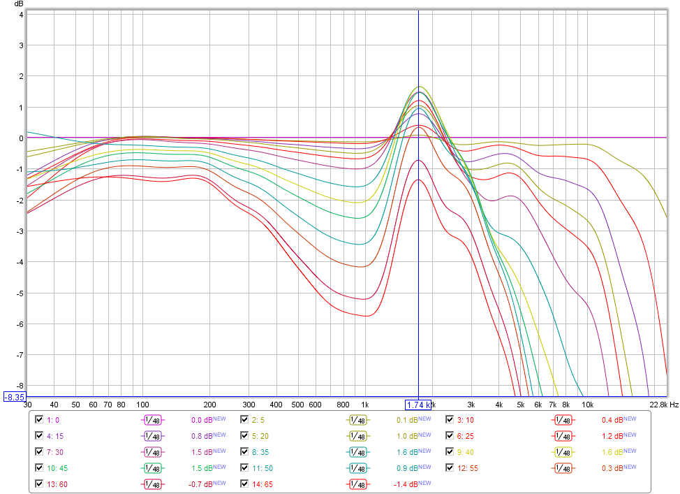

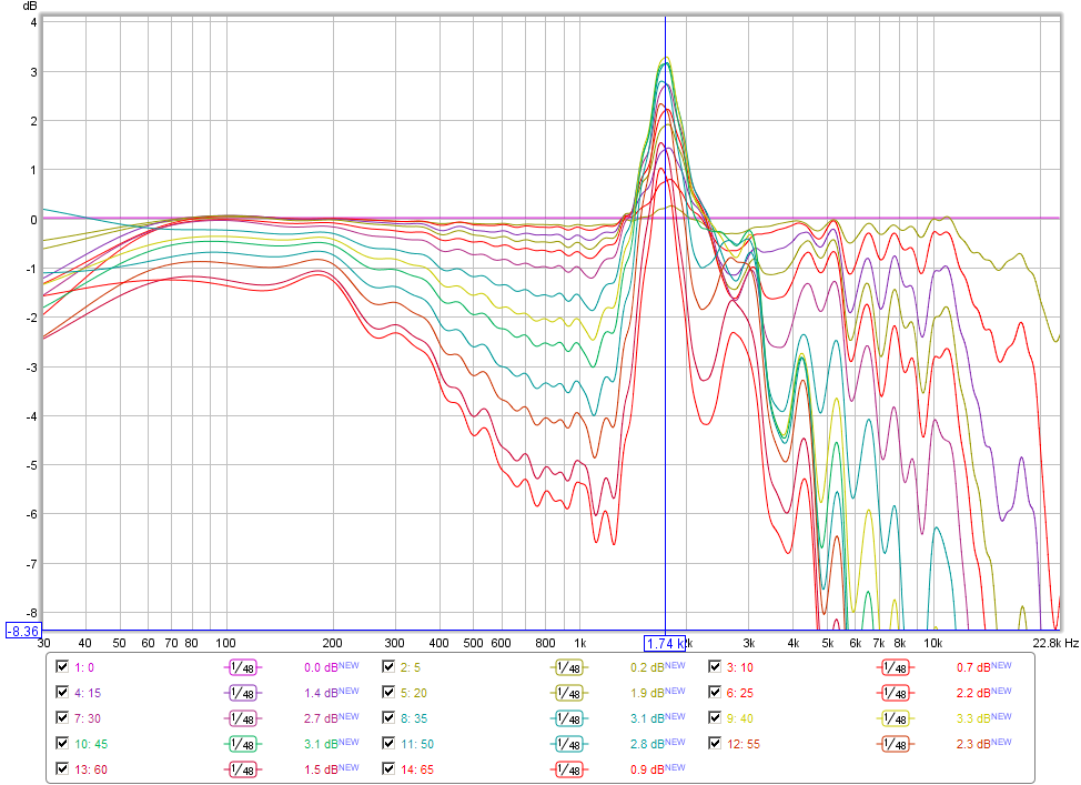

3 cycle frequency dependent windowing for pipe with baffle:
Here we see sound going in mostly 2pi space pattern in octave centered at 1.74kHz. No form of equalization will fix this. Some manner of wave guide is required. At 1kHz a cardioid pattern is indicated, and this collapses to fairly monopole as frequency drops to 200Hz.
16 cycle frequency dependent windowing for pipe with baffle:
Ripple magnitude in plots below 1kHz are tiny. The cardioid behavior in this region reduces reflections from side walls, front wall, floor and ceiling, and also increases direct sound.
It is easy to see that as baffle size decreases so will cardioid behavior.

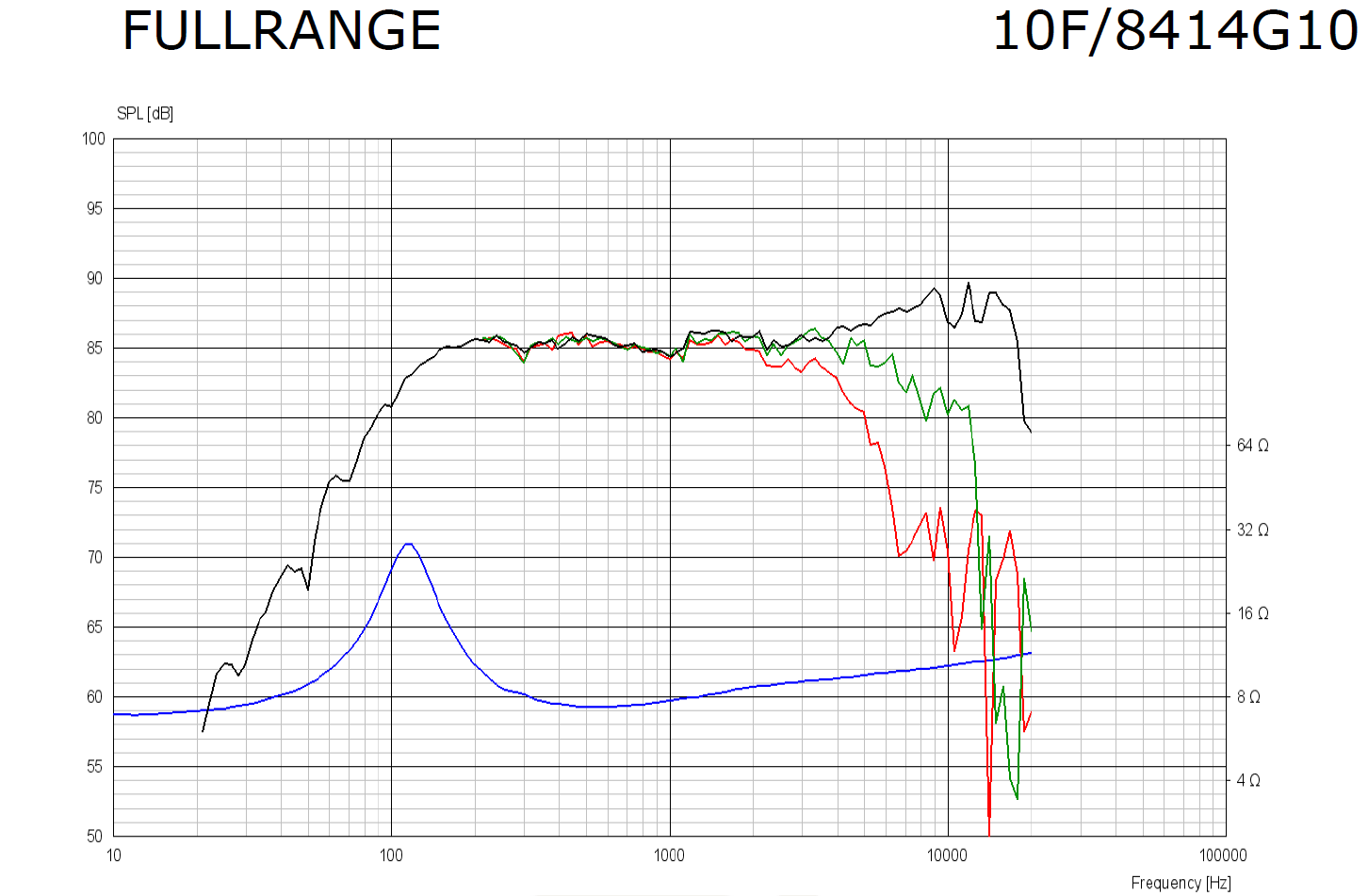

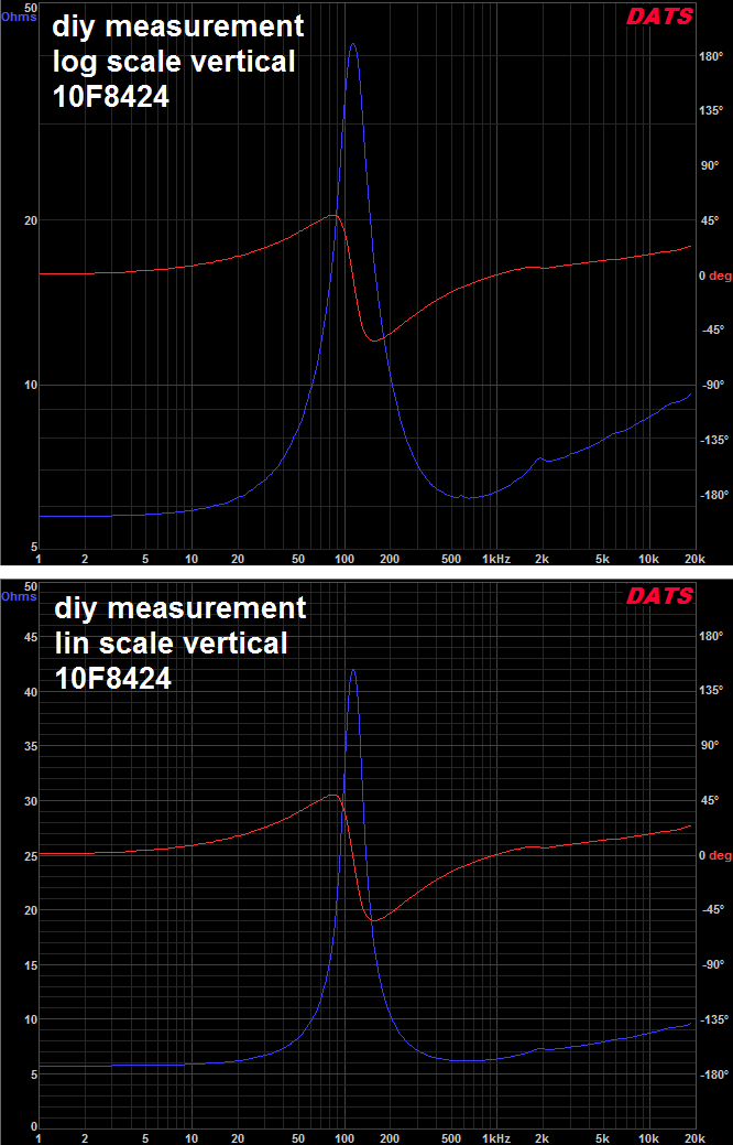

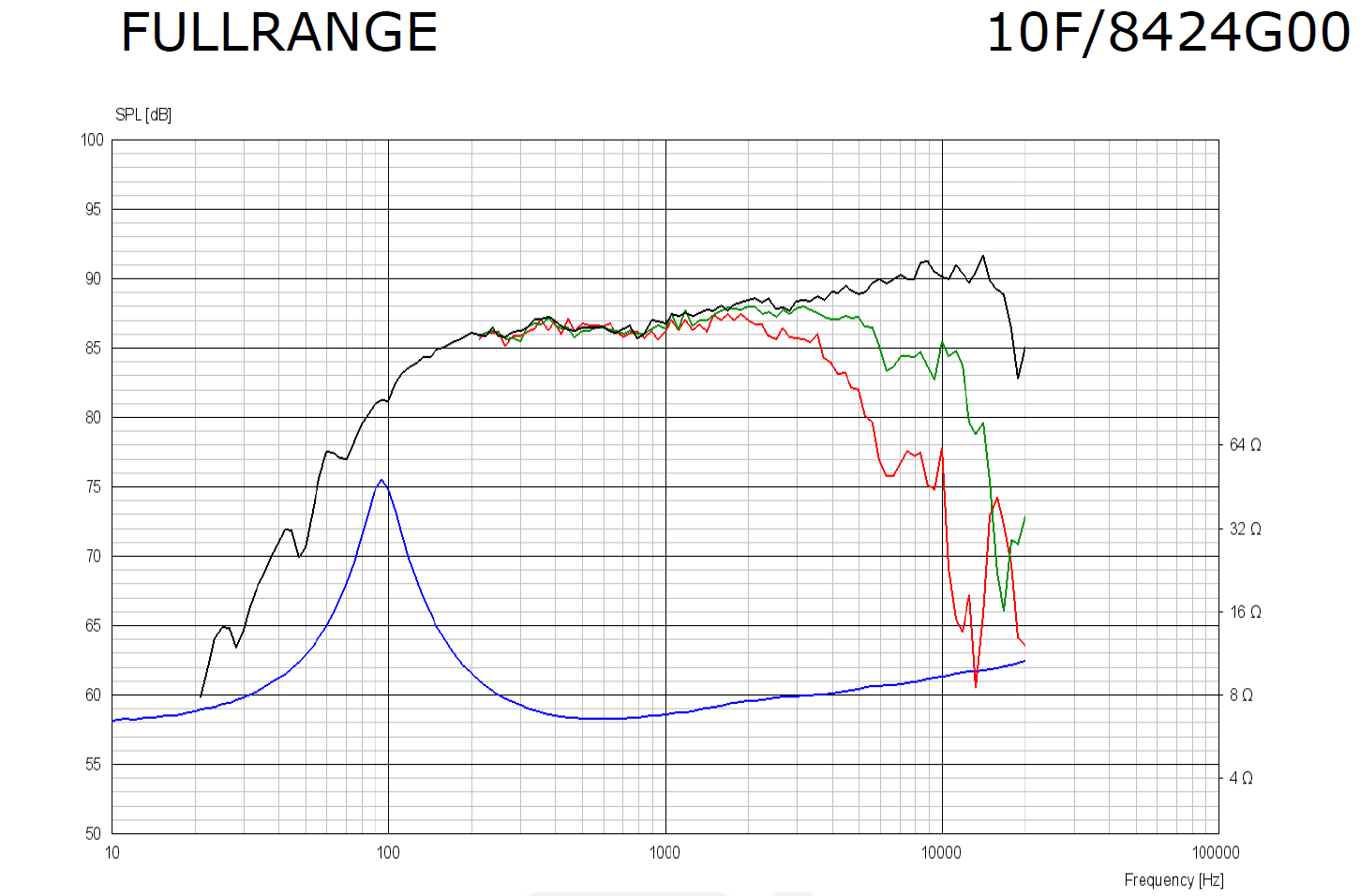

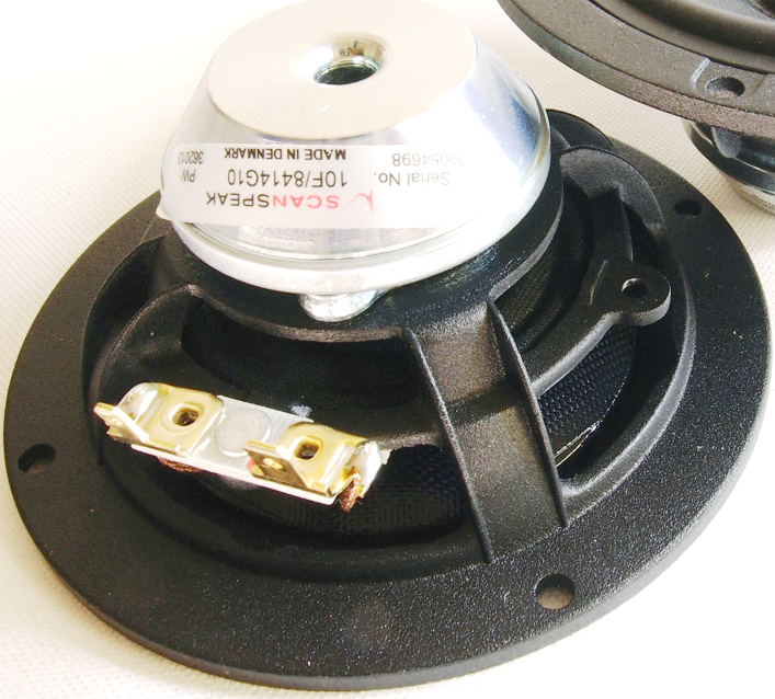

To better understand the two baffle setups is there any chance you would share two pictures.
Think some data can be related to manufacture datasheets if one zoom in, below is 10F/8424 datasheet and my diy DATS plots and think 1,74kHz pattern is some reflected in both.
Below is also datasheet 10F/8414 and hardware picture because it seems have the ventilation behind spider.

That is really interesting that 8414 has spider ventilation. You would think that is better. Why does 8424 eschew such things?
LOL, I also had to get used to Bw's 1dB per division plots. 🙂
I said that looks really ugly for a 10F! But it was just 5dB baffle step loss. It really does look like a step.

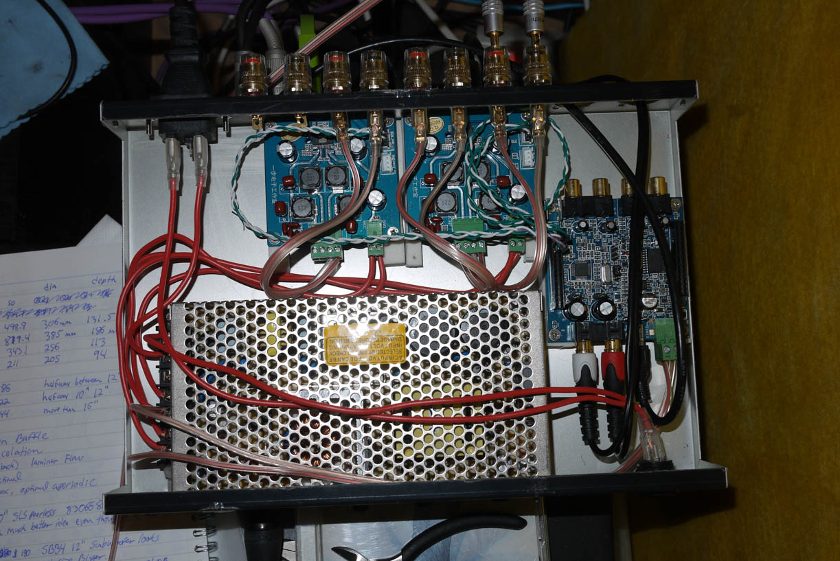

We both use basic 2x4 analog input miniDSP and dual TPA3116D2 amps (analog input) per miniDSP. So for 3 way stereo you need qnty 2 miniDSP 2x4 and 3 stereo amps as you suggest. This is the least expensive route. MiniDSP allows use of custom or boutique I2S DAC and ADC if you want. There is I2S bus on board. There is also all digital miniDSP 8 channel called nanoDIGI and you supply all your own SPDIF ADC's and have I2S or SPDIF inputs. That costs a lot more. At this time I am quite happy with the sound quality of stock ADC and DAC built in the $80 2x4 miniDSP. The 8 ch miniDSP have a more powerful processor and allow longer digital delays.
Cost will be about $150 for a 4 ch miniDSP with amps.

In regards to DSP and amps:
I only have experience with the 2-in 4-out raw miniDSP board.
miniDSP Kits : MiniDSP 2x4 kit
This board has the AD/DA built in so you can just run analog in and out from the board. No need to worry about I2S or other digital connections, but I think they do provide them on one of the pin-outs if you really want to explore it. I just use a pair of YBDZ TPA3116 boards, a Meanwell NES-150-24 and one miniDSP 2x4 and wire it up in analog. Works fine for a stereo pair of 2ways. I just have the one box with 8 binding posts and run "bi-wire" cables. Works like a central control/amp box.
For 3way or 4way speakers, I know several people use a pair of the miniDPS 2x4 with 4 TPA amps (8 total output channels). I think most people centralize the DPS/Amps and then run several pairs of speaker cables. It is easier than trying to make an "active speaker" with the amps and dsp inside the box and run RCA input.

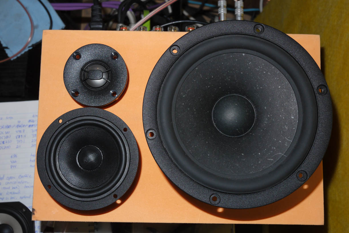

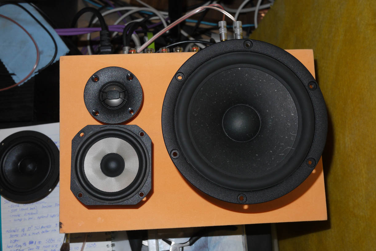

Two new drivers arrived today. TG9FD-10-08 and a small neo tweeter (vifa DQ25SC16-04). This is the tweeter that Zaph really likes and uses in his ZA5 speaker. Wanted to get a small tweeter to try with my Satori to get even closer center-to-center distance. And to give me something to compare to the RS28f tweeter.
Just did some raw driver listening and both sound nice. The TG9 actually sounds really good as a raw driver (no baffle, no box, dipole). I can see why barleywater likes the TC9/TG9 in open baffles. Might do a quick open-baffle with the TG9 and DQ25 in mini 2way.

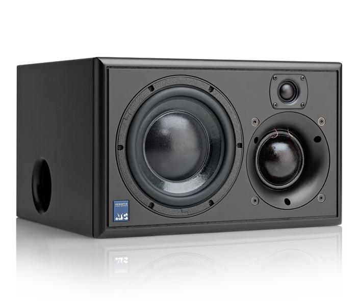

Some photos, and yes I am pondering a 3way ATC SCM25a / KH310 style speaker with the satori

Usefull picture from the box amps ! Hey you're Lucky : you can buy with a cheap price the excellent Oyaide interconnect at Yodobashi Camera ! ( I use the across 750 iirc ) !
