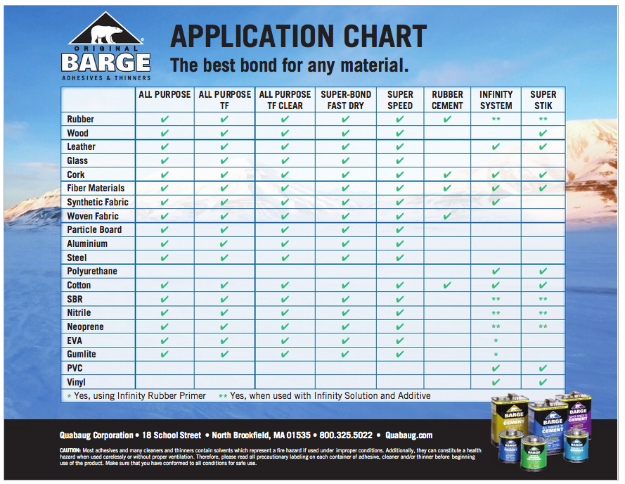

Here is the chart for materials you can use with the different Barge contact cement formulas.
508019d1444368019-eva-foam-performance-speaker-enclosures-barge-cement-chart-copy.png
The original contact cement formula (neoprene base like the konishi G17) is OK for EVA, but not PVC, vinyl or polyurethane. I really don't know if it would work for foam-core or XPS foam.
I will call this G17 "neoprene based contact cement" from now on. It is not really rubber cement.
