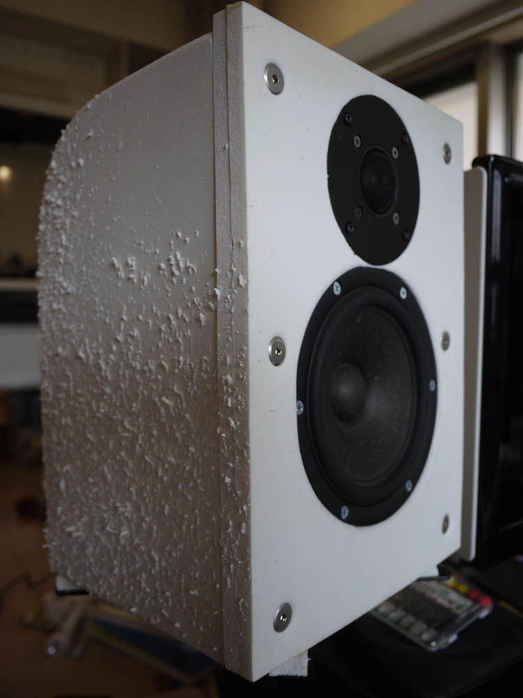

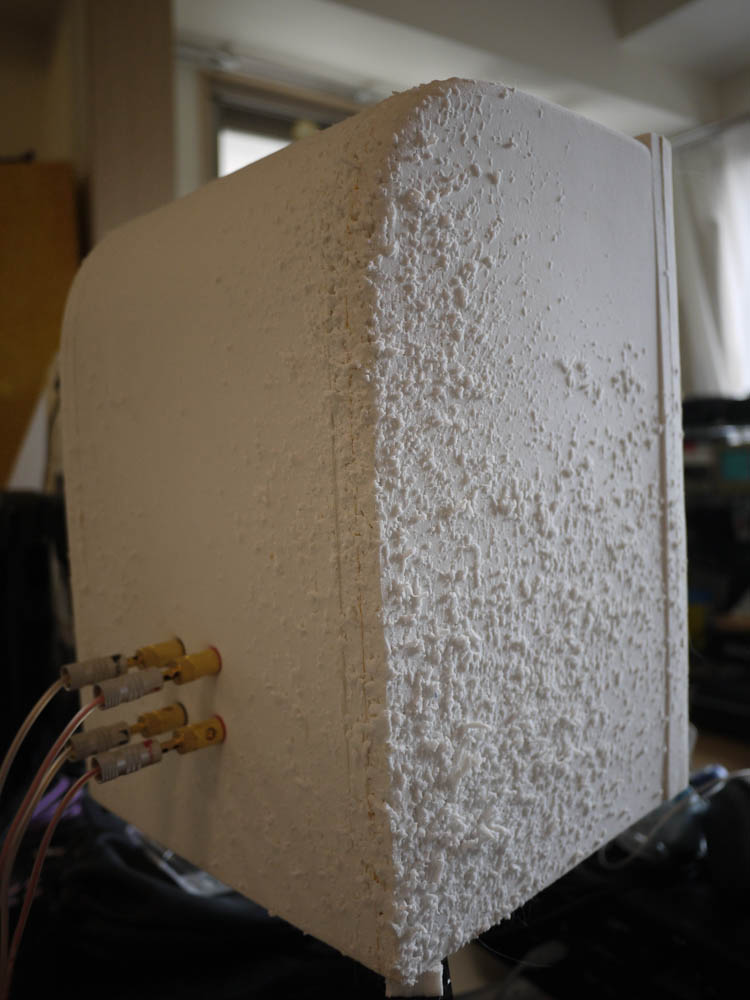

I did try the painted EVA and I have to admit that I felt like it sounded better before I painted it. I also really love the clean white look of the EVA foam that I get here in Japan. So right now I keep all my EVA speakers in the natural white. To me it creates a very nice look of black drivers with white speaker (especially keeping the front panel white EVA). I also like the more rounded organic shapes I can create with the bendy EVA compared to the rigid XPS. So granted I am a single data-point female but maybe see if your girlfriend would prefer white speakers to wood covered speakers. I definitely prefer white speakers.
Unfortunately my cat has decide my EVA speakers make excellent scratching posts so they don't look like they used to. But maybe this is making them sound better adding some random diffusion :)

oh i can see it now, an emerging market.... cat distressed EVA speakers (will the ones distressed by Persians be more highly prized?)
lol :) well if the self-destructed Banksy girl with the red balloon is any indication then maybe the world does add value for "properly" destroyed art.
ps: I hope everyone realized I was joking about the destructed speakers sounding better. I honestly don't know. Luckily he hasn't touched the front of the speaker where I think the most effect of diffraction/diffusion happens.

I would be very sad if my baffles look like Jeshi´s enclosures... too much work and money spent. I´m happy that my daughter is old enough to know to NEVER EVER TOUCH daddy´s loudspeakers...
Mushroommunk, like Jeshi I prefer the tactile and visual sensation of the (unscratched) finely sanded EVA foam (mine is 125 kg/m³, the density of the material definitely plays a role in these applications), she prefers hers in white, I prefer black. Even my wife likes the tactile properties of the finely sanded material a lot. It´s like suede, very smooth.
I´m also conform with Jeshi insofar as I prefer the non-painted surface to anything else, have tried this a few iterations before, and prefer the sonics of the unpainted material. Perhaps a matter of surface roughness and reflection properties?

Mattes your speakers look amazing so I would also be sad if I had put so much effort into that level of perfection and my cat destroyed it. At some point I am going to replace my destroyed enclosure. Just waiting to see if I like the vented version more than the sealed version.
Ouch! Good thing she did not touch the Satori cone or surround. Maybe you need to make a sacrificial EVA post - shaped like a speaker as the decoy? I found that just taping clear packaging tape over an area frequented by claws makes it smooth and unattractive for purposes of sharpening claws. My 21yr old cat passed away recently, his 18yr old brother is still around, completely blind but gets by very well based on good memory, and sense of touch and smell. Both are so old they stopped sharpening their claws so they had to be clipped regularly else grow as a curved blade into their foot pads.
Maybe a thin hardwood veneer on the sides and backs may reduce the scratching and make it look more like a conventional wood speaker. I admit the white EVA looks great though.
He seems to only scratch it to get my attention when I am too focused on the computer/movie/project and he knows that if he scratches the side of the speaker I stop what I am doing and freak out and scream stop, but he gets my attention. Unfortunately this has gone on over a year now and you see the result of this. I honestly feel we are stuck in this pattern and all I can do is either cover the side (like you say) or just accept that I will need to rebuild the left speaker about once a year. But you are right, I am so glad he has focused on the back side of the speaker rather than the front with the drivers and the foam. I bought some metal grills to protect the fronts and still need to install them. Will add them when I make the new vented box. But I don't think it will look as nice with the metal grill and it might alter the sound. So difficult decision.
