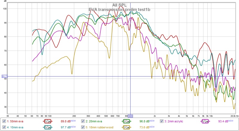

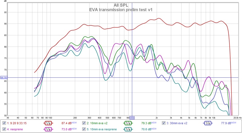

Well have a look at some of the tests I did like some Panel resonance tests: here
Panel transmission tests: here
I think EVA absorbs sound (sound barrier, panel leakage) as good or better than neoprene especially in high frequencies. And I think neoprene is considered similar to felt for lining the walls of speakers for sound absorption. Look at the 10mmEVA+4mm neoprene, it has a -35db suppression of transmitted frequencies from 7khz and up. Even a simple 10mm EVA alone give -25db to -30db suppresion from 7khz up
I think for your application, you don't need the high-spec EVA that Mattes and I are using for structural support, so you can try the cheaper lower density EVA floor panel foam like I linked for $20au. It is cheap enough that it might be worth trying to experiment with it.

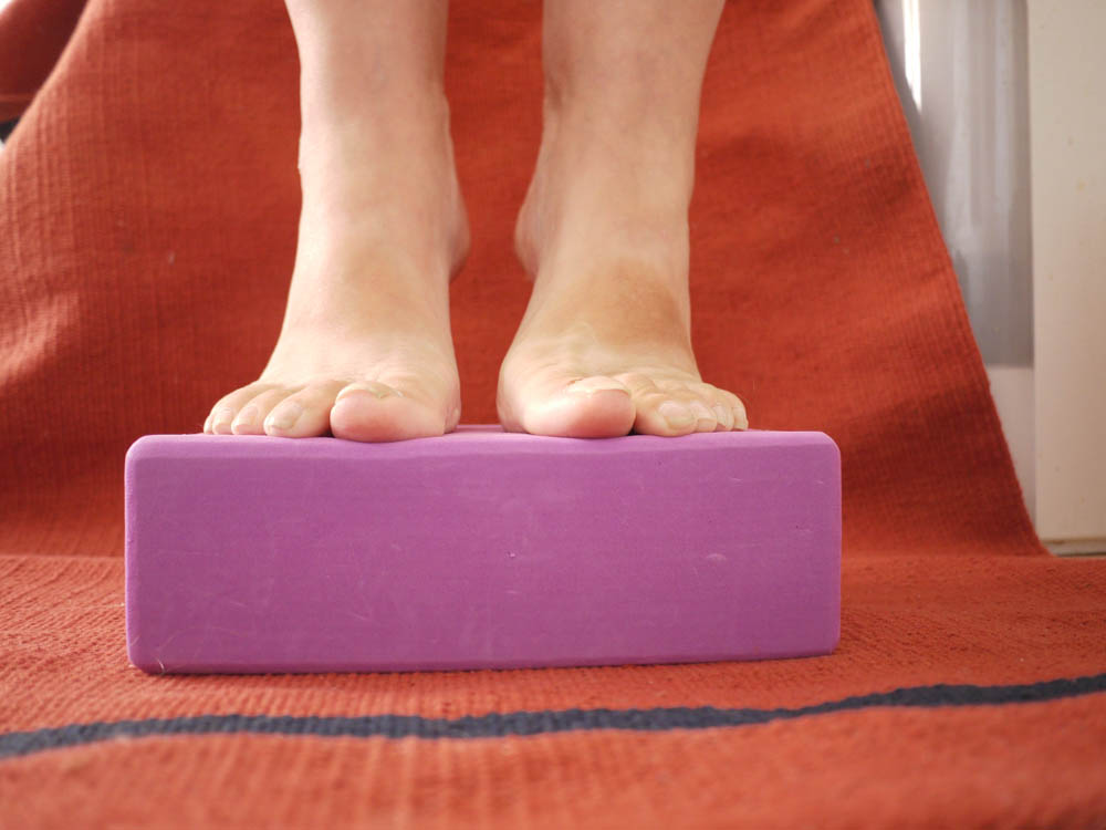

If you ever had flipflop sandals or Crocs then you have probably seen EVA foam.

Maybe this will help explain what EVA foam is. It is a strong foam. Here is a picture of my 70kg/m3 EVA yoga block supporting my 80+kg weight with minimal compression. The foam that I use for speakers is 110kg/m3 density so even stronger. But EVA is also used as a building material under floors for vibration dampening, in gyms as floor mats, under machines for vibration dampening, and within walls for sound isolation (covering whole internal space so no leakage around edges). So it was this combination of strength, vibration dampening, and sound isolation (absorption) which made me explore this (and fall in love with it) as a speaker enclosure/front-baffle material.

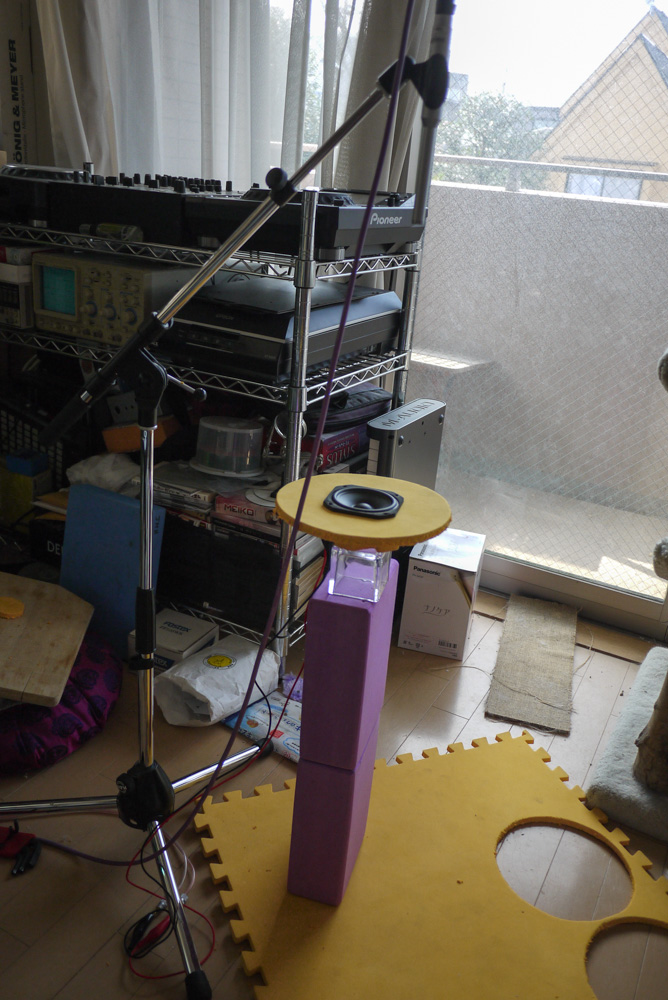

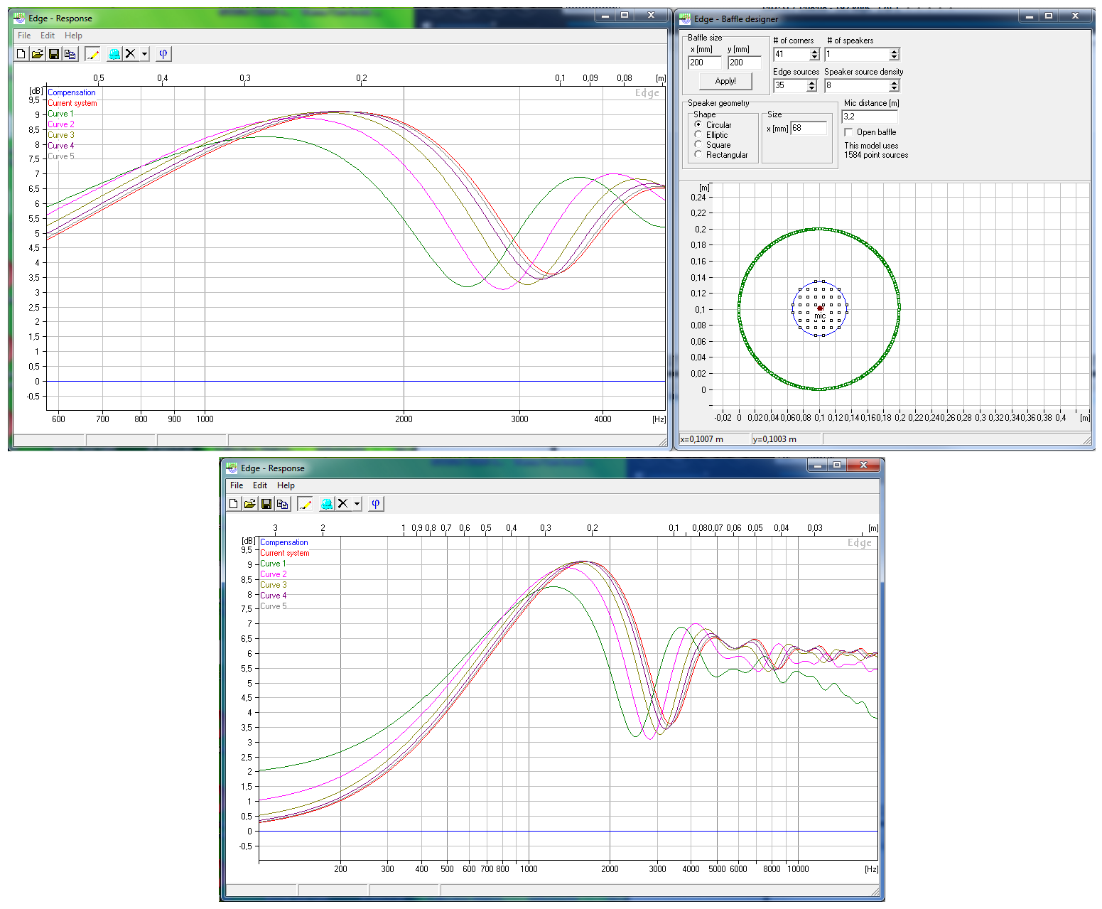

I want to duplicate the baffle diffraction test of linkwitz where he tries to induce a diffraction effect
Diffraction from baffle edges so that I can get some practical and empirical data to help in designing my flower baffle. For my first experiment, I decided to make 20cm round disks. A round baffle should create a dramatic baffle diffraction effect at a single frequency. By linkwitz calculations for a 0.2m diameter disk (Frequently Asked Questions) I should have a rise at 1700 and dip at 3400hz, but my measurements give me a consistent 1250hz rise and 2500hz dip from my round disk baffle. It's consistent so for now I will just accept it, but it would be good to figure out what is different or wrong with the calculation.
I am planning to do other diameter disks next. The idea is to see if I can actually create a tuned flower baffle to the driver (to create designed dips rises to the baffle effect).

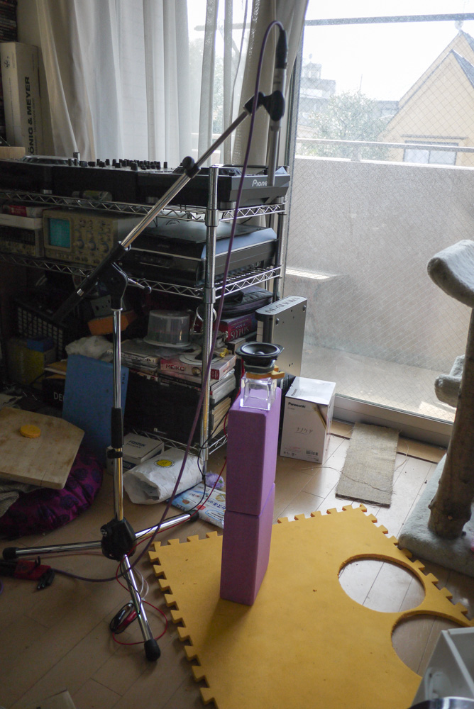

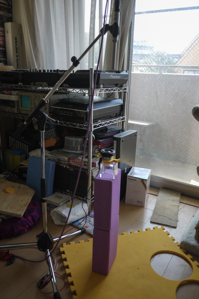

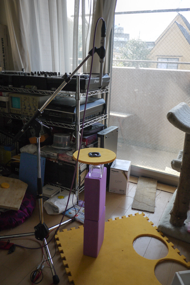

So here are some pictures of my test setup. A bit different to Linkwitz's but the idea is the same. (please forgive the messy background)

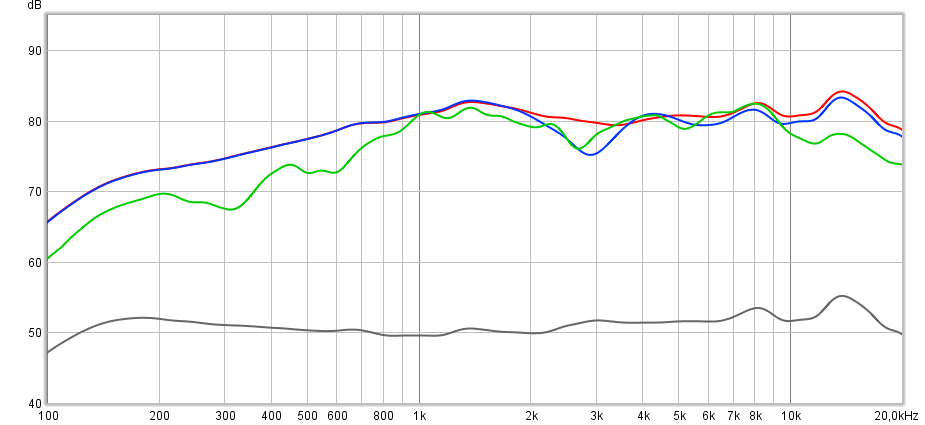

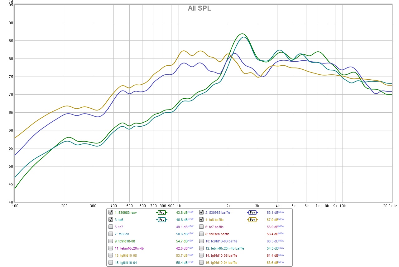

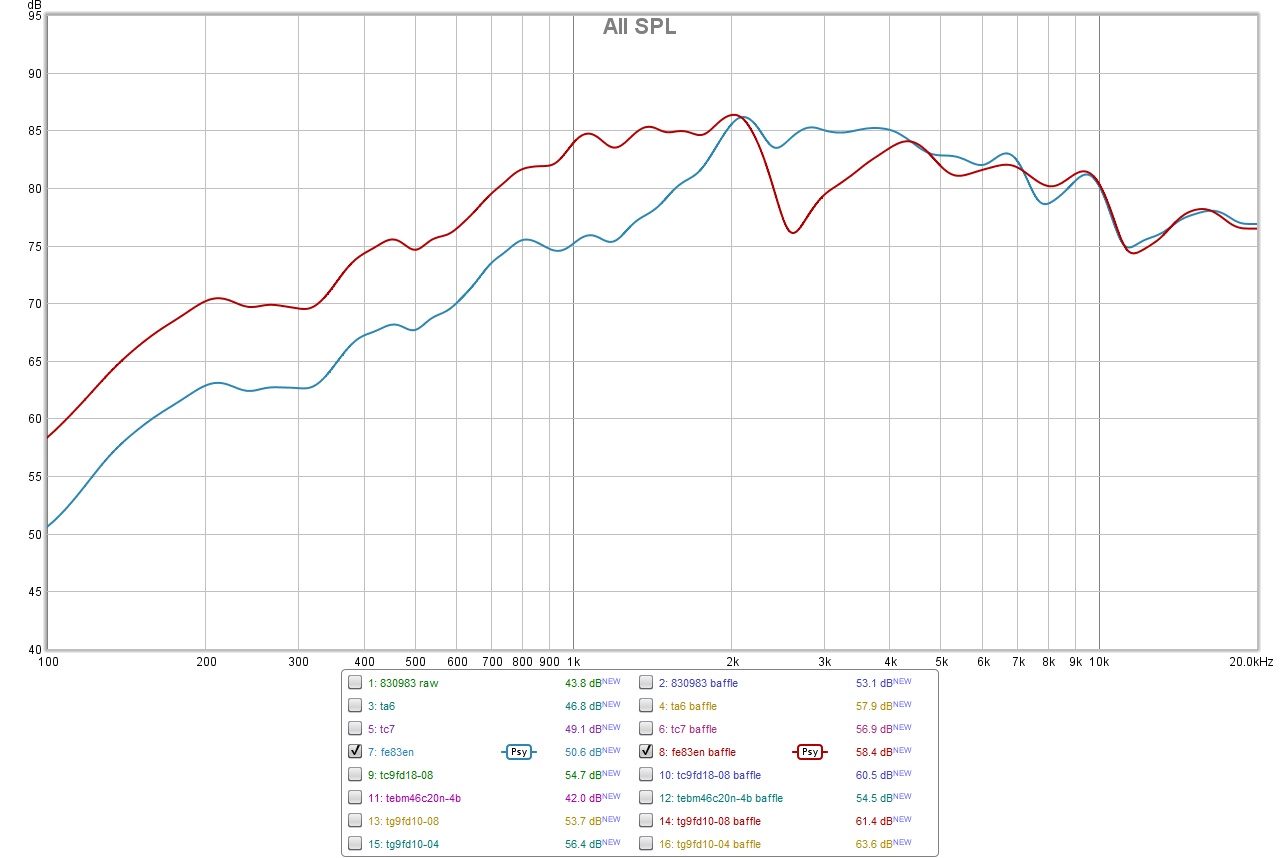

And here are some graphs
First my two new 2" drivers the 830983 and TA6FC00-04 both bare and with the 20cm disc baffle. These drivers have a natural peak at 2500hz so this seems to compensate with the baffle diffraction effect.
Next is the fostex FE83en. This has a quite flat response but that also means the round disk baffle creates a dramatic baffle diffraction dip effect

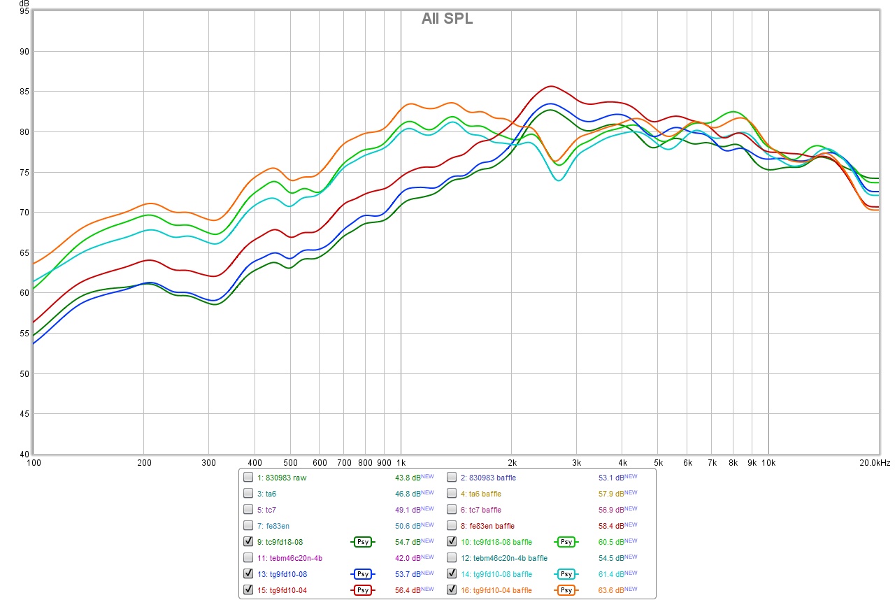

Next are the TC9FD18-08, TG9FD10-08 and TG9FD10-04. They have a small rise at 2500hz but it doesn't perfect compensate for the 2500hz baffle diffraction. So we get a noticeable dip at 2500hz.

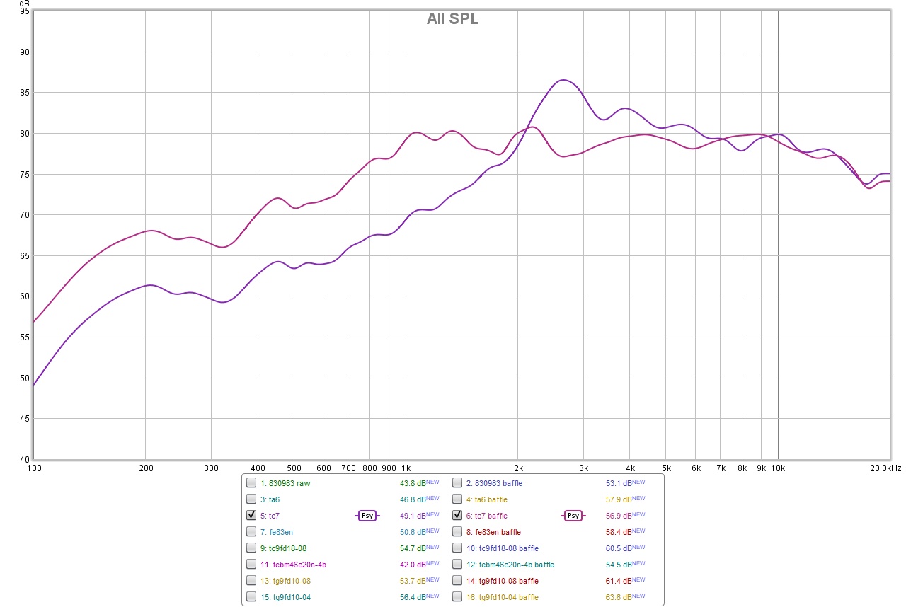

And last is a TC7FD00-04. Bare this has a dramatic rise and actually doesn't sound that good, but placed on this 20cm round baffle and it is an almost perfect synergy and sounds really good. I probably won't use this for the final speaker, but it really opened my eyes to the possibility of using baffle shape to tune a driver to sound better.
again my motivation here was to duplicate the Linkwitz experiment to help me get some data for designing a flower baffle. These are not final designs, just some experimental data points.
cheers jeshi

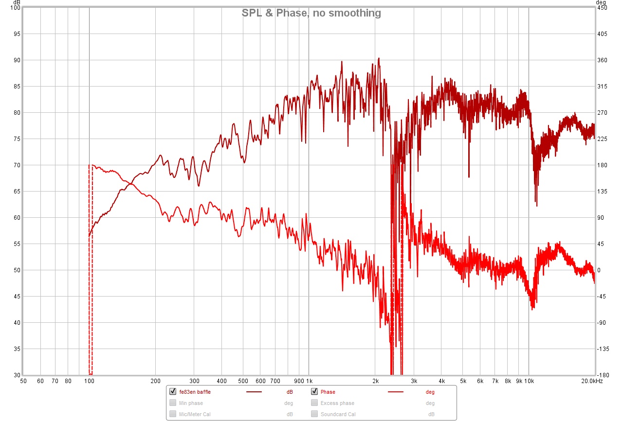

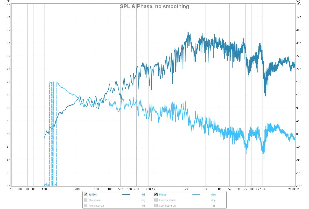

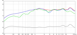

Here are two more graphs. This the the Fostex fe83en without any smoothing applied.
First is the bare driver which in this test setup actually gives a quite clean measurement
and then with the round 20cm baffle disk to create a single frequency dramatic baffle diffraction effect at around 2500hz
...I should have a rise at 1700 and dip at 3400hz, but my measurements give me a consistent 1250hz rise and 2500hz dip from my round disk baffle. It's consistent so for now I will just accept it, but it would be good to figure out what is different or wrong with the calculation...
With static on axis position of microphone looks reason is the dynamic distance that change numbers, below models is examples of 0,1/0,2/0,4/0,8/1,6/3,2 meter distances.
thanks byrtt. I measured at 0.3meter distance on axis so that looks right. I've never used Edge, I used a different tool before. I will have a look at Edge again. But I also like doing empirical testing since it makes it more real for me.

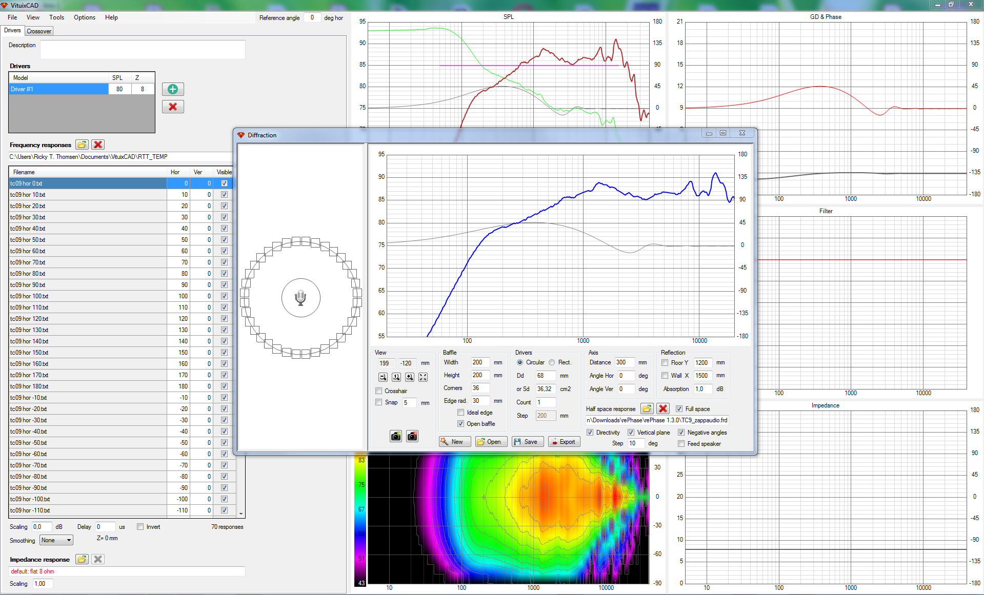

Sorry i had one fault into that Edge model in i forgot tick on OB : )
In general imagine one thing that is important from ground up for defraction is to have a unit with as less as possible defraction from start on because at various other distances and angles to spot in space be it our ears or be it room reflections will force new dynamic frq responses to sum up and using EQ reverse corection will only work in one spot in space, so therefor think Mattes is on track using roundovers whereever he can get away with it.
In spirit of model roundovers we can not use Edge so i tryed fire up free VituixCAD program which is new tool to me but have so much practical power and tools for speaker building. In below visual i traced your TC9 (green trace) sitting on the 200mm disc and used ZAPH audio graph (black trace) for TC9 response as reference for model, with microphone distance at 0,3m (thanks post that number) VituixCAD then output the blue trace and its not far from yours, the interesting smoother curve relative to green and blue is the red trace where round over is set to 30mm.
Second attachment below is sceendump from VituixCAD because heck it is interesting powerfull tool in it even could create vertical and horizontal directivity curves based on piston size from that diffraction tool process : ) also if we follow kimmsto guide into this post 679 (LINK: https://www.diyaudio.com/forums/software-tools/307910-vituixcad-68.html#post5584200) it can translate to IR file from simple txt/frd curves.

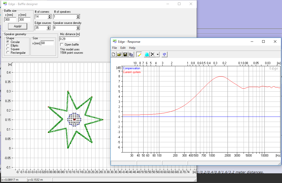

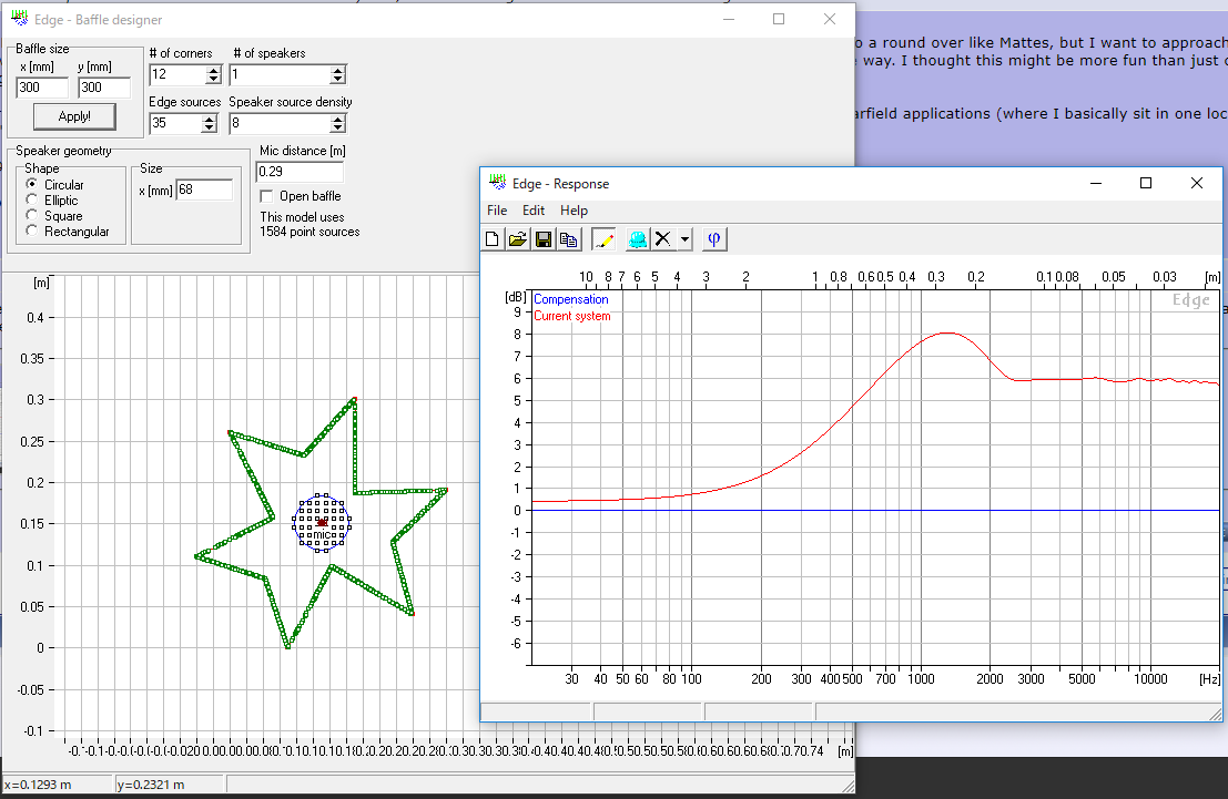

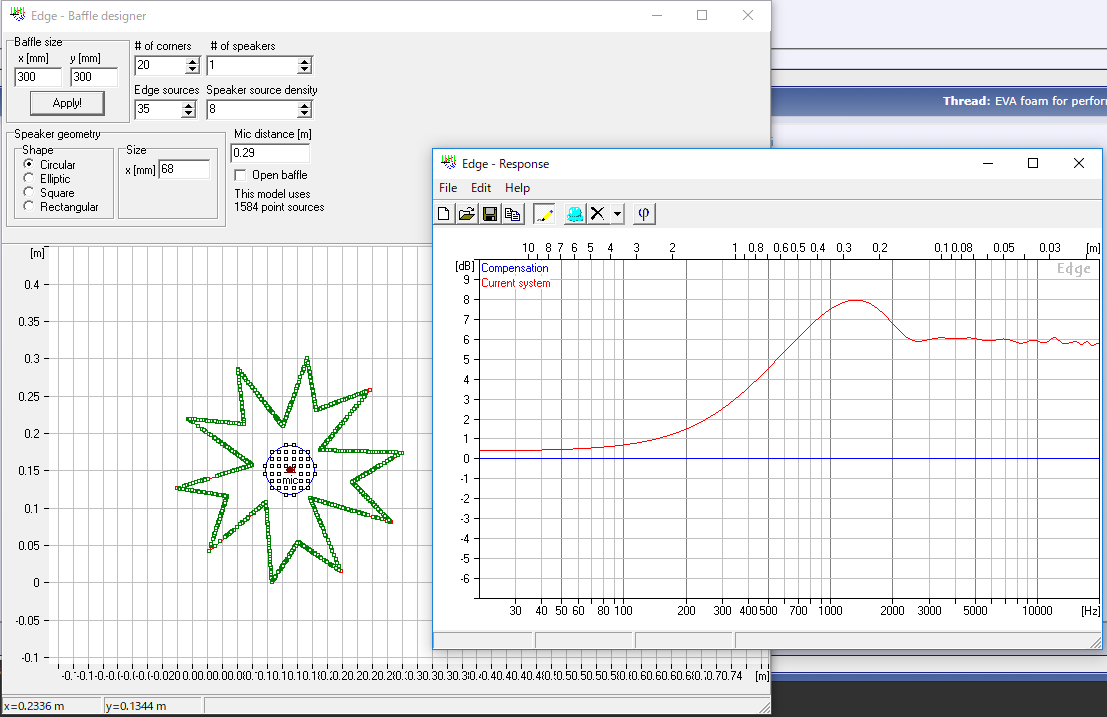

I was playing with Edge and tried a 7pointed star and modified 5/10point and 3/6point stars and they all worked out very nice. It still has the bump up but there is minimal ringing or dip down. Outer diameter is 300mm and inner diameter is maybe around 150mm but I modified the points by hand so I don't really know. I might try something like this next in my experiments.

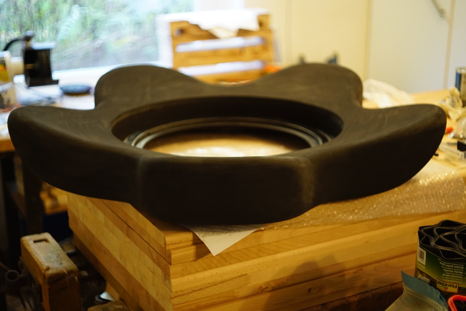

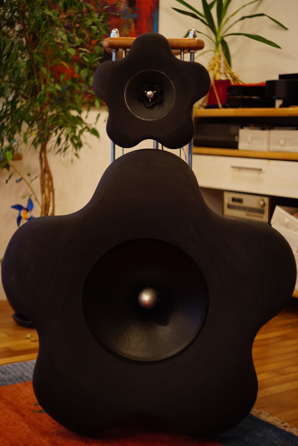

The flowers made it all a lot better again, in fact I was deeply surprised by the amount of improvements.

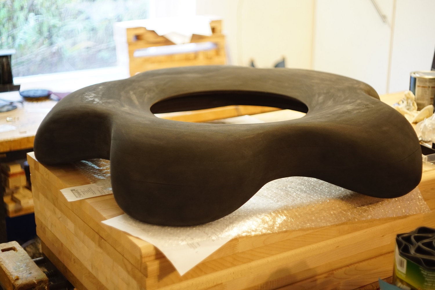

So, I worked really hard on the bass flowers (and therefore didn´t start any threads yet...) and mounted them yesterday... and then I couldn´t stop listening to music, as I was totally overwhelmed again by much unexpected improvements not only in the bass region, but in the whole bandwith, don´t know why (the DIPOLE 18 works up to 350 Hz and has a smooth B2 filter only). The finish is not perfect yet, but I had to listen to the flowers...
The initial inspiration came from the petal whizzer cone of my wideband units, all I do is copying/transferring the idea.
Jeshi, your stars will work fine for sure as well. As long as you have a decent amount of path variation and a decent roundover (some claim a minimum radius of 10% baffle width is needed), I do not think that you´ll need to hit a specific point. But, maybe I´ll get corrected by your experiments...
Please find a teaser again attached. I believe that the relative thick and non-resonant EVA-baffles contribute to the results primarly, and I have to thank Jeshi again for pointing me in this direction.
However, the building of the bass flowers was a lot of work, the final finish has yet to be done, but I´m realy glad all turned out this way for now, as I have invested considerable amounts of time, work (just calculated yesterday for fun: the routing alone was app. 800 metres...) and money.

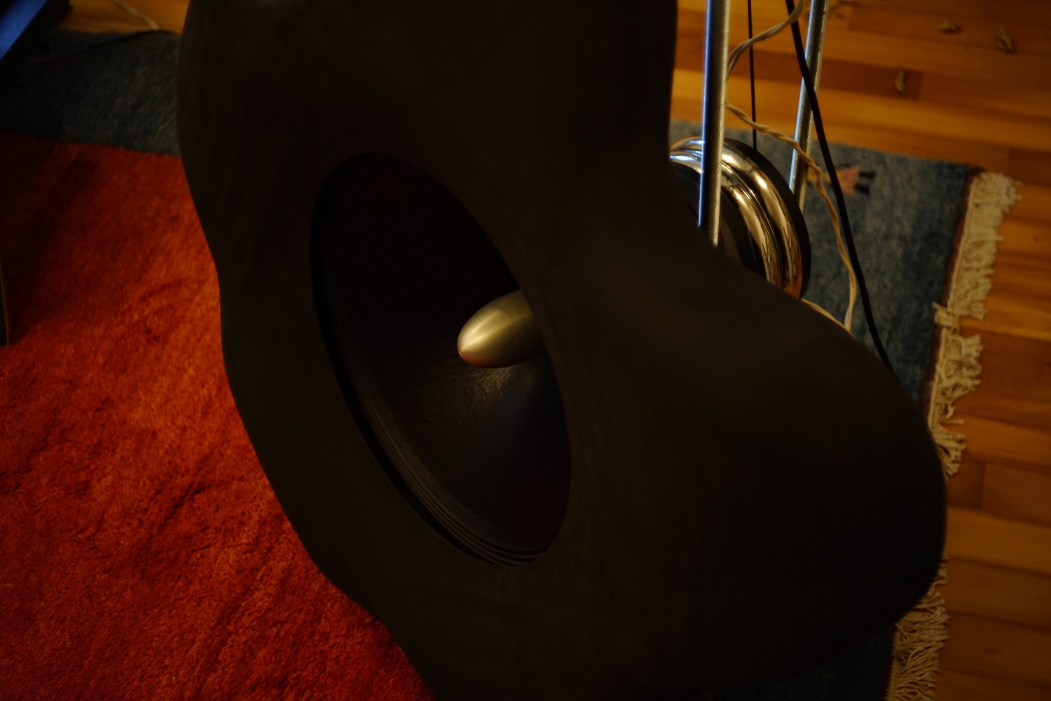

I think Perceval wanted to see my bass solution, so here it is: Acoustic Elegance Dipole 18, double 8-Ohm coil, in a flower baffle of max. 930 mm diametre, 160 mm depth, isolated from driver with sorbothane, free swinging, passive filter.
