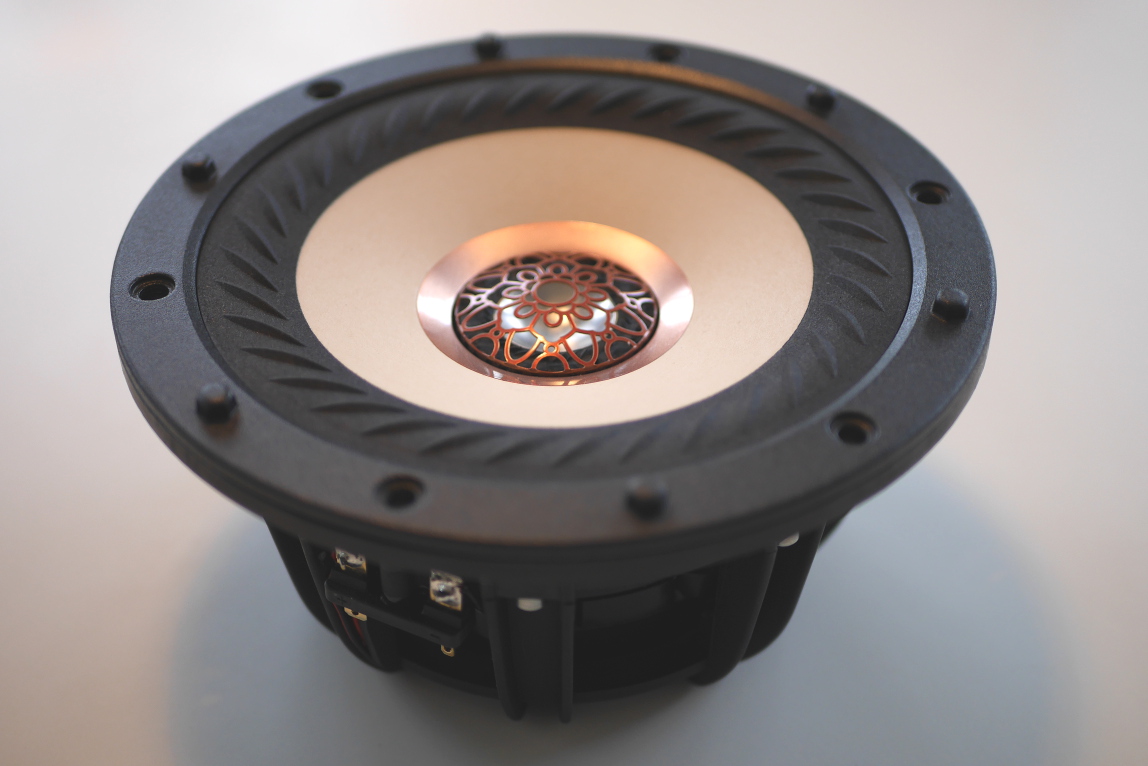

New 6.5 and 8" coax drivers from TB.
Some are getting their hands on them right now... hoping to see some measurements soon.
TB new line of Coax FR drivers
Hi Perceval,
nice drivers, for sure. Someone has clearly been thinking about diffration from rings, steps, suspension etc., but has somehow given up at the basket, if I look at the false screw heads or whatever that is. Otherwise the attempt to have no mechanical problems on the path from tweeter to baffle seems logical. KEF does it in a quite similar way.

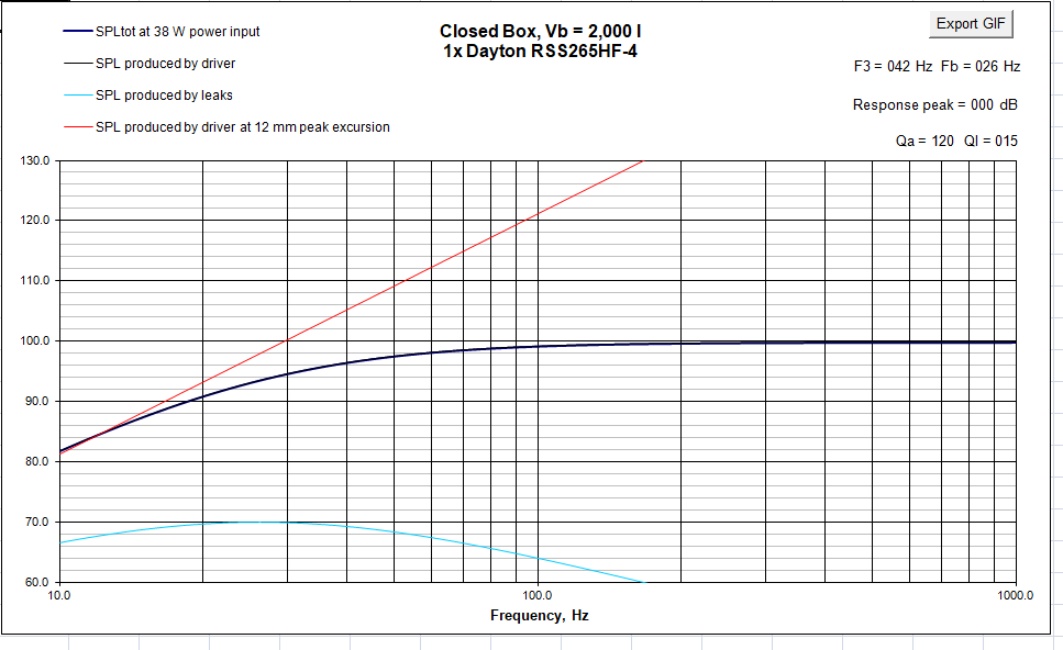

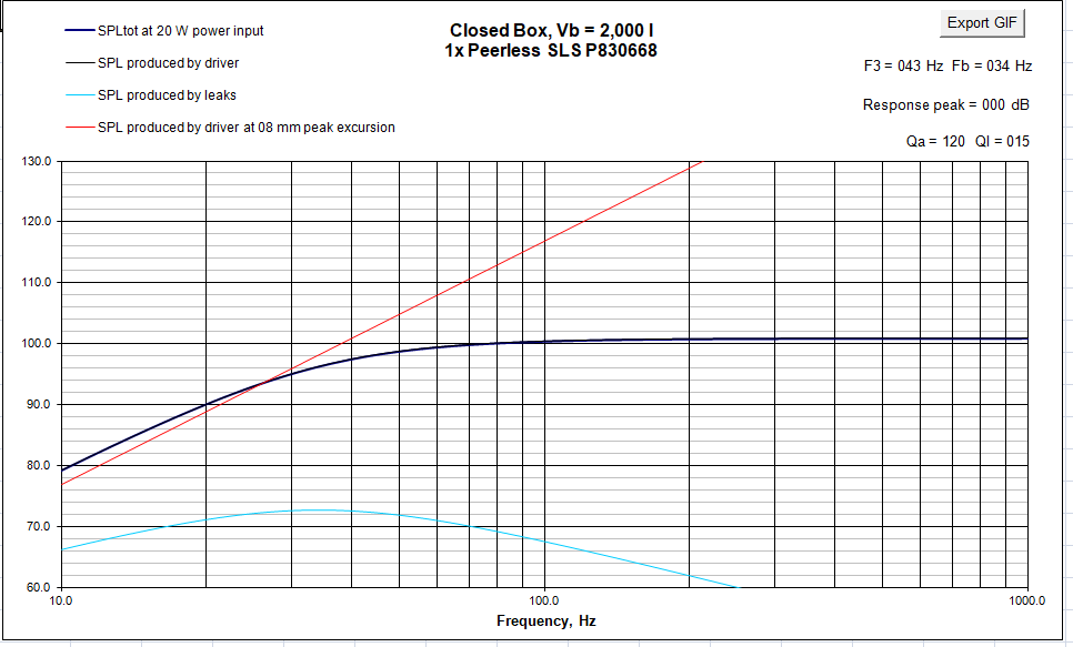

Hi Jeshi,
I have attached some screenshots of OB simulations with an old AJ-Horn program (sadly, I´m not so savvy with all that software, but this old program has proved to be quite realistic on several occasions), with the RSS 265, the SLS 10, the Dipole 10 and finally, my Dipole 18 in a larger baffle, just as my flowers, to put things into perspective.
In no way this is intended to disencourage your use of the Dayton, or is intended as offense... I was interested myself in finding out how the Dayton compares to others.
Obviously, it was not intended for OB use... but for small subwoofers, as visible by the high MMS. The 2 other 10-inch candidates have only half the moving mass...
So, sorry for posting this, but of course these are only simulations...
All the best

Hi Mattes,
Thanks for the simulations and no offense was made so no need to be sorry. I guess I am approaching my OB differently than yours. I am following the Linkwitz and gainphile approach where they will use a DSP to correct for bass loss rather than relying on a passive cross-over and the inherent parameters of the driver (mms, qts...). So for a DSP approach (like Linkwitz and gainphile) the important parameters are low distortion and large xmax to give room for bass correction without creating distortion.

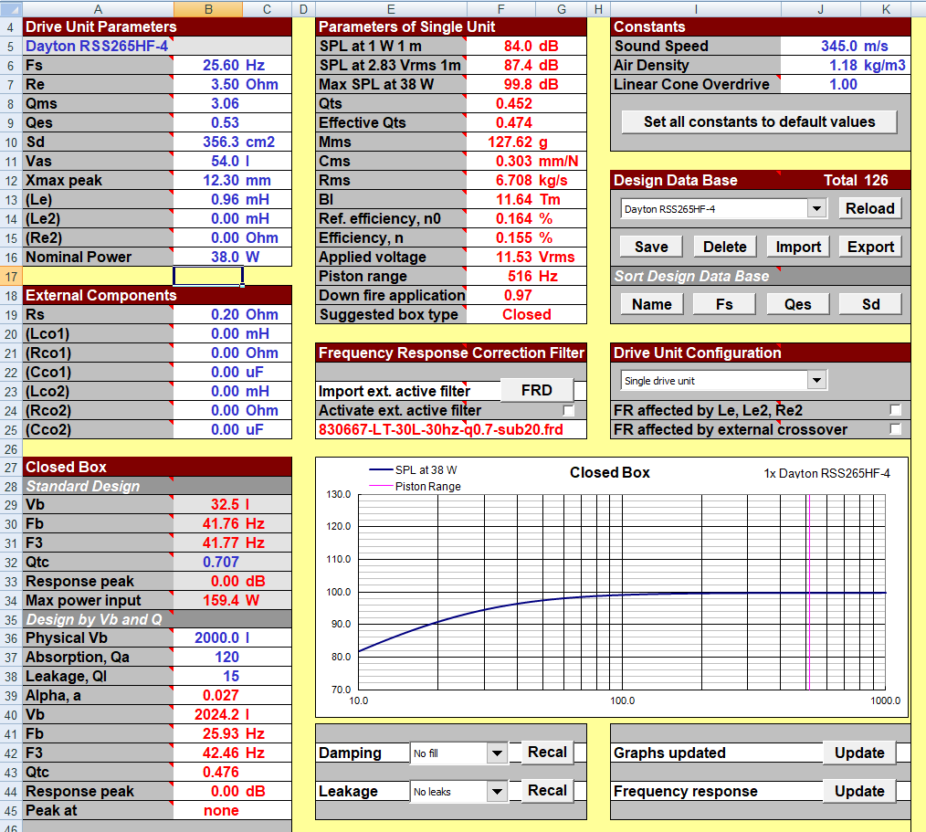

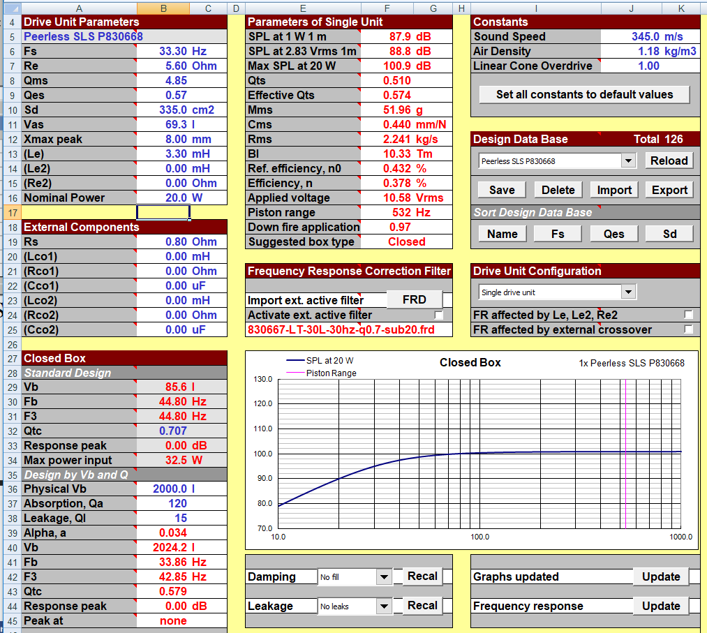

Here are some simulations I did on the RSS265HF-4 and P830668. I am not trying to simulate baffle effects, just the driver properties. I use unibox and set a sealed box to 2000 liters. This should approximate the rear air volume of an open baffle in a room. I read about this trick a couple years ago, but I can't remember who told me it. I've done the same with 10,000L and 64,000L boxes (2m x 4m x 8m room) and unibox gives the same numbers as 2000L. Without DSP correction the RSS265HF and 830668 both give similar responses with an F3 of 42-43hz. But the RSS265HF-04 has much more xmax to allow for bass boosting via DSP correction. I've also include my actual measurement of my RSS265HF-04 in a baffle-less, no DSP, open-baffle configuration (bare driver) and it is not far off from the simulation with an F3 (3db down) around the 42-45hz point. And the distortion measurement is very well behaved.
With a linkwitz correction I should be able to recover the lost bass on the RSS265 and get 100db of flat response down to 30hz and an F3 of 25hz with still 100db of output. For my applications (nearfield monitor) I only need about 88-92db before my ears hurt, and for my room I will be happy with 40hz so I am well within the specification I am targeting and this should give me lots of headroom to keep very low distortion. The only thing bad about the RSS265HF compared to the 830668 is that it needs more power to get to 100db, but 5watts will give me 91db which should be about right for me.
Linkwitz had previously recommended the 830668 for his open baffle speakers but then switched to the SEAS L26RO4Y which has lower distortion and greater xmax. Gainphile followed after Linkwitz and searched for a cheaper solution and found the RSS265HF. I am certain the Acoustic Excellence drivers are excellent, but I honestly did not hear about them until you told me and they are 3-4x more expensive than the RSS265HF when I factor in shipping. My main nearfield monitor speakers are a 2way Satori MW16P with tweeter and the RSS265HF + fullrange is just an experiment. My previous experiments with fullrange drivers didn't convince me that I preferred it for my nearfield application (I preferred the Satori + tweeter 2way with perfect time alignment and phase crossover).
So I absolutely agree that your simulations and approach favor the low moving mass, but I think for my application the RSS265HF will give me extremely low distortion within the DB and LF extension I am targeting. I honestly don't think that either approach is better or worse than the other. Some people don't want a DSP and want Caps and Coils crossovers others are very happy with DSPs (when done properly).
cheers
Jeshi

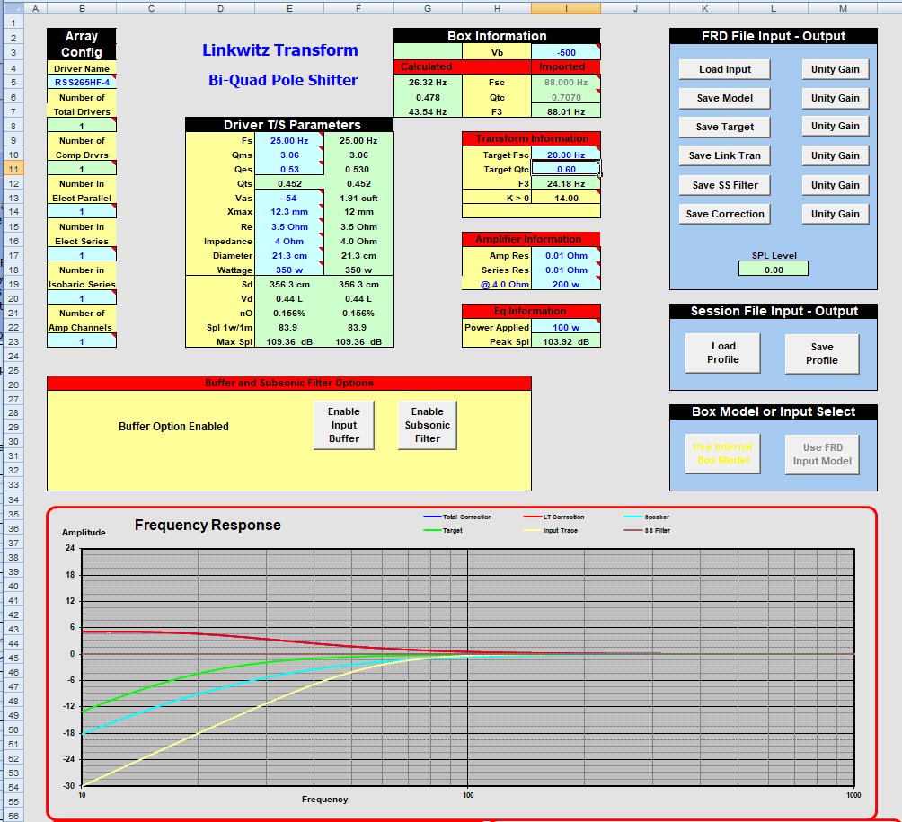

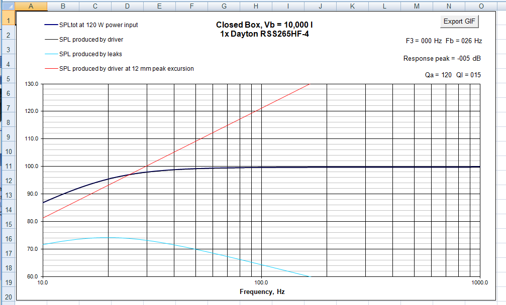

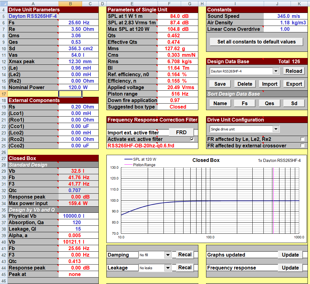

follow up on my post #410. I did some quick linkwitz correction sims for the RSS265HF-4 OB. Decided a 20hz Q0.6 target (F3 24hz) might be a reasonable target since it only performs about a 5db lift. Here is the Linkwitz-transform bi-quad spreadsheet and then applying this correction in unibox. Even at 100db output it would get to 25hz before exceeding xmax and starting to induce distortion. I would never push that far, and with my typical 92db output I would be well below the xmax and probably keep the very low distortion that I measured even with the linkwitz correction bass lift added in.
Unfortunately things are getting busy for me (work, oboe concert coming up, Christmas season) so I'm not sure how much I will be able to devote to my speaker building, but I will let everyone know when I make some progress.
cheers
jeshi
